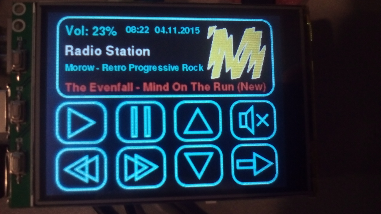

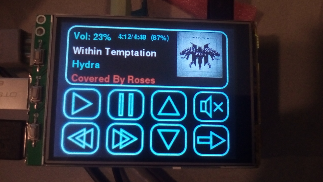

Mine version of the small screen moOde client is coming along nicely.
Here are some screenshots:
Playing radio:
attachment.php
Playing a flac from a USB stick:
attachment.php

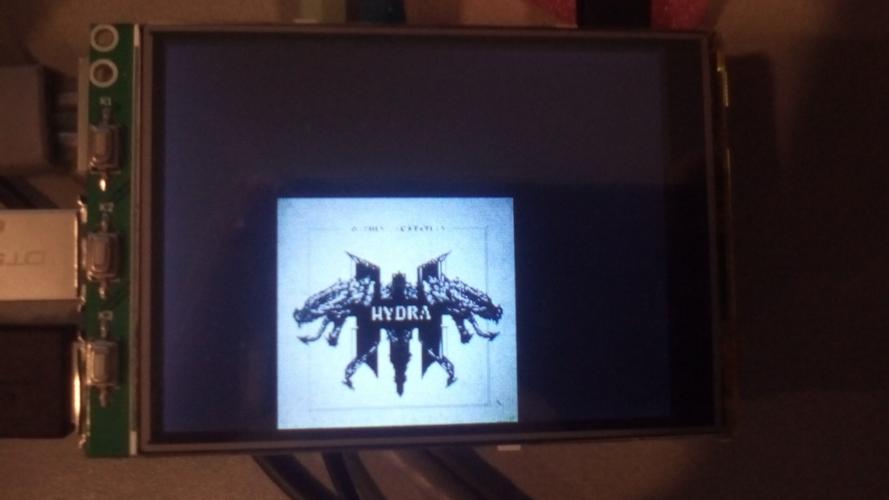

The screensaver shows the coverart image floating around the screen:
attachment.php
The coverart image looks not that great due to the low resolution of the screen ofcourse. But i am quite happy with the result so far. Todo: selecting playlists and making somekind of splashscreen to show during startup.
Freijnen it looks great.
I am keen on trying your solution for manual control. Whilst I can see the benefits of a 7" screen it would be too large where I have mine set up. All I need is a small control panel.
Is it easy to switch between audio files and webradio?
Adafruit has a 320x240 capacitive (rather than resistive) touch screen. Do you anticipate any problems getting your script working on that screen?

Morias. Thanks!
At the moment i can go forward and backward in the playlist. Doesn't matter if that are audio files or webradio station or a mix of those.
I am planning to make something to select what playlist to play from the touchscreen.
Making the playlists will have to be done on the webinterface as usual.
If you can get that adafruit display so show a console interface using a moOdeaudio 2.4 distribution by installing the right drivers and so on, than running this interface should be no problem. Just install xserver and pygame onto your system and run this script.
