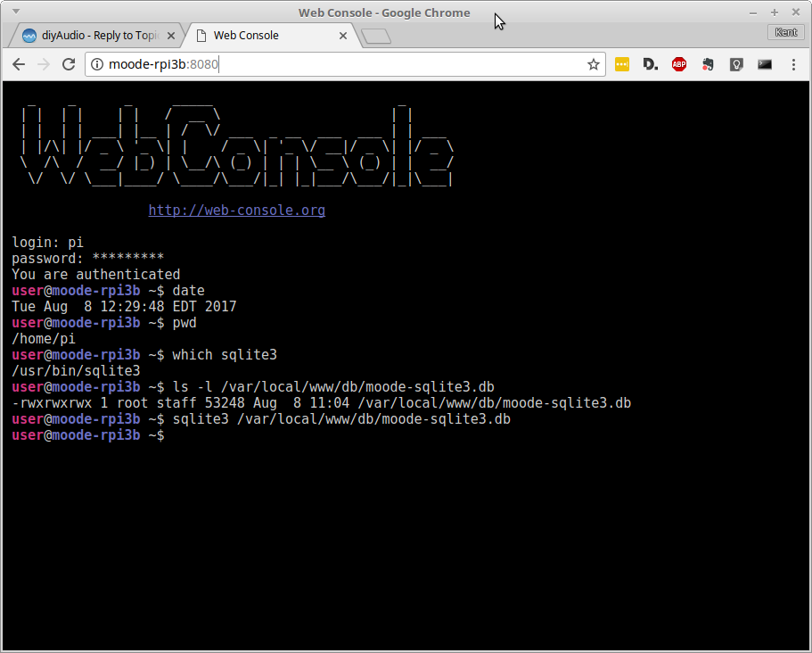

@Zootalaws
Hi, Mike. This is very cool.
I couldn't wait to see your response to Tim and tried on my own. Stuck a configured copy of webconsole.php in /var/local/www/webconsole/ and hacked a new stanza in nginx.conf to create a server listening to port 8080 with webconsole.php as the index.
Attached is a screenshot of the result.
The good news is, dilettante though I am, I got it running. The bad news is, dilettante that I am, I can't seem to execute non-shell commands. Case in point is the attempt to start sqlite3 shown in the attached screenshot. It immediately returns to the command line as do invocations of other programs.
I'm sure someone with better php/nginx/fpm-fu than I possess can quickly get it all running.
One feature in the code I don't like is the storage of user credentials in cleartext in the webconsole.php file. Seems to me there must be a way to pass logins on to the underlying Debian authentication scheme. That's something I want to pass back to the author.

So I said
@Zootalaws
Then again, maybe I got it right the first time. I just read through the FAQs and found a response to a user asking about non-shell commands in Web Console:
How to run vi / vim or ping — commands that waiting for some input or executes something infinitely using Web Console?
When Web Console executes command on the web server side, it is waiting for command result (output) and sends that result back to you. So, if your command is waiting for some input (like vi / vim) or executes something infinitely (like ping) you can't directly send input (or CTRL-C) to that kind of commands using Web Console. As alternative, you can use sed text editor (see sed website) or tools like Expect that will pass required input to that kind of commands.
I'm not sure I fully understand the author's description of the problem, but the solution he offers is not good news. Expect is a great tool (full disclosure: I used to work in the same institute as its author, Don Libes) but one would have to put in a fair bit of work to develop the Expect scripts needed to glue web-console to sqlite3, say, not to mention that Expect is a tcl/tk program.
