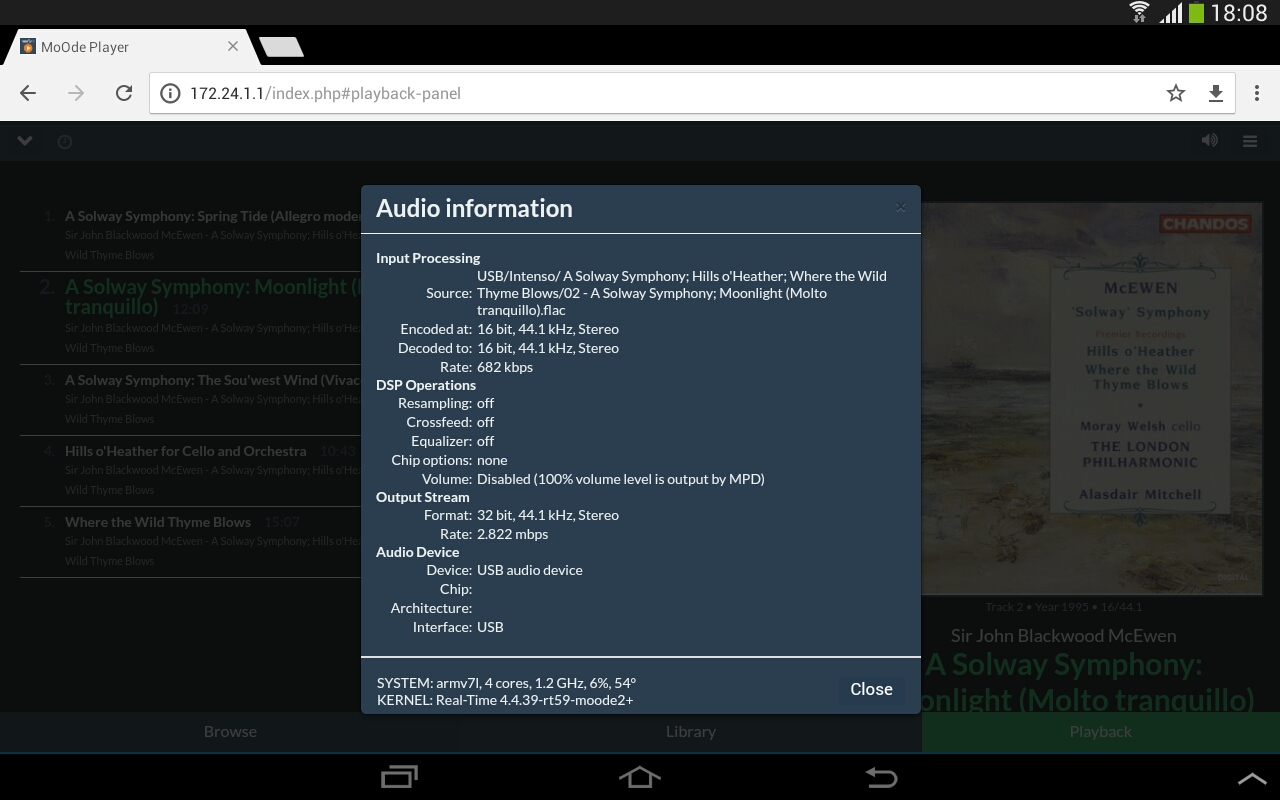

Good morning,
I have a raspberry pi3 with moode 3.6.
I use a Nad d1050 (cs4398 chip) usb dac.
The dac works very well and is recognized, but is not listed in a usb device list. I set a volume disabled (100% volume)
First problem: in a info page, the output stream is fixed a 32 bit even when play a 16/44,1 file.
Is curious because my Nad support max a 24 bit file.
Second problem: I use moode for play a flac with .cue file. If in a cue file (in FILE string) is present a non convenzional character (ex. ê, ü, ç) the file is not open.

Good morning,
Some MPD codecs output only 32 bit. Your DAC must truncate 32 to 24 bits. What audio format is the file?
The next release of Moode will include a new MPD build that only uses ffmpeg codecs.
You could post your CUE issue on MPD Github.
https://github.com/MusicPlayerDaemon/MPD/issues?q=is:open+is:issue
-Tim

Thanks Tim.
I have update Moode a v.3,7 but remain the 32 bit problem in output stream.
It can damage my Nad?
I apologize for my English, sorry.
