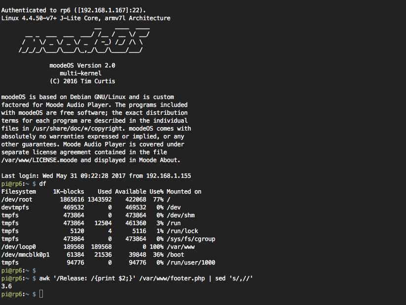

Fresh image starts at 77% full for root partition. Log files can can eat up space but takes a really long time. Periodically run Clear system logs in System config.

I kept archival copies of the files I downloaded via moodeaudio.org. Unzipping r35, r36, r37 and loopback-mounting their second partitions, I get the following
$ df -h /mnt/disk1 <--- root partition of r35
Filesystem Size Used Avail Use% Mounted on
/dev/loop1 1.8G 1.3G 413M 77% /mnt/disk1
$ df -h /mnt/disk2 <--- root partition of r36
/dev/loop0 1.8G 1.5G 192M 89% /mnt/disk2
$ df -h /mnt/disk3 <--- root partition of r37
/dev/loop3 1.8G 1.3G 414M 77% /mnt/disk3
Not sure where 200+MB disappeared in r36, but that explains to my satisfaction why I couldn't update fresh r36 installations. If I didn't first expand the root partition there's room to download update-r36.zip but not enough to unzip it.

Arggh. This is all on me. I had played with the r36 image file earlier on and didn't notice I was mounting an altered one instead of the freshly unzipped one. Everything is good. Sorry for the mixup.
Time to slink back into my cave.

Hi Kent,
Is your r36 zip original? It would have the following MD5 hash:
d7e2591ec29ec2e351e8a45d46e1aa8a
I just did a quick boot of an r36 image and df = 77%
-Tim
Could be stale Browser cache that causing Software update to report "up to date". The update will fail at 97% full root partition.

Hi @williamctell,
I just tested with the fresh 3.6 image referenced in my earlier reply to @TheOldPresbyope and no issues. An available update is displayed with Package date 2017-05-25.
-Tim
-Tim
