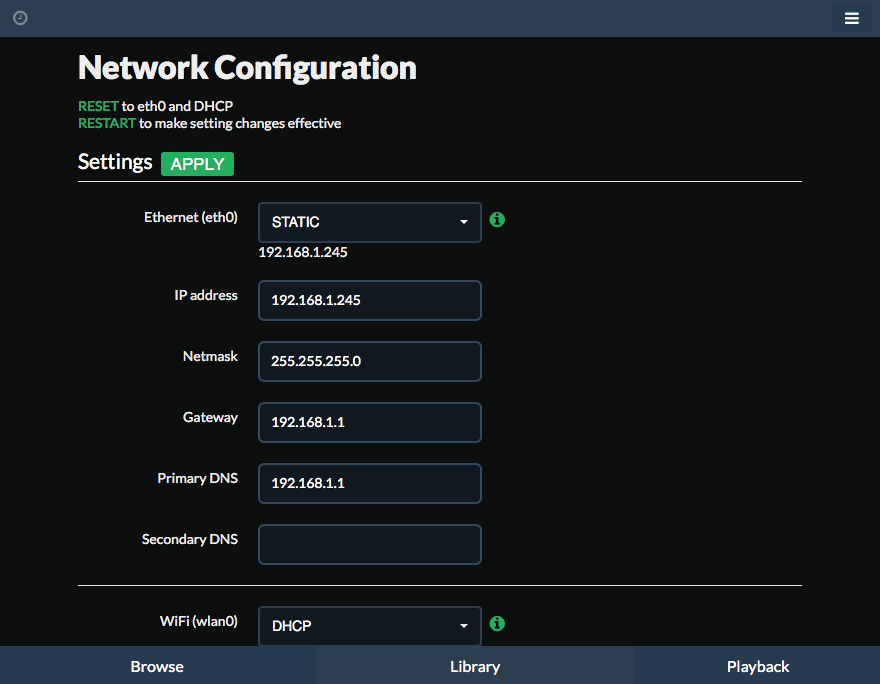

With version 3.5 it is not possible to switch off the AP mode.
I can not create my own Radioplaylists, they are not displayed.
If I change the network settings to Static, I can not access the configuration page with the browser via Lan.
All this worked in 3.1.

These bugs and a few other issues have been noted already and will be fixed in the imminent bugfix and bump to 3.6.

Hi Tim,
And when entering a static address the connection after the reboot fails? For me the main problem
Hi Tim,
I just ran a quick test and am not able to repro the issue. See attached scree shot.
-Tim
True, error occurs with me only when I at the same WIFI on static.
Post an exact list of steps that you followed and I'll try and reproduce the issue.
-Tim
