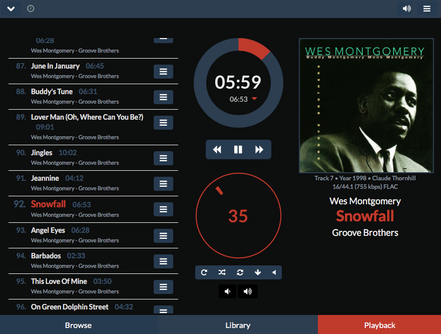

Looks good!Hi,
Here's a first crack at adding bitrate and audio format summary data under the Album art. Example:
16/44.1 (755 kbps) FLAC
-Tim
-Tim
I like it just fine, and I don't mean to be a party-pooper, but wouldn't it be cleaner looking to have a little button you can click/touch that brings up that info, rather than having it always there (and potentially cluttering up the look of things)?
Purely an aesthetic thing, and entirely a matter of taste. Just wanted to raise the question, see what people think.
Clutter vs clicks is an issue for sure. If there were a toggle button right on the Playback panel then its an extra click anytime you want to see the details.
Btw, the "Display extra metadata" setting on Customize turns it all on/off.
Still a WIP so lot of time to make changes 🙂
-Tim
