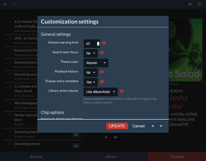

A new feature for selecting Artist or AlbumArtist tag to be used for the Library artists column 🙂
-Tim
