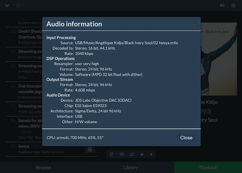

When I play a file to an USB device (nothing heavy 44.1k/16) and I browse a library which is mostly located on a NAS, every time I click an album, the system tries to get the artwork thumbnail. During that process, there is a short but very noticeable audio glitch, which lasts longer if the system cannot find any artwork for that album.
It doesn't matter if the file that is actually playing is from USB, SDCARD or NAS. The glitch is with a Raspberry B+ and with the Raspberry 2B.
As loading the library (going to the lib page) doesn't cause any glitch, possible the CPU priority of the thumbnail reading process was set a bit too high?
I use UAC2 device with USB audio fix present. Issue is both on XMOS and CM6631A devices.
Anything I can try to help isolate this?
Very odd. I don't think CPU is issue.
I ran some stress tests using old Pi-1B and did not get any audio glitches when clicking albums on the Library panel, even when the album art took a bit to display.
Tonight I rerun stress tests using Pi-2B just in case 🙂
Screen shot shows cpu at 65% utilization w/resampling enabled, no issues.
Test config:
Pi-1B 700 Mhz, 512MB Ram
USB DAC (JDS Labs ODAC)
USB attached HDD
18K tracks in mixed formats
With and without resampling enabled
16/44, 24/96 and radio stations
