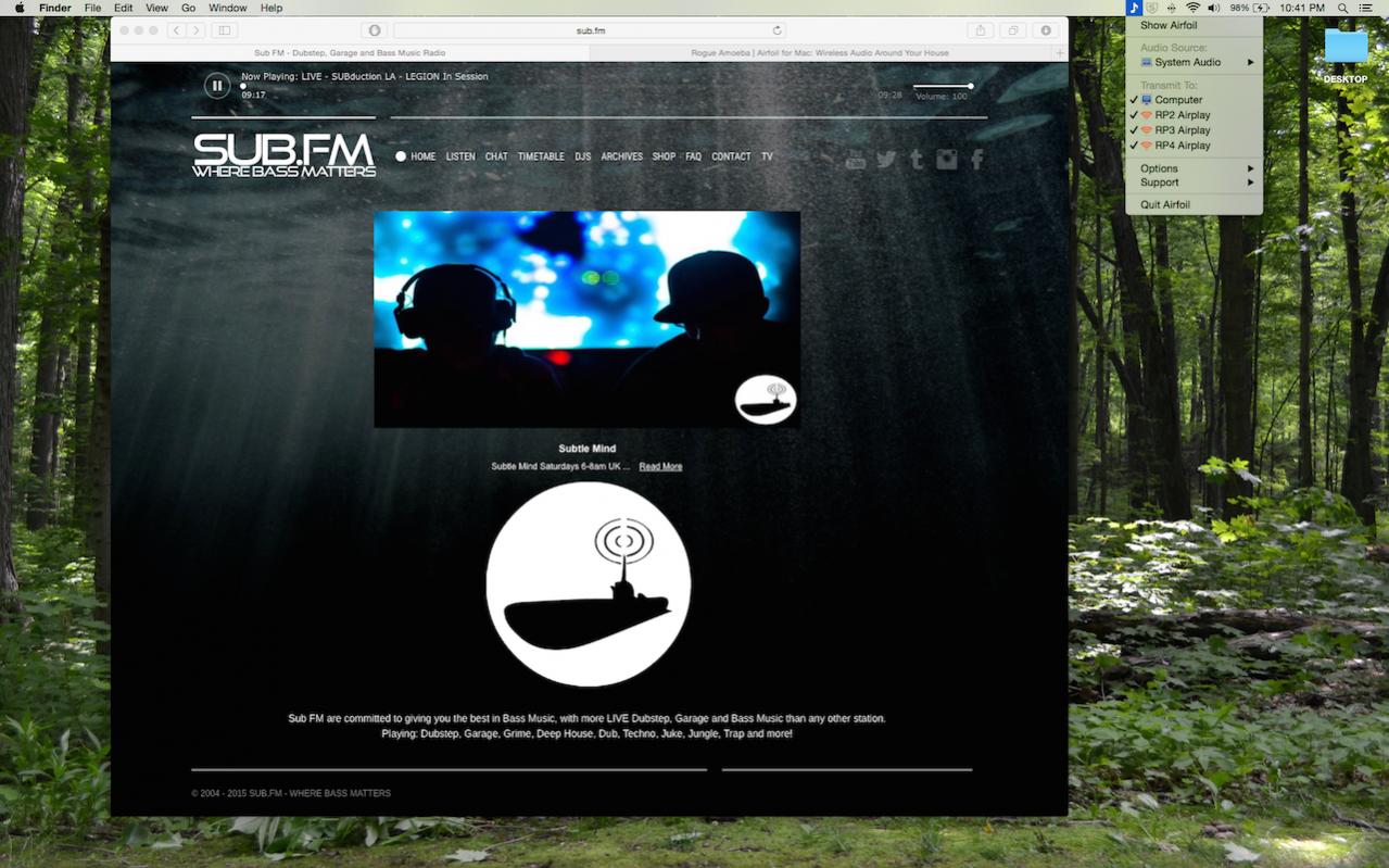

Airfoil + shairport-sync = SUB.FM throughout the house in perfect sync 🙂

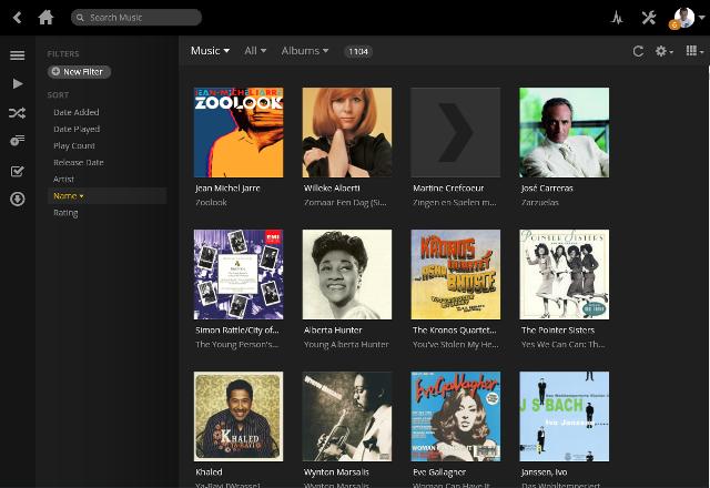

First I would lige to say thanks for a great software ! I'm using it on a RPi2 with a Digi+ to my Hegel H80 with digital RCA. The sound is great !
I just updatede from 2.1 to 2.3 and had looked very much forward to new funktion "Album art", which is one the things I am missing VERY much. Should it funktion when browsing albums ? I have a picture named folder.jpg in each of my folders (albums) with flac-files, and the same picture is embedded in each flach-file, but the only place I see the picture is in the player.
I would very much like something like Plex or others, where it's covers You browse thrue and not the small text-line as now (see attached file). Maybe abillity to shift ?
An other thing that would be great is the possibility just to play a number by pressing a buttom, instead of now, where it is always add and "something" else. I like zapping around in my music-collection without making a playlist 🙂
Thanks for reading

Hi Jorgen,
Thanks for the nice compliment! The Digi+ is a really nice board 🙂
Great suggestions and similar to other requests I've received regarding making use of covers in the UI and single click to play. All on my to-do list.
Tim Curtis
I'd suggest 600x600px or something with decent resolution so it will look good if displayed on a large panel.
I have a feature in the works that provides an album art view. The usage scenario is where a big tablet or locally attached display is placed on top of the speaker or somewhere in the front so the nice album art can be seen from the listening spot. It's the digital version of placing the LP jacket on a stand next to the TT. You analog guys know what i'm talking about 🙂
Tim
