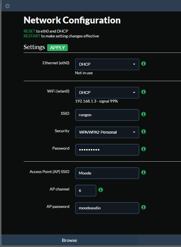

Post a screen shot of Network config showing both AP mode and WiFi (wlan0) with home network SSID active at the same time.

Here's a screenshot of the Configuration > Network page (attached). I'm sure I'm not understanding what's going on behind the UI.

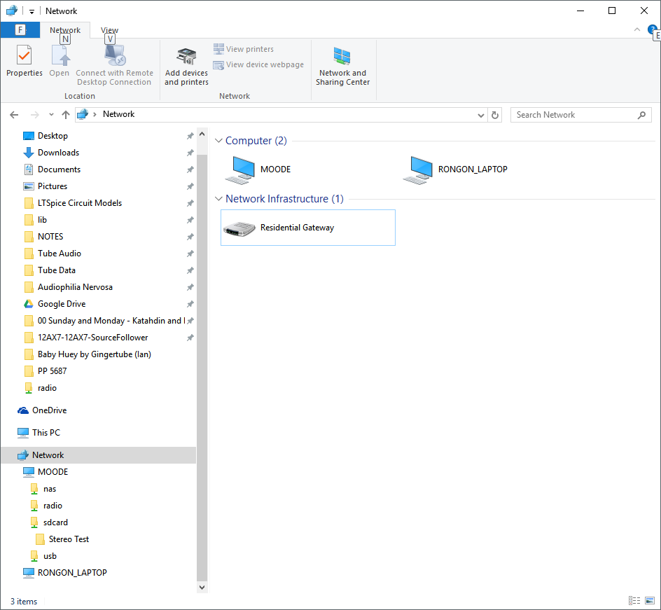

This is what it looks like in Windows > Network (attached)
I also have the Moode UI open in my Android phone's browser, at the same time as all the rest is happening.

Screen shot looks ok. Your home WiFi connection is active and AP mode is not active.
Access Point IP address is always 172.24.1.1 per Moode Setup guide. AP mode is only active if SSID under WiFi (wlan0) section is blank.
