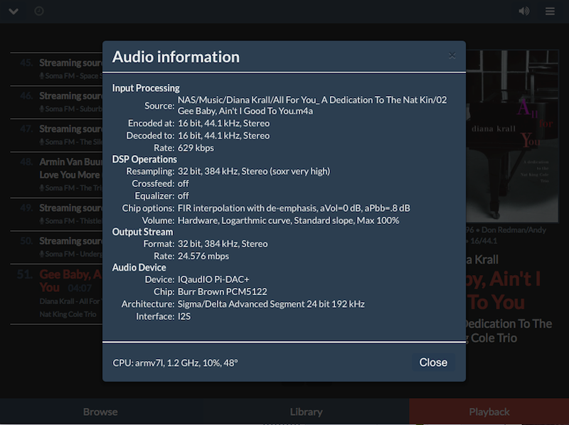

From that image I understand the EQ is disabled by default (first option). Maybe Tim can confirm.

Correct, the EQ and similarly Crossfeed are not in the audio pipeline when set to disabled. In this case MPD outputs directly to the audio device and as long as there is no other DSP occurring for example digital volume control, resampling, volume normalization, etc., the audio pipeline will be "bit-perfect".
The EQ I'm testing is alsaequal, a basic 10 band equalizer. I'm also investigating an alternative 16 band EQ from the swh-plugins package.
The Audio info screen shows the state of DSP components.
-Tim
