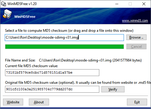

I dl'd WinMD5Free, and ran it.
For current file MD5 checksum value, I got
73181bf579ce8cbc71d578151d1a57be
The file I scanned was moode-sdimg-r31.img
-- or should I scan the zip file, not the unzipped img file?
I've attached a screenshot, since I don't know if I understand what I'm looking at.
I used Win32DiskImager to flash the SD card.
Thanks for the help so far.
UPDATE:
I dl'd the zip file of the Moode image. The MD5 checksum value checked out.
Then I unzipped the img file from the zip archive.
I then ran WinMD5 on the img file to see if it matched the one I got before. It did match. I think there was nothing wrong with the disk image.

You check the checksum against the zip file - if it checks out, you know the downloaded file is good.
