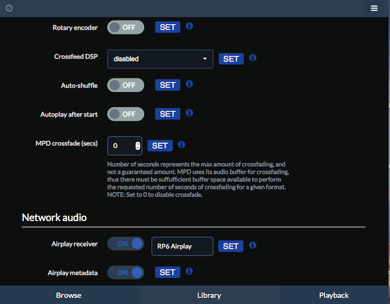

Working through a bit of my TODO list and was able to add MPD crossfader to Moode 3.0 🙂
-Tim
is this in between songs?, excellent if it is...

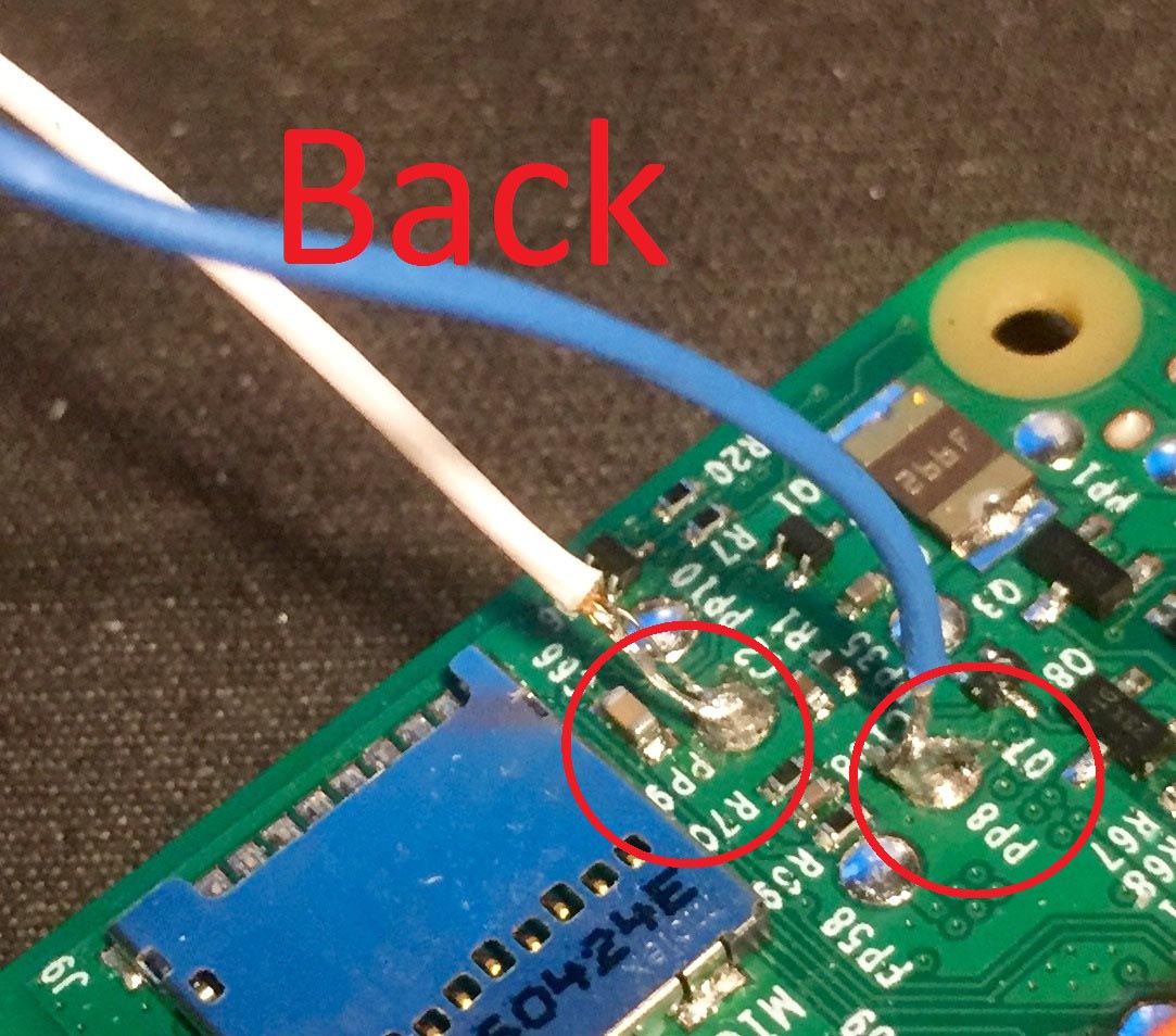

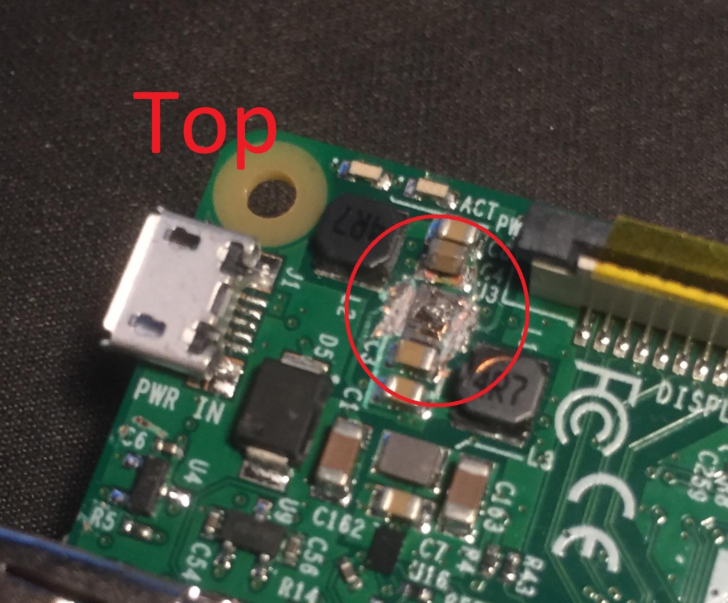

Hi
I have made some eksperiments with the power supply with great succes for audio quality. I have removed the onboard regulator (which made the 3.3v and 1.8V), and then power directly at PP8 and PP9 - the 5v goes to the GPIO. All three powersupply come from a DIY linear with LT1963 regulators.
I know a lot have powered directly to the GPIO with succes, but it really gives a lot more if you cut the onboard regulator.

Hi Aboe,
I made the same experience with Raspi2 and Hifiberry DAC+ pro: give each unit a single, clean linear psu and enjoy an remarkable increased sound quality.

Hi
Interesting.... so you need three powersupply, one at 1,8V, one at 3.3V and a 5V one.
I had found great improvement even with a 5V linear to the normal power microusb.
With your experiment is really better?
Absolutely, the improvement with 3 supplies gives a step up like the one you already have made. The problem is the cheap and noisy onboard regulators at rpi.
-Tim
Sorry hilarious typo spotted: Suffufficient?
Keep up the good work!
lol, I shall correct that!
-Tim
Hi guys, can we please get some more details about these ps mods? I know when I updated to a good quality linea power supply it made a bit difference to the sound quality so yes ps mods are the way to go.
