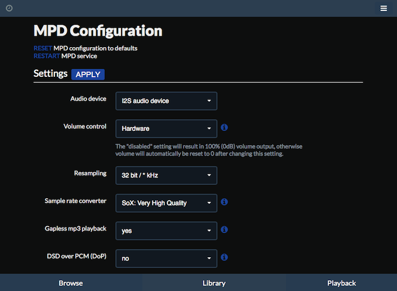

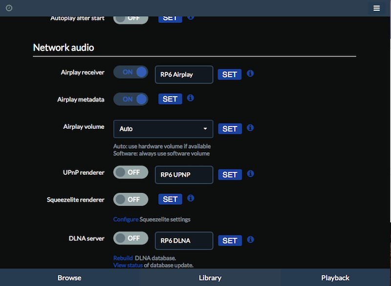

Some additional features included in Moode 3.0 🙂
1) Airplay receiver volume
- Auto: use hardware volume if available
- Software: always use software volume
2) MPD wildcard sample rates for SoX
- 16 bit * kHz
- 24 bit * kHz
- 32 bit * kHz
-Tim
