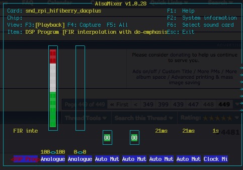

Hi Tim
Sorry for late response.
Yeah, I have PlainDac+
Anything else you want me to run?
Marek
amixer dump is here (alsamixer screen attached)

Hi Marek,
Thanks!
PCM512x chip options will be available for PlainDAC+ in first Moode 2.7 update.
-Tim
In Moode 2.7 image it should default to ON for Pi-3 and for other Pi's the setting will not appear.
Do u by any chance turn it off at some point?
-Tim
