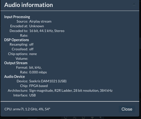

Hi
I got myself a raspberry pi3 to replace my old dying macbook as a music server. So I know pretty much nothing about all that stuff concerning RPi and Linux...
But I was able to install Moode and the software update feature and I have it playing music nicely from my usb drive. First impression is that it sounds very good with the soekris 1021 and the amanero usb interface.
The one thing I am not able to make work is the airplay feature.
All my devices (Iphone, Macbook) recognize moode airplay and when I play something from a device Moode changes its playback mode to airplay but there is no output to the amanero. I attached the audio information window and a log file
Thanks for help

Very odd that there is no output stream. I do see a bug in Audio info that prevents the mpd volume setting "disabled" from being displayed in the DSP section. This will be fixed in next update.
Below are some commands that can help troubleshoot. Please post output from steps 2-4 while sending an Airplay stream to Moode.
1) ssh pi@moode (pwd=raspberry)
2) pgrep -l shairport-sync
3) cat /proc/asound/card1/id
4) cat /proc/asound/card1/pcm0p/sub0/hw_params

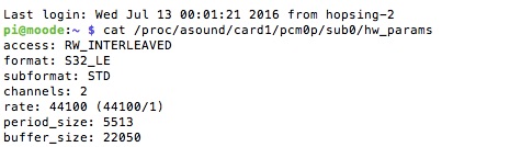

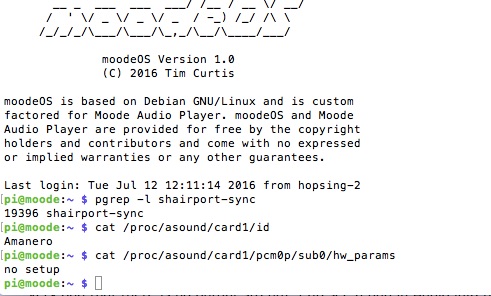

Hi Tim
First attachment is with airport running, second with an usb source...
Am I right to assume that the only thing I should do for a working airport connection is to move the airport connection slider and click set? Or did I miss something obvious?
Thanks for help

Interesting.
1) returns S32_LE when output stream is active. I've only seen S16_LE in my test environment.
2) returns "no setup" when there is no output stream. The code is only checking for "closed" which is what I see in my test environment with JDS Labs ODAC, my only USB DAC.
Adding "no setup" to the code will fix the display issue in Audio Info that causes nothing to be displayed in Output Stream section while Airplay stream is being received (your original screen shot). With this fix and the earlier fix that will show "disabled" for Volume in the DSP section, the Audio Info screen should correctly display an active Airplay stream being received.
The Airplay receiver (shairport-sync) receives volume level from the sending app for example iTunes, and then sets ALSA volume directly bypassing Moode/MPD volume.
Generally, the "no sound" condition when using Airplay is due to volume configuration on the Airplay sending app.

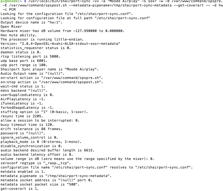

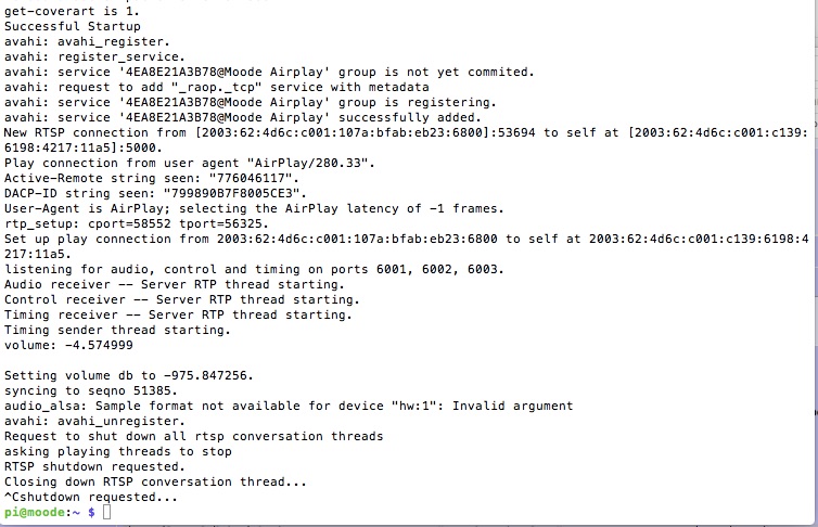

Thanks for help, that is very kind.
Here are the screenshots (screen was not big enough, so two jpegs) I could not change volume, because the shairport stopped reacting pretty soon after activating airplay on a client. I hope that logfile helps..
The log entry below indicates the audio format (32 bit 44.1 kHz based on earlier post of hw_params) is not supported by the Audio Device.
audio_alsa: Sample format not available for device "hw:1": Invalid argument
Very odd.
-Tim
Very odd.
-Tim
Well, The culprit is....? The Amanero? Because it forces the data format to be 32bit? Or shairport that cannot handle it? Or...? You see I have no clue.
