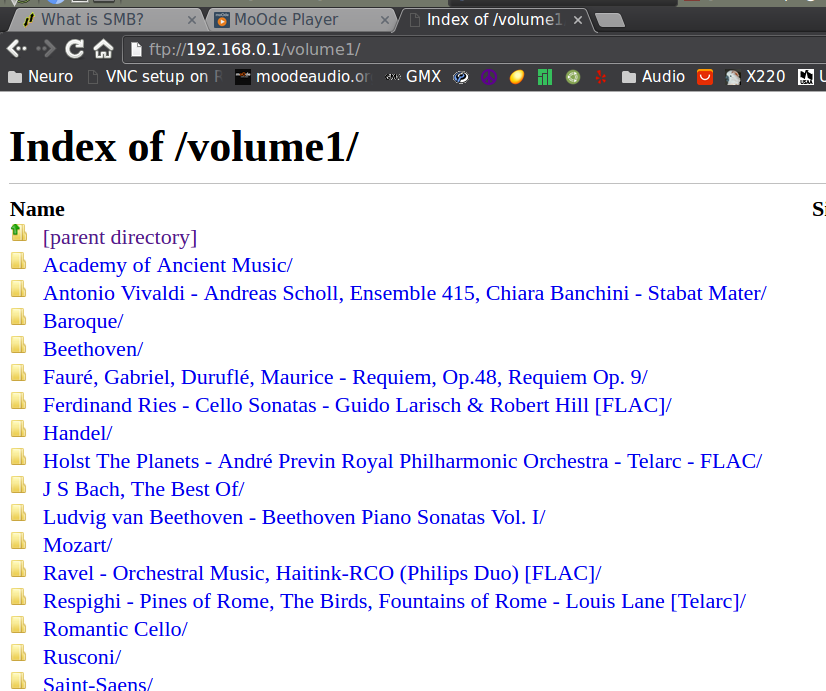

I am mounting my NAS using NFS, does that make a difference?
Yes it would be NAS.
On Moode NAS config screen, Remote directory should be set to volume1/folder_containing_music. NOTE no forward slash on "volume1".
-Tim
sorry but volume1 is likely not a folder, I can see the flac files by ftp:// on a browser, but can't seem to configure with NAS, does the attached picture give any clue?

I like to access my USB stick on my router (192.168.0.1) and am having some difficulty, the music is in /volume1 folder...
should it be considered a NAS attachment?
What do you mean "having some difficulty"?
I know Tim suggests in a later reply you possibly are running into a known bug at the networking level, but that diagnosis assumes you have successfully configured MPD for your NAS.
When you first configured your Moode Player to add a new NAS source, did you end up with an entry for it under List of configured NAS sources (on the Music Source Configuration page) with a green checkmark or a red X? If a red X, did you then click on the entry to edit so you could see the reported error message?
I can post example screen captures if you wish to see them.
