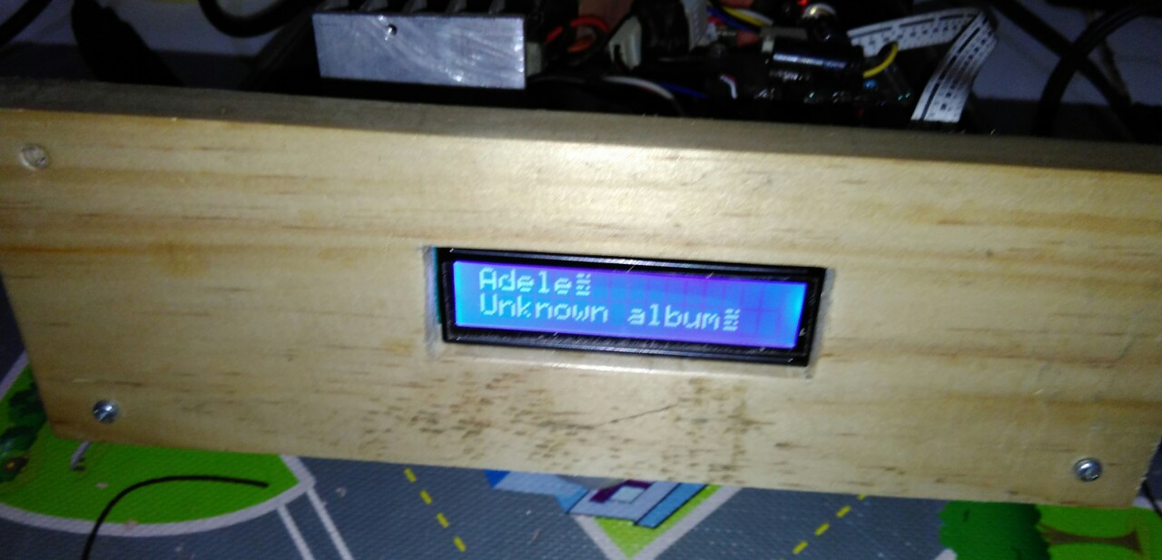

I use I2C 16x2 LCD and when use my lcd python script manually (run via shell), it run normally. Picture attached.
But when i add in lcd_up via Web and reboot moode, and after Moode finish loading, i cannot access Moode Web via browser. SSH work ok.
I have to kill lcd script, then i can access Moode Web.
Try commening out "while True" and "time.sleep()" in the script. The LCD updater engine in Moode will automatically detect when currentsong.txt changes and then run the specified Python script.
