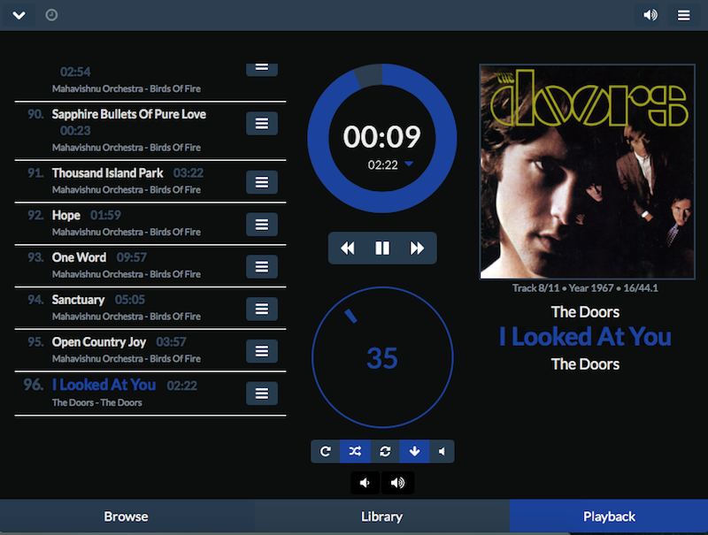

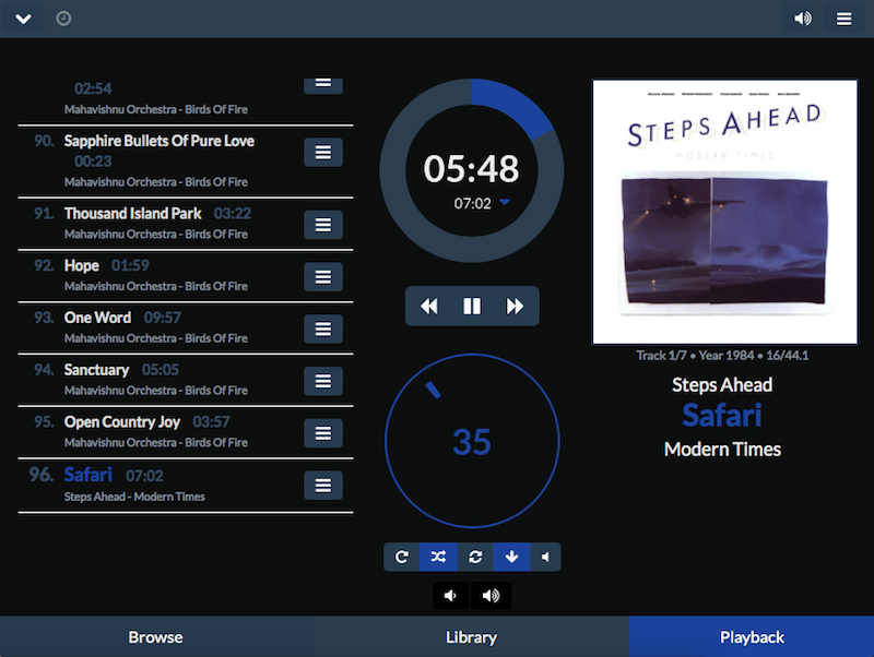

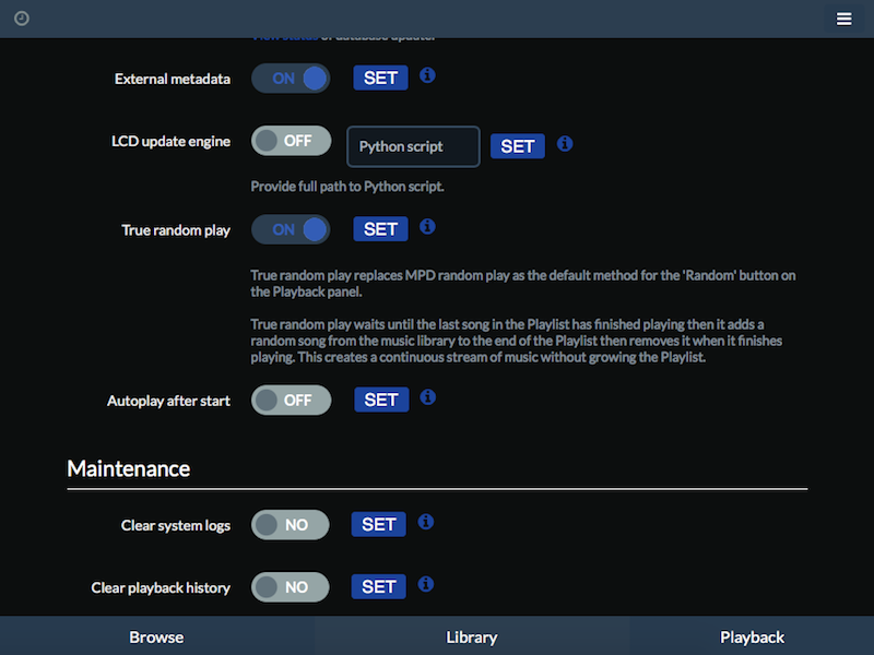

After a bit of coding and testing I think I have a pretty robust replacement for MPD random play which I've named "True random play" 🙂
It's actually a separate service (auto-shuffle) that hangs off MPD idle timeout and when event indicates "last track in playlist has finished playing" auto-shuffle selects a random track from music library, adds it to the end of the playlist and starts playback.
I've enhanced it so that whenever auto-shuffle is on, consume mode is also on. This results in the last track being removed by MPD before auto-shuffle adds a new track, thus a continuous stream of music is generated without growing the playlist 🙂
Screen shots show the service setting on System config plus a couple shots of Playback panel showing a few random tracks that were added staying at position 96.
Tim

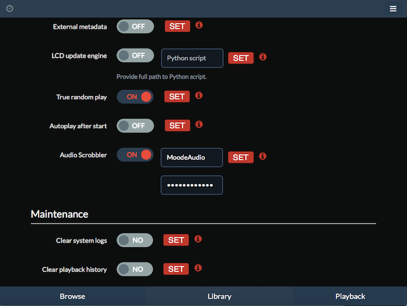

Just a brief update on completed content for TR3
- True random play (auto-shuffle)
- Replaygain setting added to MPD config
- Replace auto wlan0 with allow-hotplug wlan0 in auto-geerated /etc/network/interfaces
- Perform NAS mounts later in the startup sequence
- Fixed url for Resonance Radio
- Add WBJC Baltimore - Classical
- Add WCLV Cleveland - Classical
- Add WCRB Boston - Classical
- Add WFMT Chicago - Classical
- Add WQED Pittsburgh - Classical
- Add WRTI Philadelphia - Classical
- Add WRTI Philadelphia - Jazz
Remaining TODO for TR3:

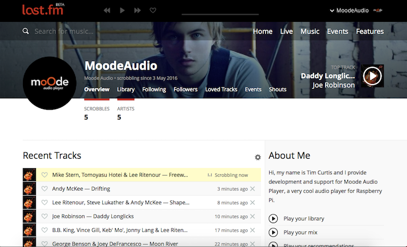

- add UI and components for MPD Audio Scrobbler (mpdas)
- bump MPD compile to 0.19.15 to see if in fact it supports decode of BBC 320K HLS streams.
Tim
