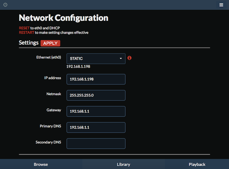

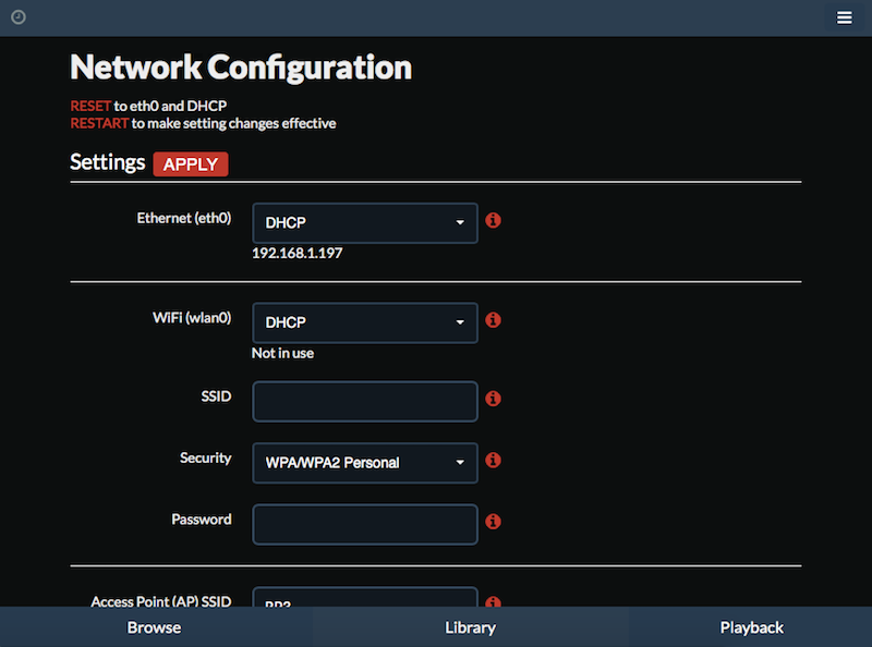

I am seeing this as well. Primary address does not appear to change.
Steve

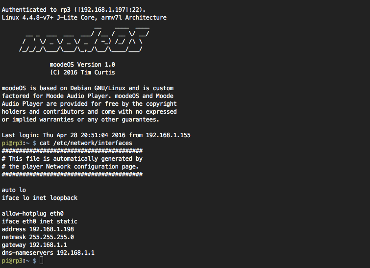

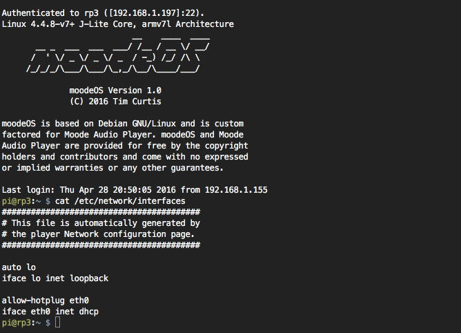

I'm not able to repro this after several tests on Pi2 and Pi3. I'm running 4.4.8 kernel but that shouldn't be a factor. See attached screen shots of DHCP vs Static.
Try the following:
1) System config, Clear system logs
2) Network config, enter static ip address fields, press APPLY
3) Examine /etc/network/interfaces to verify that it is correct
4) Reboot via Moode Menu, Restart, REBOOT
5) dmesg and look for eth0 errors
6) cat /var/log/syslog and look for eth0 errors
Send email to tim at moodeaudio dot org and I'll help troubleshoot 🙂
Tim
