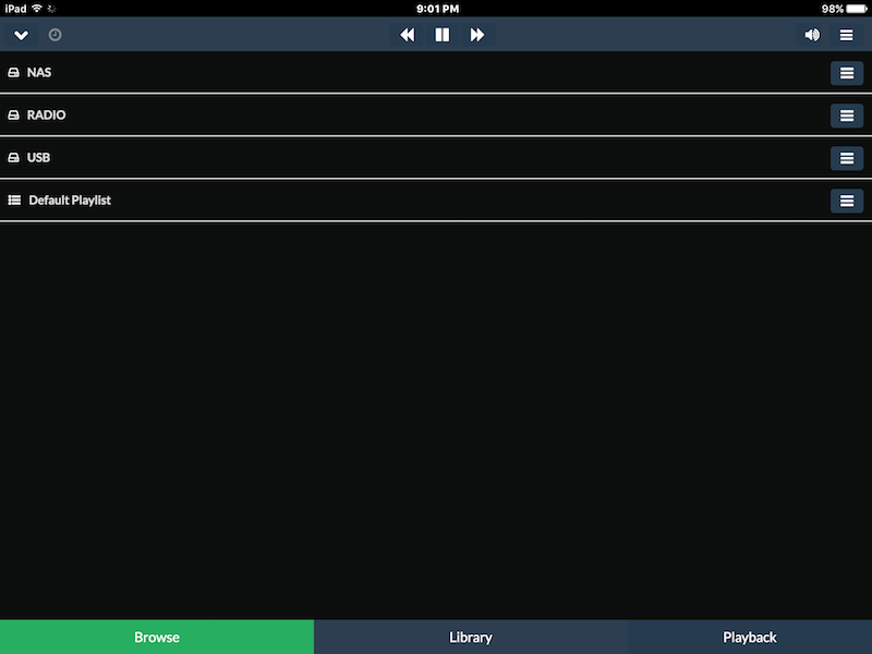

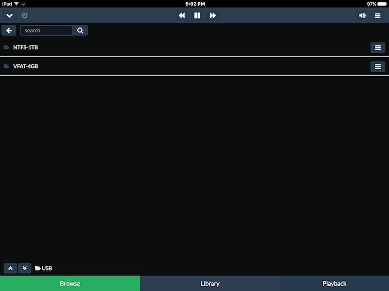

Testing a replacement auto-mount bin that mounts USB drives by disk label. Browse panel shows a single USB root folder that can be expanded showing the labeled USB disks. Simple and easy to navigate.
-Tim

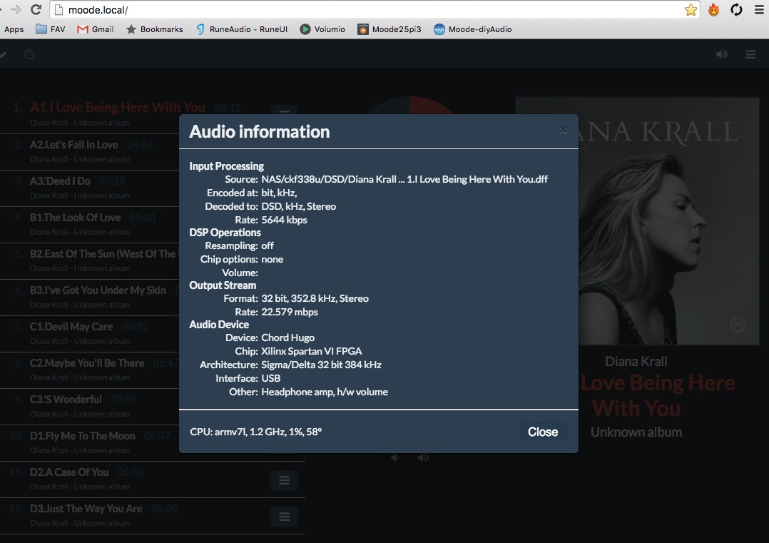

Now enjoying wonderful music with Moode 2.5 Player on Raspberry Pi 3.
Thanks for rpi3h.img, it works fine on my Pi3.
Now listening to: Diana Krall - Live in Paris. Sounds very transparent and engaging. I enjoy listening for hours.
Tim, note that Chord Mojo dac works on Moode via USB.

The first track on Live in Paris is one of my favorites 🙂
I'll add Chord Mojo to the device database for 2.6, thanks.
