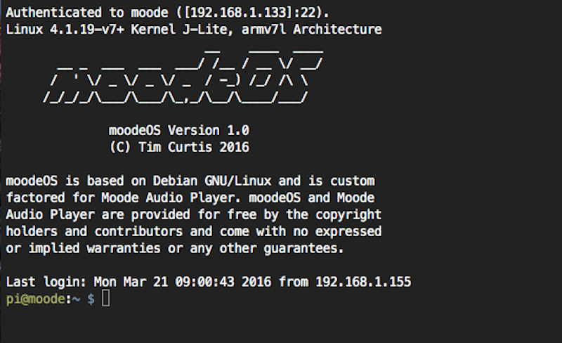

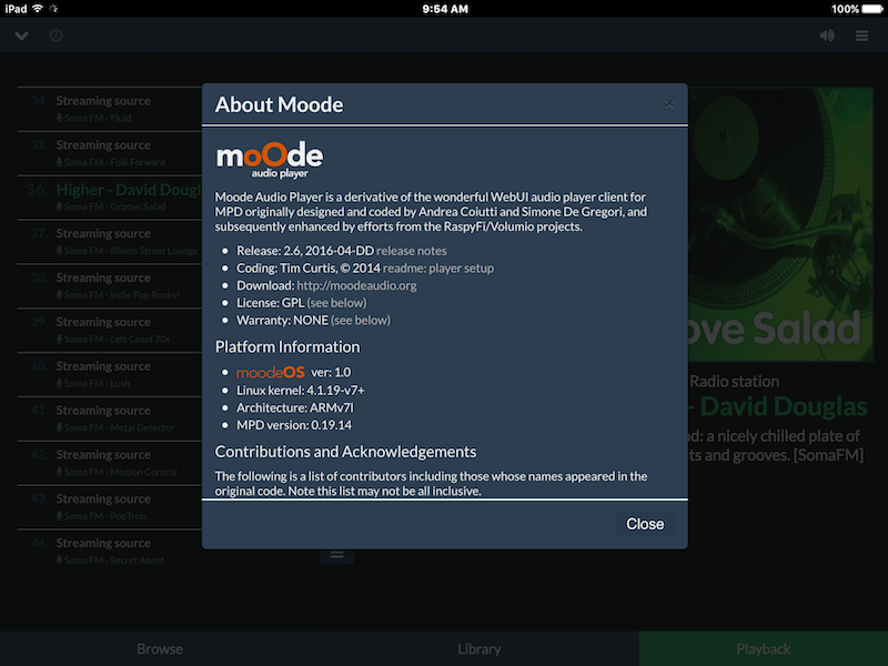

moodeOS Milestone #3 is complete. All components including core and non-core installed and configured. Moode Audio Player working perfectly so far on custom J-Lite. Performance is outstanding 🙂
moodeOS is based on most recent 2016-03-18 J-Lite (4.1.19 Linux kernel). It includes custom compiled components and stock components at their latest releases under Jessie. Many of the new component releases required configuration changes and changes to Moode software. Looking ahead to Milestone #4, the focus will be on optimization, evaluating replacement components, additional code changes to take advantage of certain features in J-Lite and stress testing for stability and robustness.
When complete, moodeOS will provide a solid, forward-looking OS platform for running Moode Audio Player, fully support the entire family of Raspberry Pi boards from Pi-0 through latest Pi-3, and offer a familiar configuration to Raspbian community making it easy to DIY 🙂
