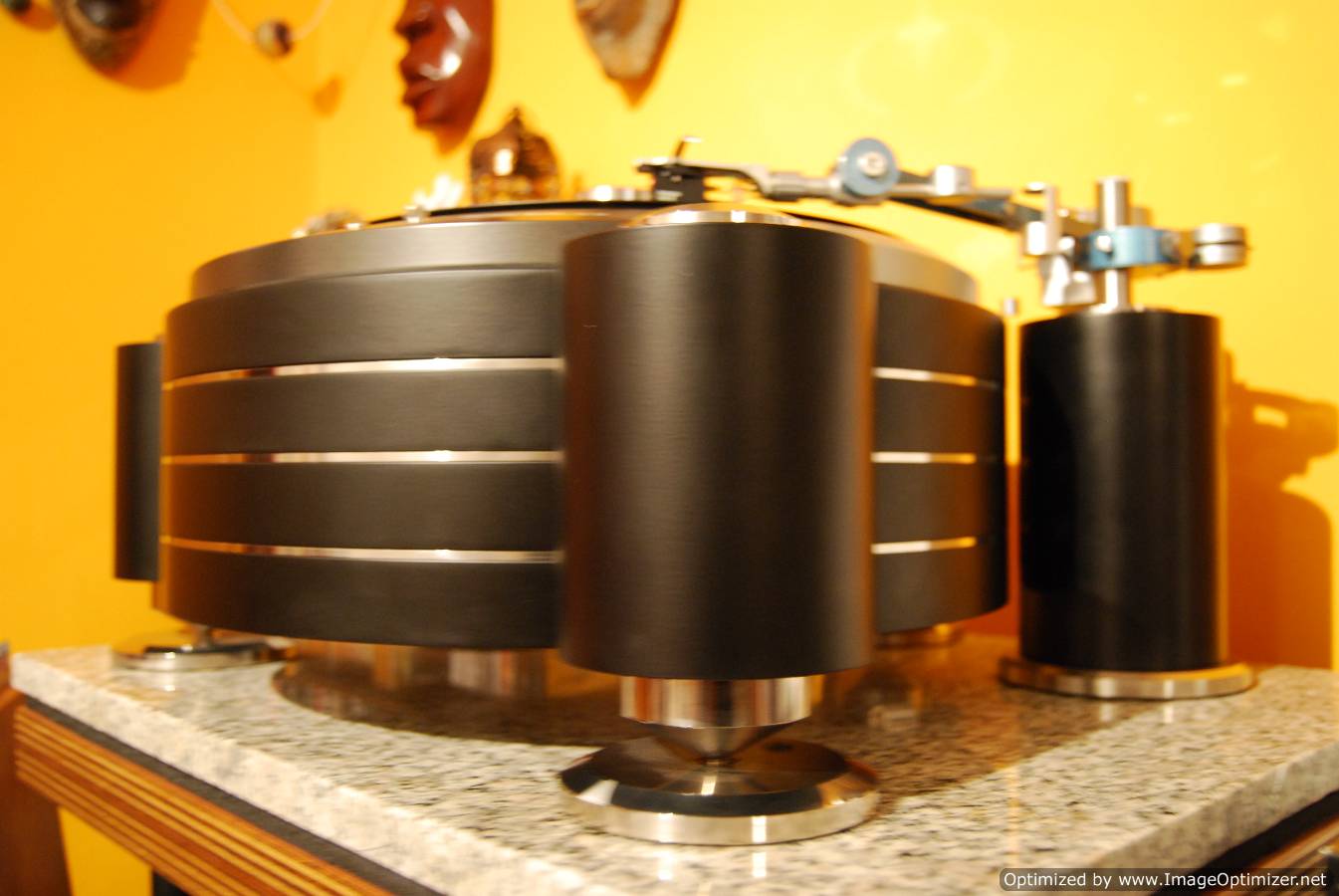

Well,the time arrived when everything was ready for paint.
We decided on a semi-flat black on aluminum parts ,so the inox ones would stand out.
I would really like to have the DP and the Dynavector painted also in black and silver but my friend thought that this would be too much (is there such a thing in modding?).
Anyway,it was HIS turntable and so he took only the aluminum pieces to an auto-body shop
for painting.
And they messed up big time!I had never seen such a bad paint job!
My friend was furious and asked for a repaint.
And again, they did a marginally better job!
So we decided to take the parts from them, and sent them to a another painter
specialized in painting gas tanks for bikes!
And he delivered!Everything looked great/professional.
We took the parts and with great care we layed the "layers" of aluminum/silicone/inox one on top of the other.
The big screws were tightened with the same torque untill the silicone
flanges were compressed to the point that the inox rings were secured.
Then it was time to add the three "legs",each with two screws as explained.
The lower inox parts/spikes were bolted on to produce a stunning effect.
The PS box and tonearm "tower" had the same treatment.
A mixed sand/leadshot filling was used in the hollow parts of the legs and the tonearm base.
They were filled up to the brim and then the top inox parts were screwed on tight.
All this construction had a weight of 35 kilos.
The PS box was another 7.5 Kg and the tonearm base another 8.5 Kg.
A true heavyweight before even placing the DP-80 inside!

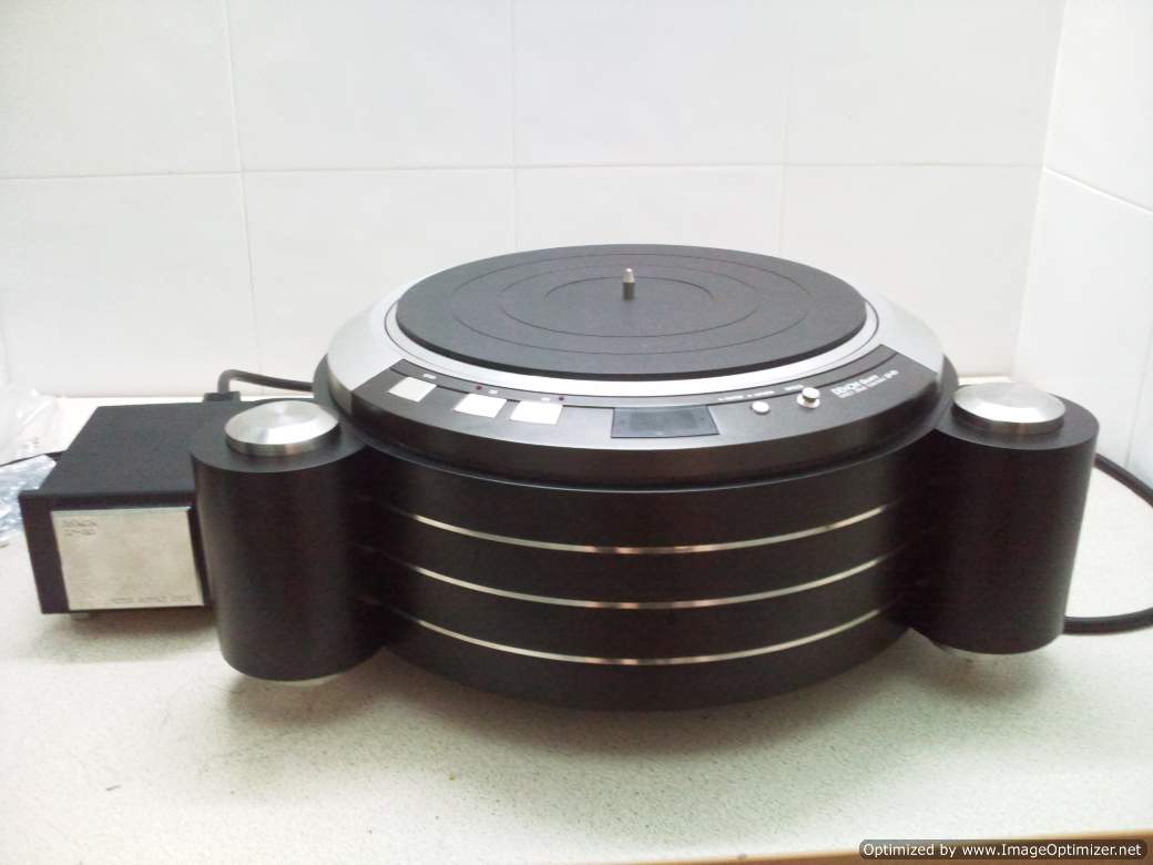

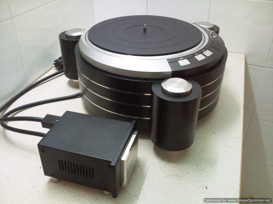

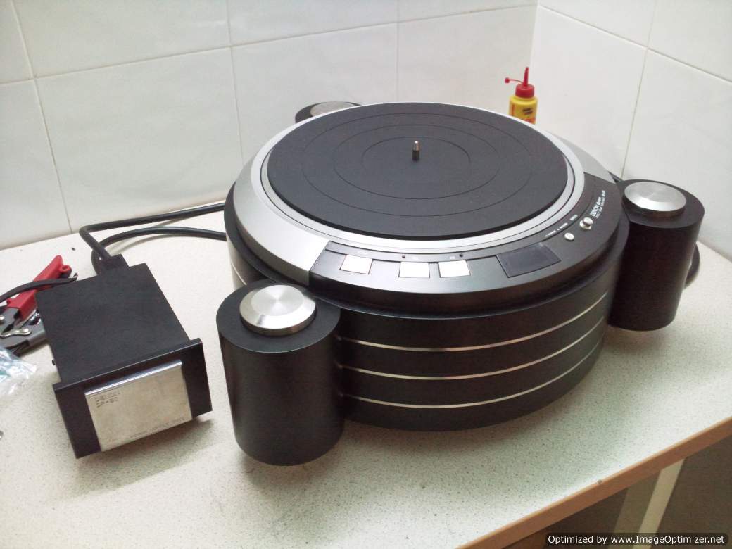

As i have desribed before,a 3mm free space was calculated around the DP-80's
lower part chassis (not for ventilation/heat reasons-the bottom aluminum part was drilled for this reason).
The initial thought was to find a material that we could wrap around the chassis
that would have a contact with the heavy aluminum base to prevent any ringing.
After some searching we found a self adhensive neoprene strip (about 3,5mm
thick and 5 cm wide) that we could use.
These were placed on the inside of the aluminum base in a vertical manner,
roughly leaving 5 cms of free space from each other.
The bottom of the DP-80's chassis would have a free space of 5mm from the
aluminum base, thus we added two round cut pieces (5cm diameter)
of the same neoprene foam, one on top of the other (7mm high) that would be compressed to 5mm when the two would mate.
A little K-Y gell was used to help the "insertion"!
It was a very tight fit and i had to push down while my friend was securing the turntable chassis tightening the bolts.
Then the platter with the thick rubber mat was placed.
After connecting with the PS and pushing "start" we could judge the outcome of our efforts.
The turntable would spin but we could here NOTHING!
It was almost spooky!
We would place our ears next to the rotating platter in an effort to sense something but there was nothing to be felt!
I placed my hand on the chassis and felt a complete absense of vibration.
In my book that was total success.

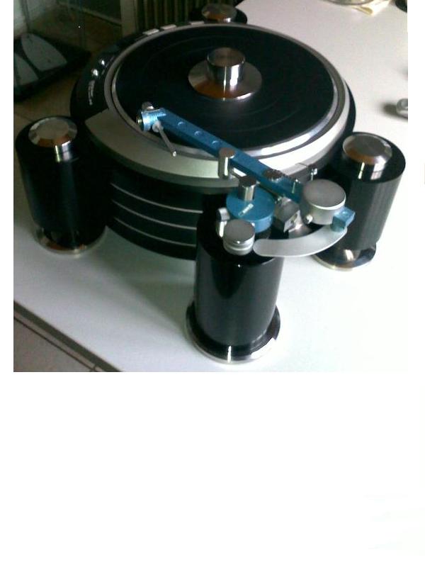

Quicly we set up the tonearm to have a complete picture of the visual
impact.My friend was so over the moon that he kissed me!
The next day we set the turntable/arm/cartridge/phono in his system.
TOTAL SUCCESS!For a total of 5500 euro (and some personal work...)
he had in his possesion an outstanding analog combo.
Just for the sake of argument we put his old turntable (7000 euro cost turntable/arm only) against our DP.
It was laughable...and my friend put it for sale the next day.
He sold it with his old (2000 euro) cartridge for a cool 4500 euro.
He has still his old phono stage to sell,so we can say that he hasn't lost any money at all!

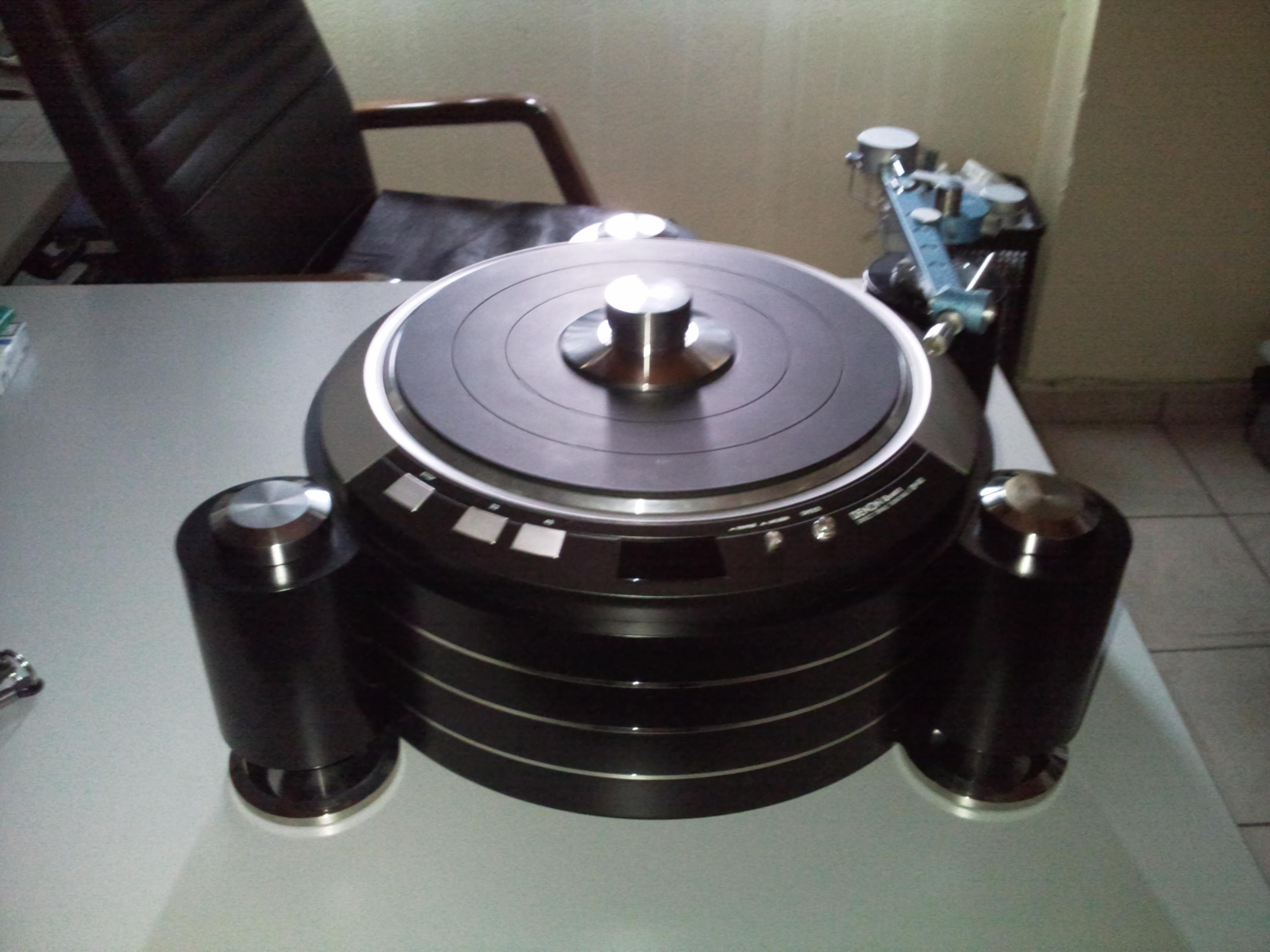

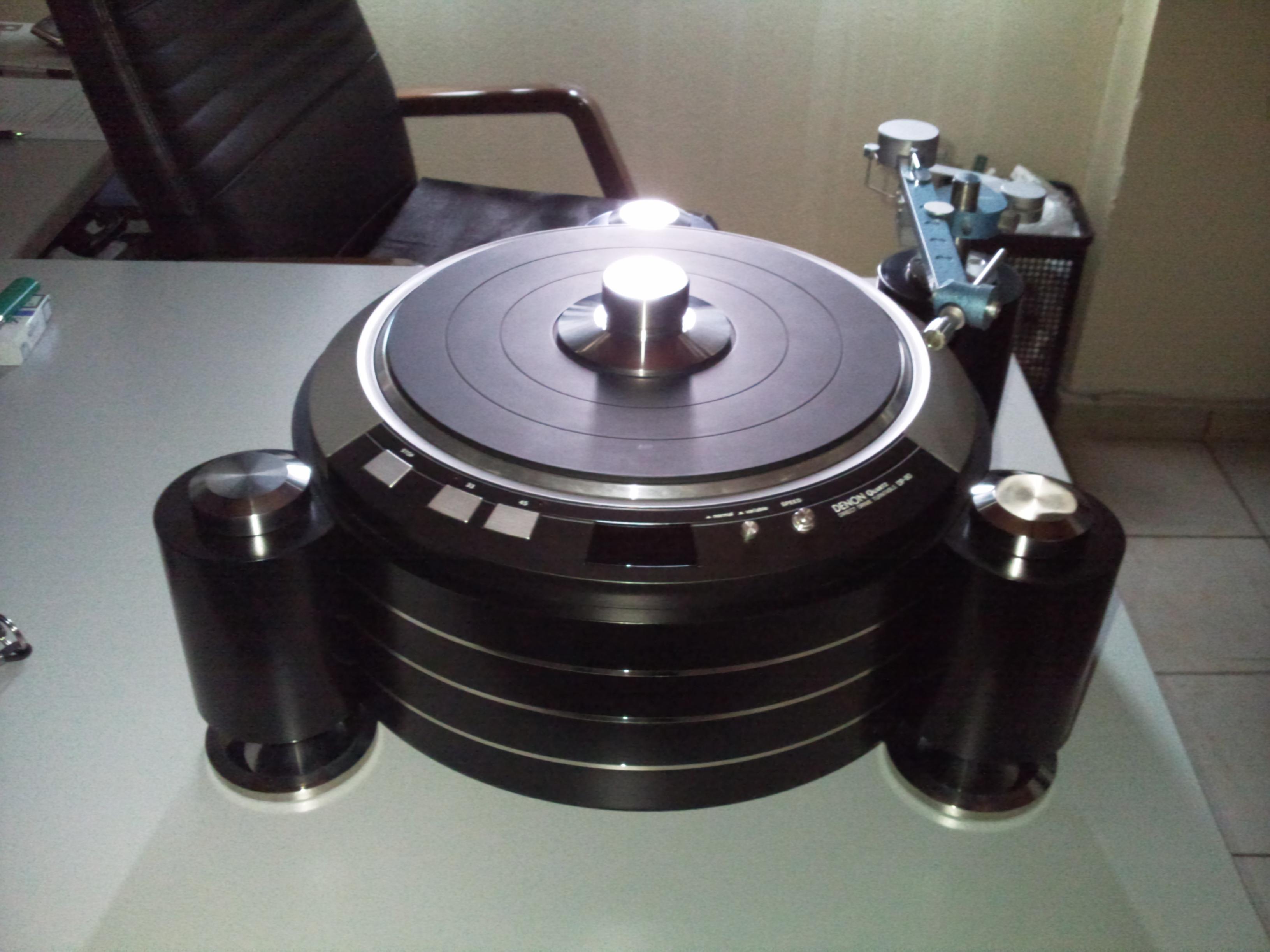

See some pictures before tonearm...

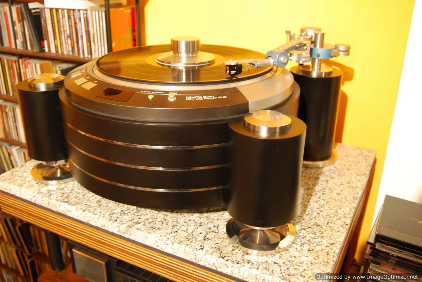

That looks absolutely STUNNING! I am EXTREMELY envious! I've wanted a DP-80 for a while now but never have the money whenever they rarely show up on Ebay. Patience... patience.....
That's one of the nicest looking decks I have ever seen - truly a work of art!

Thank you for your kind words.
That was my goal:a) to make it in a totally professional way.
b) address the problems of the original design.
c) make it look like true eye candy-in a Darth Vader way!

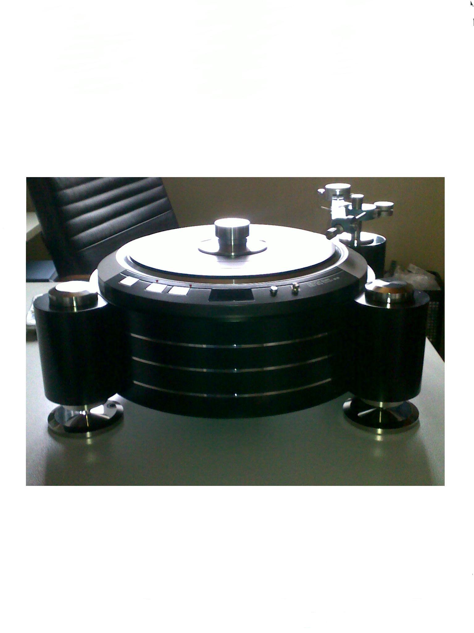

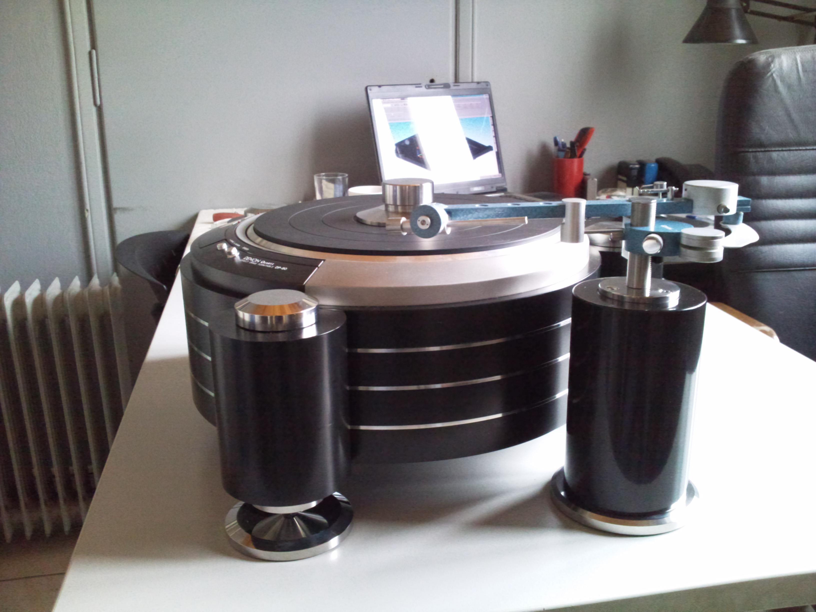

As a last part regarding the construction,i had cut circular flanges out of a sheet of hard
silicone for the cups under the spikes and the tonearm base.
I tried for a softer grade but the 50 kilos weight compressed them to nothing...
As a final touch, a record weight (450gr) was cut and polished
from a solid block of inox steel.
Under it, a similar (soft) silicone flange was glued.
As soon as my friend sells his phonostage,and has the ability to finance this last stage,i will design a 5mm hard aluminum"platter" that will go
under the rubber turntable mat with a thin sheet of decoupling material under it.
This way a)i will add approx 1.1Kg of rotating mass
b) i will add another decoupling layer from motor vibrations and
c)i will be able to design a periphery ring.
It will be out of inox steel (1.1Kg) and will look as an integral part of the design.
When all this will be over,i have great expectations from this set up.

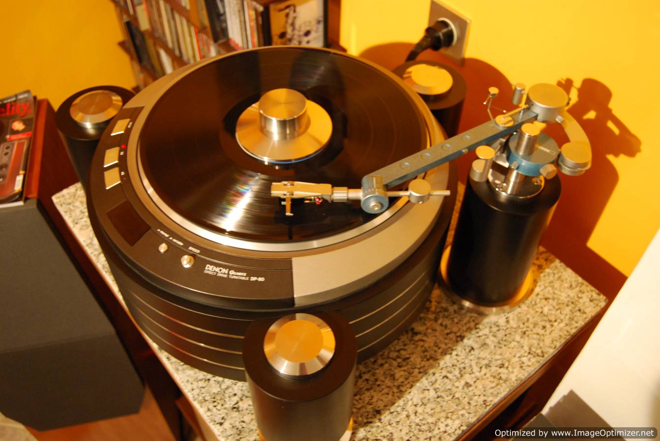

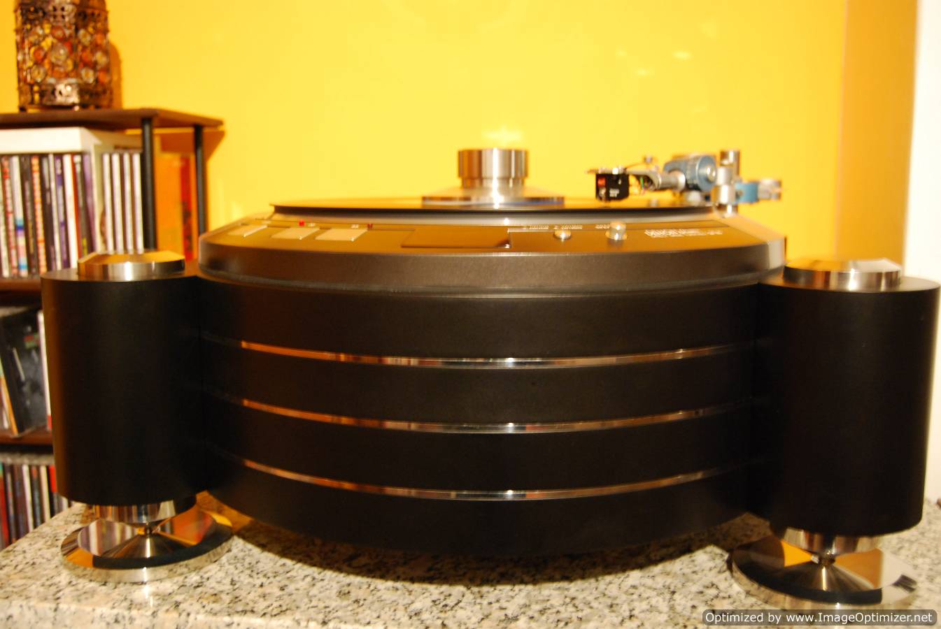

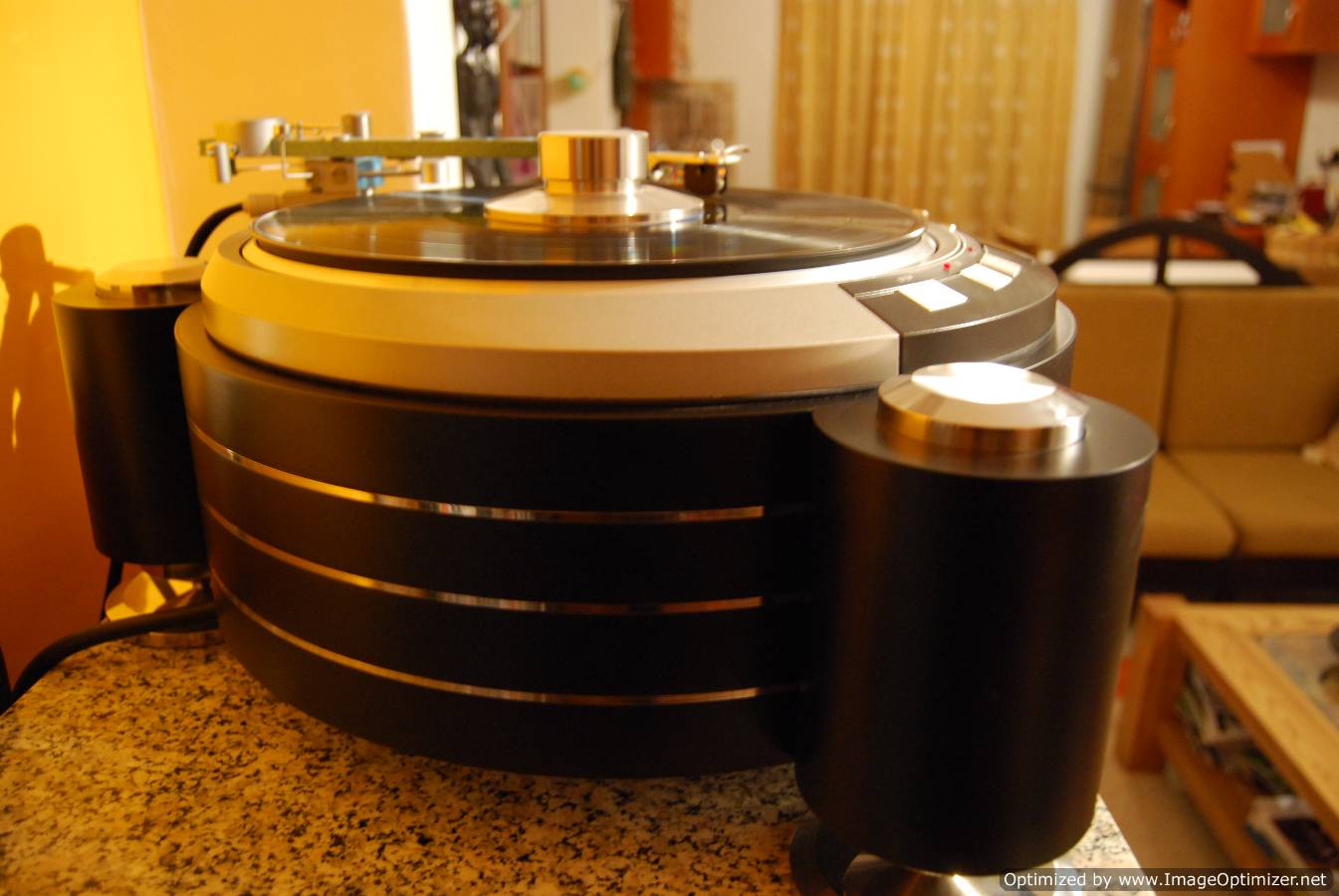

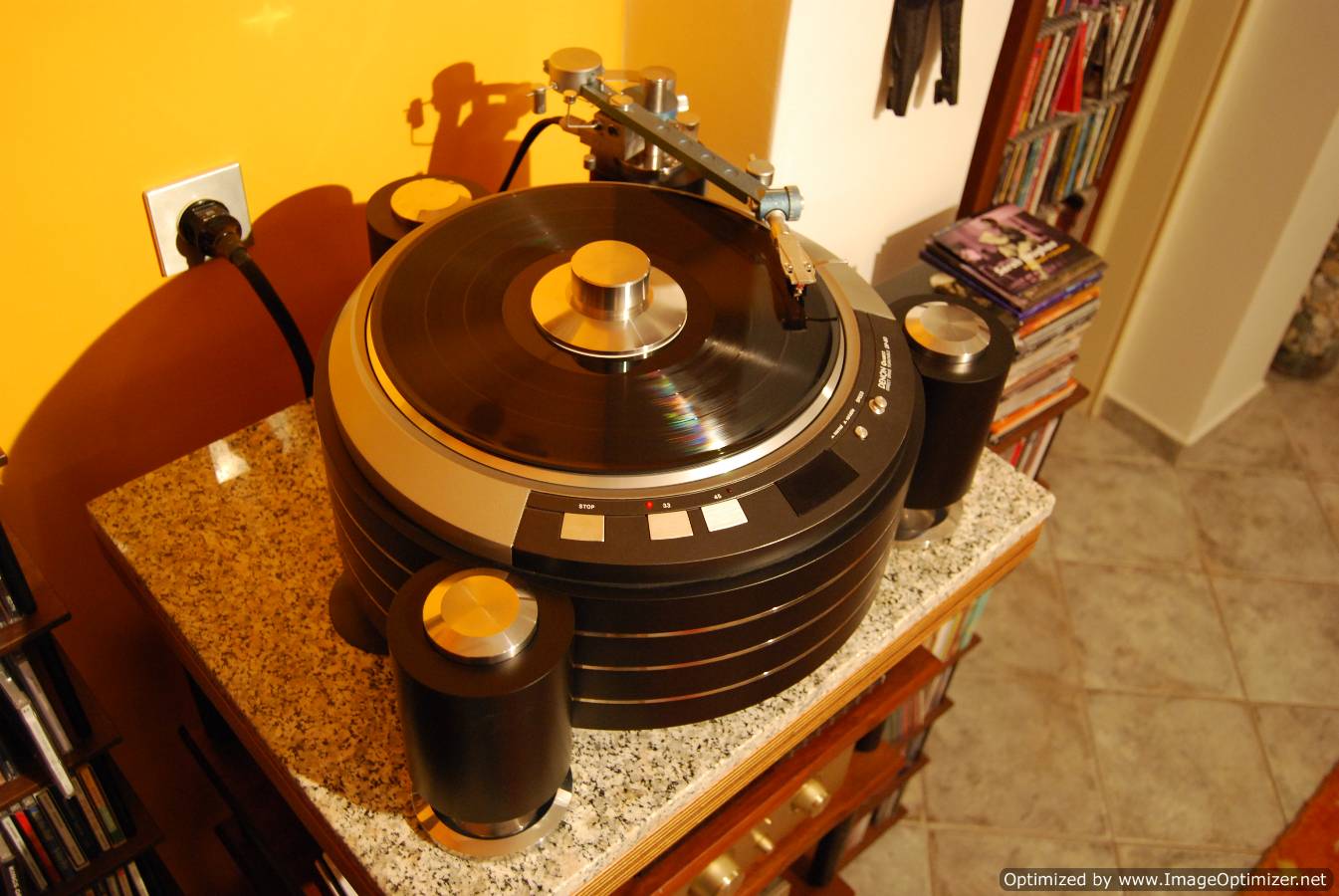

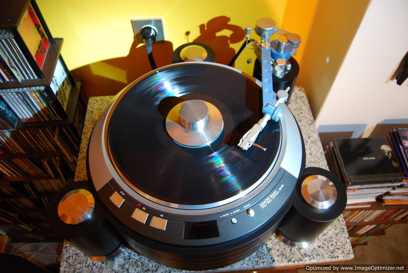

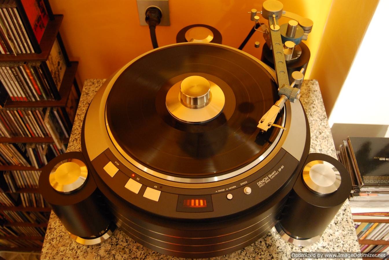

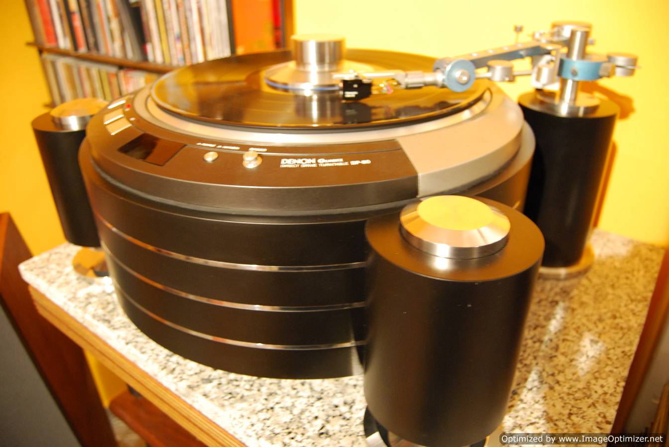

And some more pictures...this time with the Dynavector in place.

Thanks!In this case, it is just "form follows function".
Come to think of it,it's round shape leads to a design like this.
I just followed through my initial thought of how it should look...
I know that many will resent the "modernization" of this turntable
but i was not into "restoring" anything to it's "vintage glory".
My goal was merely to make it the best that it could be...

Finally my friend has sent me some more photos with the turntable in action...
Here they are...tinted because of the lights used in his audio room...
The separate power supply box is located lower in his rack.
The "spotted white" granite plate that it is placed on, doesn't match (in my opinion), plus it's only 2 cm thick.
I have advised him to get a second layer of granit with another vibration absorbing sheet under it...
I am waiting for two more DP-80s to arrive and get the same treatment.
At least one of the owners is going for the "full monty" upgrade with the
added metal mat and periphery ring...
I can't wait to see how high the limit is!
