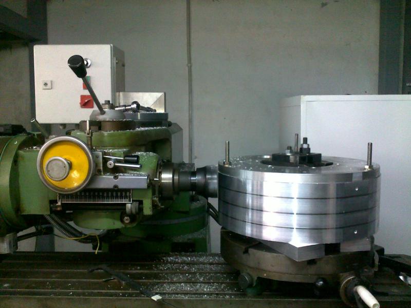

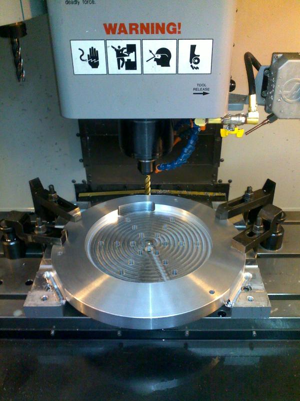

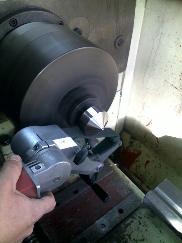

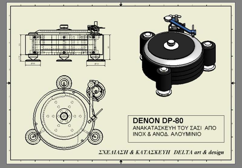

Plus a couple more...
One is a close up of the PS box and the other is with a stylish lamp ,matched to the turntable colors ...
I have to thank of course the "Delta art & design" team for transforming
my designs into CNC executable files and for their contribution into metal selection,raw metals preparation and cutting and help into making this
(and other crazy designs of me) come to reality...

Thanks for the good words!
The possibilities with the mix and match of different chassis materials
and dampening/absorbing solutions are endless.
I prefer to use different metals with strategically placed dampening materials.
I think suspension is uselles if you are over 35-40 Kilos.
As for the free standing armboard...i totally agree.
You can follow a solution like the one i used or ...
you can incorporate a round free standing block inside a cutout in
the -presumably- rectangular chassis.
There is a way to be able to use the same block for 9 and 12 inch armboards
by making this cylinder around 10 cm in diameter and drilling just one offcenter armboard hole in it.
By rotating the round block the offcenter hole either comes near the spindle
(9" tonearm) or pulls away (12" tonearm).
This is a very neat solution to your problem.
The block itself could be all one mass,different metals or make it hollow (bowl like) use a separate -scew on- top layer for attaching the tonearms and experiment with different fillings,eg lead shot,liquid silicone,sand etc etc.
The most damping i have achieved (completely DEAD) is sand saturated with motor oil or lead shot with motor oil...
But most damping doesn't always produce the best or more "likeable" sound...
