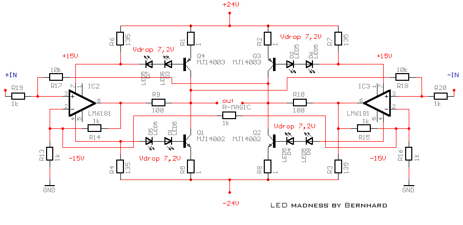

I did not try it. My calculation was 0,65V across emitter resistor + 0,65V base-emitter voltage + 2 x 3,6V for blue LED
= 9V.
24V rail voltage - 9V = 15V for the girly-man-chip.

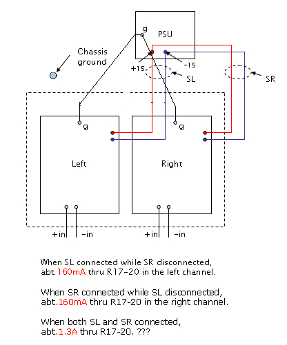

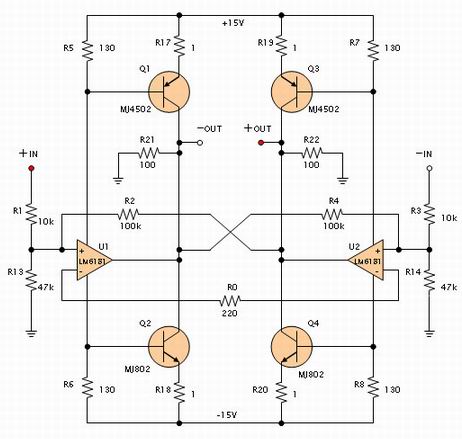

It was time to test the sound.
The +/- 15V power supply was connected to the left channel. The dc current through 1 ohm emitter resistor was measured 160mA. Okay. The left speaker was connected to the output terminal. The unbalanced music signal was injected to the input. Yeah, there was music.
The +/- 15V power supply was disconnected from the left channel and connected to the right channel. There was 160mA and there was music too. Yeah...
Finally, to the both channels, the +/- 15V power supplies were connected. The dc current through the emitter resistor of the left channel was measured. Heck...!?!? 1.3A...!?!? Why not 160mA... The right channel was measured. Again, Heck...!?!? 1.3A...!?!? I did not touch any circuit component. When each chennel was tested, the dc current were 160mA. Strange! strange. strange...
Arrrrrrrr... I am getting mad. Blood pressure is reaching high. Would you please save me? What is wrong?

First, what do you mean with channel?
Did you actually build to mono amps?
If so, whats the connection or link between both amps?
Sketch?

Netlist said:Whats the connection or link between both amps?
Check grounds!!??

Even though I don't think what I'm about to say will solve your problem I would connect each of the amplifiers (separate cables) directly to the PSU ground avoiding the chassis route. But leave the PSU ground connection to Chassis.
Also is a common practice that the ground connection to chassis be through a low value power resistor to avoid ground loops.

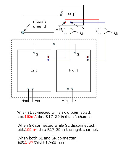

jh6you said:No solution yet. 🙄
JH
Try to connect the grounds as explained by apassgear and drawn here.
Make the ground wires about the same length and as short as possible.
Does disconnecting the source make a difference? Is it balanced or SE?
In your sketch I cannot see the relation between the "chassis ground" and the rest of the circuit, except you connected a point somewhere 'in space' to the ground of your circuit.
Are the "g" points of your amps connected to chassis or only to the grounded components (R13/14) and your additional 100Ohm from output to ground?
(Hope I'm a little clear here) 😱
Measure with an ohmmeter every ground that should be ground;
especially the relation of grounds between both amps and chassis. Should all be close to 0.
Personally, I think you should avoid to use the whole chassis as a ground for now, but that could imply rebuilding a few things
Sorry to disagree a bit on this with you, apassgear, the idea is: the less ground, the less ground loops. Only a few good ground connections should work here. BTW, my amp has no chassis, and as a result also no ground to chassis. 🙂
Anyone correct me if I’m wrong here.
/Hugo – Is certain JH will solve it! With the help of good sleep and some coffee. 😉

Netlist said:
Try to connect the grounds as explained...
Bernhard said:
There must be a major mistake.
I think that the trouble comes neither from the poor grounding nor from any major mistake.
Hmmm... one solution follows another headache. The following circuit gives me the solution. I am going backwards, hahaha... The oscilloscope confirms that all are fine. No... except one thing. The abosolute dc offset voltages are measured around -5V at all four output nodes. Hmmm...
