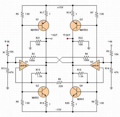

Preliminary YAX2!!! 🙂
O Yeah!!! It works!!!
Here is my working YAX2 circuit, which is a bit different from Nelson Pass original. I have R0 of 220 and R15/16 of 1.5k. These values are estimated to have maximum output current boost. Meanwhile, my pocket calculator tells me that R9-12 work well for the boosting of the output voltage swing but also work unwantedly for diminishing of the output current at the same time. Therefore, I just reserved them for the later application. I do not have any adjusting pot. Nevertheless, almost no absolute offset volt at the output nodes and almost no differential offset. I will come back with further info after listening test.
Thanks, Nelson Pass. 🙂

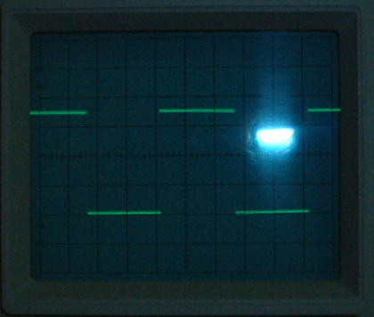

JH6you,
Could you send also square waves at 40 Hz and 20 Hz ?
Seems if bass are so punchy there should not be any distordance of the squares at very low frequencies.
Thanks very much.
PS.Could you do same test with sine and square at 100kHz?
Great job.Congratulations !!!

Post 349 & 350
JH,
How many volts are you swinging on those osciligraphs ?
What load did you test with ?
BTW, that square wave looks real clean ....
Nice work JH
Dave

Looks very good, JH
Glad you finally made it!
Are you driving the amp balanced or unbalanced?
Very nice square wave, is it measured with or without load?
/Hugo 😉

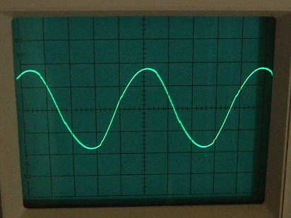

100kHz
Sign wave at 100kHz. JH

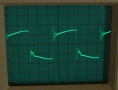

jh6you said:Square wave at 100k Hz.
JH
Ringing - singing - overshooting ?
Looks like we got a problem with the fast cfb OP.

JH,
retry 100 ohms R9/R11 on OP output like in my design 😉
Should avoid ringing
I recognize with pleasure that you got rid of R10/R12 😀
You also can forget about R13/R14, because R3/R4 already go to virtual ground
If you are an expert, what are the ringing and overshooting?
I know the singing only.
JH
