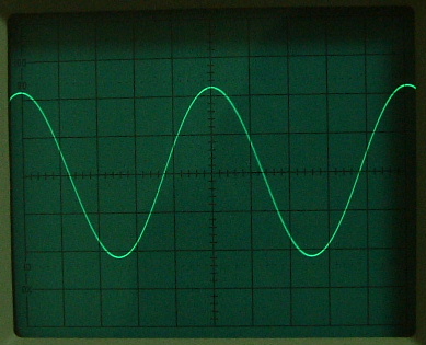

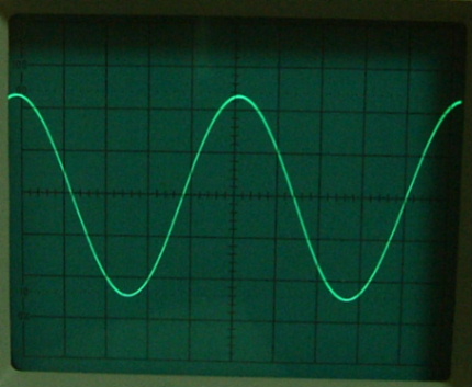

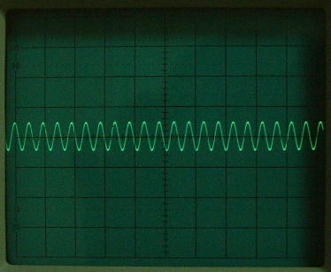

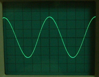

Looks very decent to me, still we don't know which load you connected?
On your first sine wave 1V/div X10 you have about 9Vpp.
On the mosfet versions I have 10Vpp.
I will post some squarewaves of it later, input compared with output.

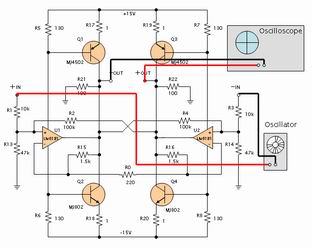

It would much appreciate if you post a brief sketch how the load, scope and oscillator are set.
Thanks.
JH
Thanks.
JH
Your scope and sinegenerator a correctly connected in your sketch.
The load, of course should be connected between +Out & -Out.
(Speaker 8 or 4ohm).

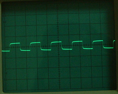

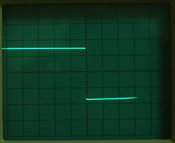

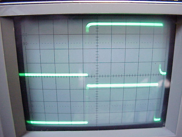

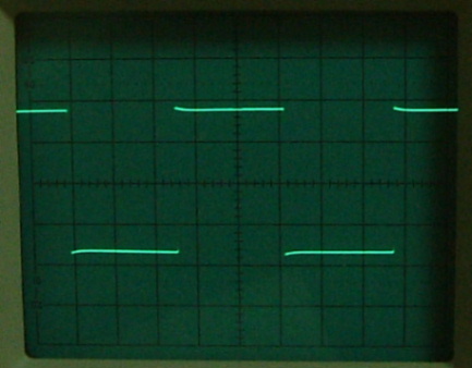

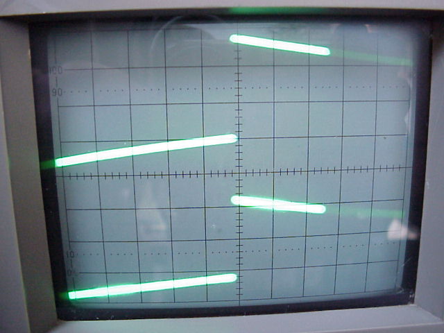

In the following pictures you'll see the input and output compared to each other.
The lowest squarewave is the input.
Input 20mV/div; Output 100mV/div. Sweep time depending on frequentie.
Here's one of 40Hz.
As you can see, my generator is rather crappie, but it's the difference between in and out who is important.
/Hugo
