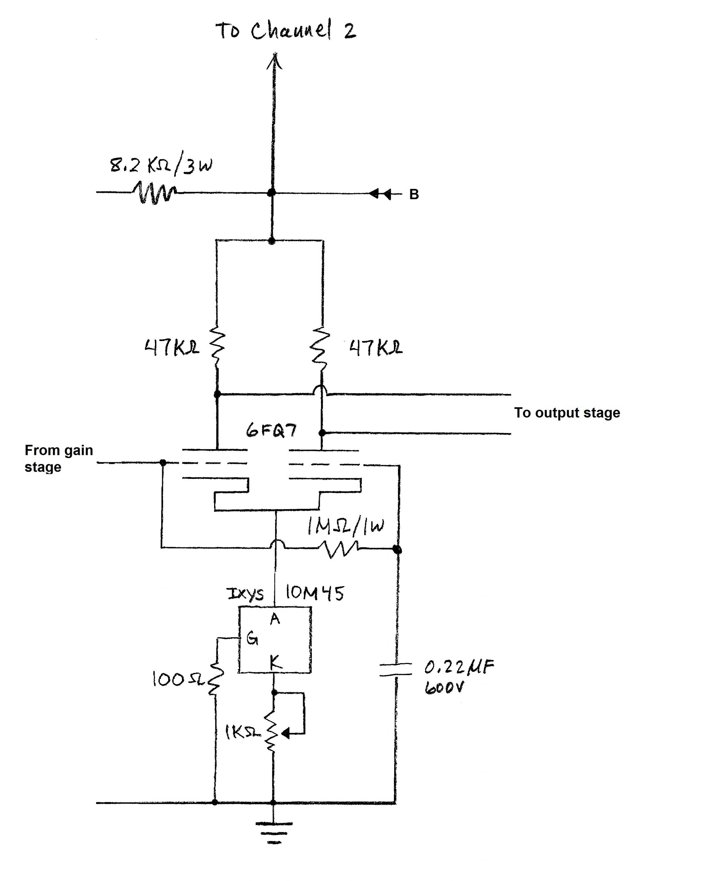

Is anyone able to weigh in on the phase splitter, particularly the CCS and negative supply?
Here's how I wired one in a recent build. (see attached). Not shown:
- The 10M45 is on a heat sink.
- There's about 8 mA going through the CCS
- The cathodes sit at about 100V
- Filament circuit for the 6FQ7 is biased up somewhat.

Okay. The LTP doesn't need a negative supply if direct coupled from the gain stage.

I have updated the schematic to what I believe is correct. I kept Cathode bias since that is what I'm using now. I can switch to fixed bias if it is superior. Any thoughts? I have also changed the schematic to individual bias resistors and much larger caps.
I have also changed the CCS wiring to what is shown in the post #26 example.

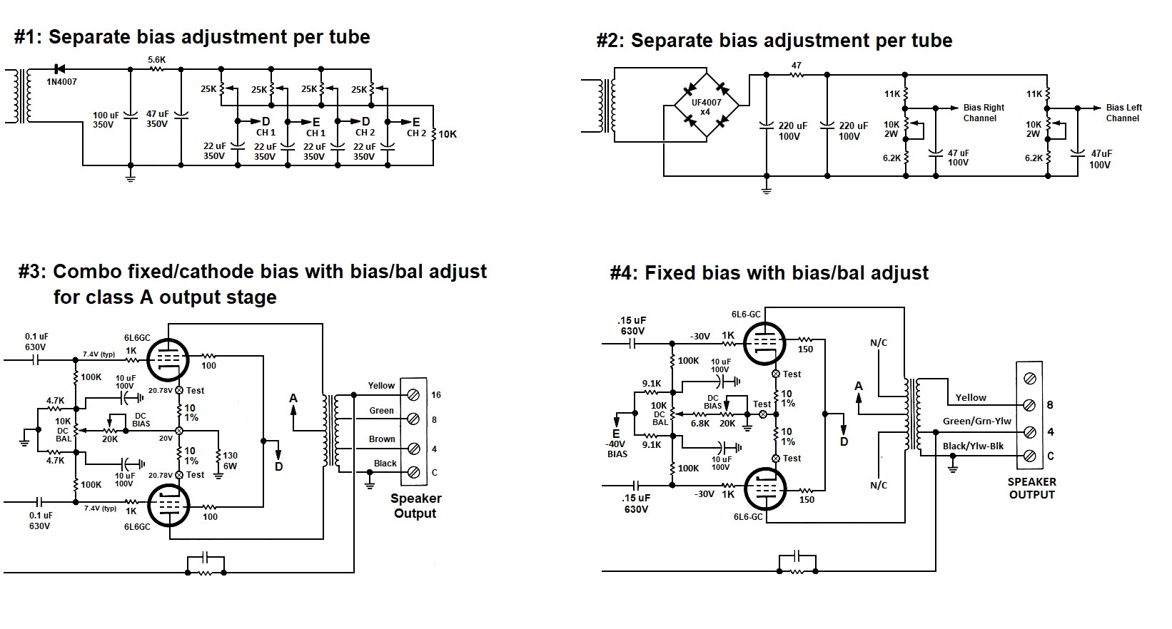

Kward, you mentioned being able to post a bias supply example a couple posts back. Would you be able to post that so I may be able to reference that as well?

Here are some of the recent bias schemes for output stages I've done. Feel free to use these as you see fit and/or file them for future reference. For each case, look at the overall concept rather than at specific resistor/pot sizes and voltages. You will need to adjust resistor/pot sizes and secondary voltages used for each specific application given output stage needs and voltage swings needed.
The schemes shown in methods #3 and #4 are the bias/balance methods I was referring to earlier. These methods use the same number of pots as the individual bias approaches in methods #1 and #2, but can offer an advantage depending on your point of view. That advantage being that once you set DC balance, you are easily able to adjust bias up or down without upsetting balance, thus allowing one simple control to position bias where it works best for that particular output stage. On the other hand if you know exactly where you want to set bias and don't plan on changing it very often, the bias/balance method offers no apparent advantage over the separate bias adjustment approach. Overall though, I'd say there is not one "better" solution than the others--it just depends on what you prefer and the type of output stage you're dealing with.
Method #3 is a combination fixed and cathode bias. It uses the cathode voltage itself to generate a voltage that is applied to the grids. It is suitable for class A output stages.
Additional notes:
Additional notes:
- For your amp, you can duplicate method #4 for each pair of output tubes in the push pull configuration. But again, whether or not this method is better or easier than the separate bias adjustment approach is up to you.
- In methods #2, #3, and #4, the system is setup so that if the wipers of the adjustment pots do ever disconnect from their track due to dirt, age, a defective pot, or whatever, the bias voltage does not become undefined. Rather, in that error condition, it forces the tube(s) into an overbias situation so they don't run away.
- For method #1, since it does not offer protection from a faulty wiper connection, I used sealed pots so that there is lesser chance of the pot wiper disconnecting over the lifetime of the amp.
- When designing a bias network for your output stage, it is important to offer the proper adjust range to account for mismatched tubes, but not too much adjust range so that a careless adjustment would cause red plating. I usually build in about 15% adjust range on either side of the nominal bias voltage desired.
- In a fixed bias output stage, it is also important to design the bias network so that it always comes up to voltage well before the output stage starts to conduct (from a cold start). That way the tube is never put into a runaway condition. This should be accounted for in the design phase of the amp.
Thanks Kward for the thorough explanation.
I'm leaning toward #2 for simplicity and safety. I believe I would just add four individual channels, one per tube, correct?
I'm going to try to figure out voltages and component values and update my schematic. Tube datasheets are confusing to me.

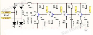

If you're feeling lazy, you can use one of these. I've used them and they work well enough.
Electron Tube Amp Negative Grid Bias Power Supply Adjustable 4channel for PP SE | eBay
Note in method #2, as shown on my previous post, a 2W pot was used. That's one of the negatives of that approach--bigger pots might be required since it changes current per leg based on pot setting. So to get the adjust range sometimes needed you need to start with more current flow, which then means a physically bigger pot that can dissipate more heat. I'm sure you could design it to use a smaller pot....but more work..🙂.
In method #1, I usually use 10 turn trimmer pots and mount (glue) them directly to the inside of the chassis with adjust nut facing up through the top of the chassis so if using a flat blade jeweler screwdriver, you can adjust bias without flipping the amp over or without removing a cover plate.

Since I have no experience in choosing a fixed bias circuit, I have no problem trying any of them. I’ll try number #1 then, I see why it doesn’t offer wiper protection as you mentioned, but I believe this is similar to the design Koda posted in post#31. Wouldn’t that scheme offer protection via the 30k resistors, or am I reading that wrong?
