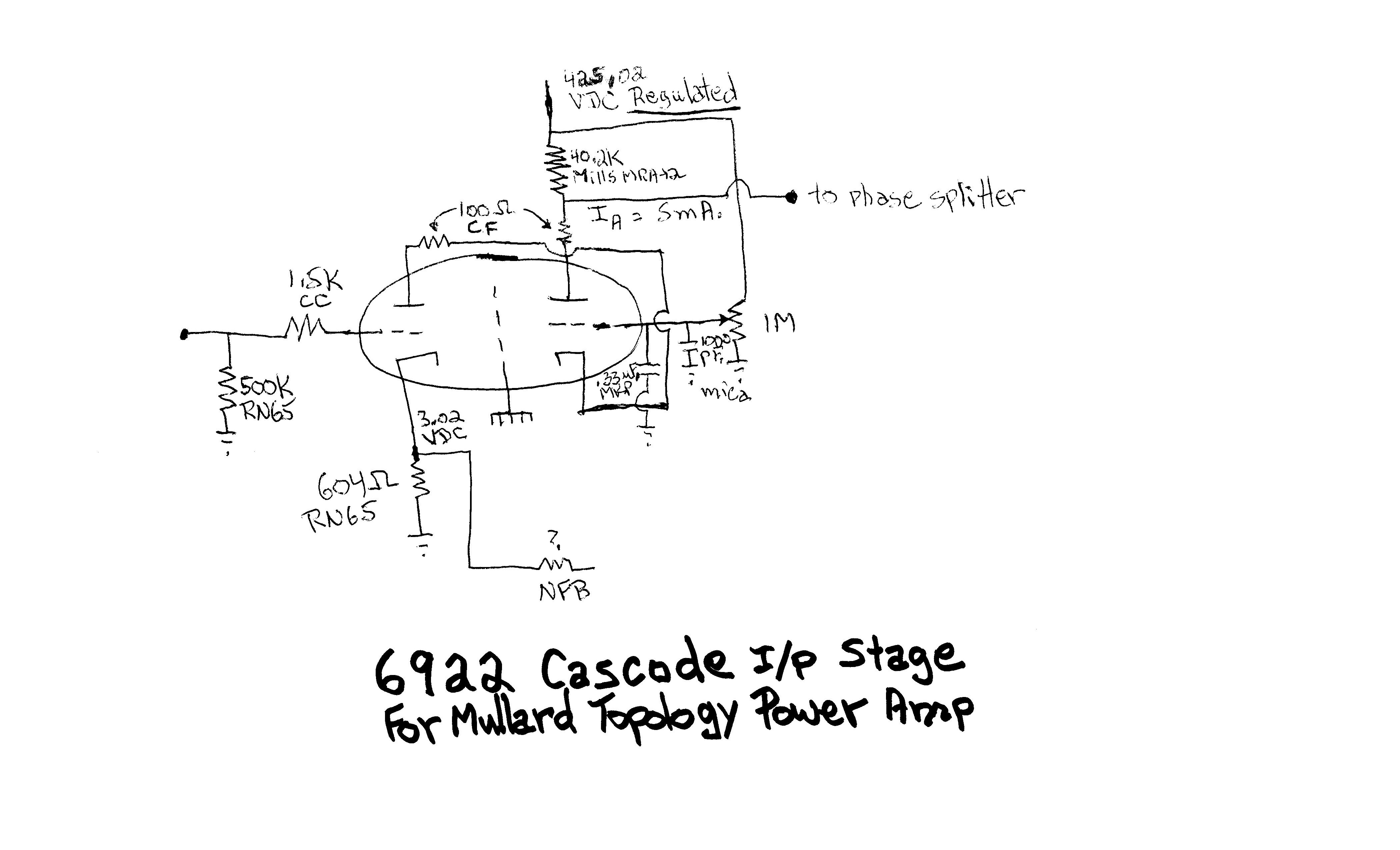

Eli D.'s suggested drive circuit will be hard to beat. You really want quite a lot of current running through the driver valves. Type 5687 lets you run even more if desired.

So i learn, what is the benefit of a high GM tube? Also, it was said the G1 stopping resistors of 10k are a little large and 1k might be better, how does this increase stability? And also note, that i do currently have 100R stoppers at G2.
So if the 6922 stage shown by Eli is the way to go I'll give it a shot. I just have a couple questions. I see it has a 425VDC regulated input, would an LR8K work for this? I noticed that this has a higher grid leak of 500K than i see on other designs I've looked at, usually around 100K, what is the benefit of this? Is the 1M pot a gain control.
As for the phase splitter, to go to a CCS, would that mean using something like an LT1085 wired as a CCS replacinf the 1.5K resistors off the cathodes? And is there another phase splitter design i should consider all together?
The cascode behaves much like a pentode. It is intended to drive a medium μ twin triode LTP phase splitter, not the paraphase splitter shown in the OP. Notice that the voltage amplifier is DC coupled to a LTP splitter, in Mullard style circuitry.
Cascodes and pentodes are not plagued by an adverse interaction between the grid to ground resistance and CMiller. That fact allows for a light load to be presented to the upstream circuitry. OTOH, triode CMiller combines with the grid to ground resistance to form an undesirable low pass pole. Hence the frequently seen 100 Kohm value.
It looks like a LR8 in each channel will work.
The 1 Megohm pot. sets the bias of the "upper" triode, which controls the current flowing in the entire assembly.

Hi Chris,
I’m up to try just about anything as long as it retains the power tubes and transformers. I’m just looking to improve what I have which I don’t think will be hard to do when ditching the paraphase and the triode wired ef86.
My problem lies with designing these circuits myself, ie. Calculating values of components, voltages and currents needed for specific outcomes.
Would someone be able to explain or provide some links to what a differential input stage and a direct coupled push pull cathode follower is? Preliminary google searches left me more confused, perhaps they’re known be different names.
I’m assuming direct coupled means that it is not coupled to the next stage via coupling caps?

The long-tailed pair 6CG7 stage in the previous schematic is an example of a differential amplifier. By making the common cathode resistor very large (compared to cathode input impedances) the anodes will have equal and opposite currents flowing through them. Ideally these days the common cathode resistor would be a couple-of-transistors constant current source. It's also has a push-pull amplifier's insensitivity to power supply noise and couplings.
Direct coupled just means that the driving anode is connected to the following grid without a capacitor, and so sets the grid's DC voltage at a fairly high voltage, just right for a cathode follower.
A nice layout might use a type 12AX7 input stage with constant current source to their cathodes, and a 6CG7 or 6SN7 or 5687 or even a 12AU7 push-pull cathode follower stage. Capacitors couple signal to the output stage grids, as already used, and you're done. No loop feedback is necessary, which is a great advantage for DIY. You'll need a small negative voltage supply for the CCS's, maybe -5 Volts at 5mA tops.

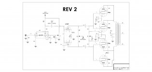

Hello all,
Back in post #5 Eli posted a schematic of a Citation V and also a 6922 input stage as recommendations for an LTP phase splitter and Cascode input stage. This is to be integrated into my existing amps as an upgrade to the paraphase and EF86 I/P stage.
So I drew up a new schematic combining the 6922 Cascode schematic and taking the LTP from the Citation V. I did switch the 6922 to an ECC99 as was recommended.
On the new schematic I'm not exactly sure if all the component values and voltages which were taken from Eli's attached schematic would still hold true when mating to my output section.
I'm particularly confused with the LTP CCS wiring and the negative supply. I'm not sure if the negative supply would go to the CCS as I've seen on other LTP schematics or if it would go to the same place it would in the Citation V design, after the coupling caps. And is -54V correct/optimum?
I re-attached the existing amplifier schematic as well as the proposed "REV 2" schematic. Please feel free to mark it up with errors/ changes. Or let me know what to change.
Also note on the "REV 2" schematic, I haven't drawn the power supply yet but I will once the active circuitry is correct.
Thanks again for the help!!

6CG7 LTP
Ok, I miss understood the use of the ECC99 then in the previous post. I’ll change the input stage back to 6299.
As far as the 6CG7 LTP, does the wiring and component values look correct?
Also does the negative supply enter in the correct place? And the CCS go to ground?

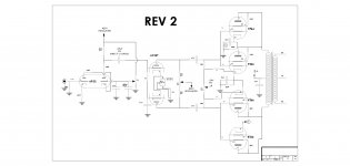

Hello,
I edited the driver tube back to a 6299 as I had the wrong tube labeled there.
Would one of the experts be able to look over the driver and phase splitter stage? I'm especially confused with the CCS and the negative supply of the LTP. These were combined from schematics from post #5 and added to my existing output stage.
Any help would be greatly appreciated!
