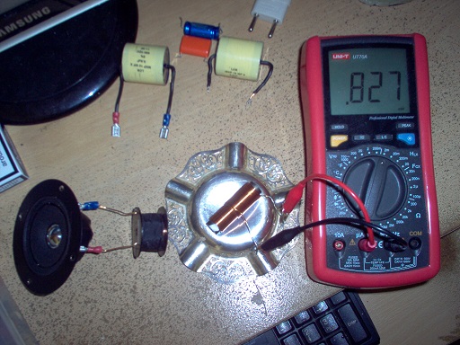

Anyway, I'm going to go out on a limb here. An 18g air core probably has a similar resistance to a 24g ferrite core. (system7 knows a thing or two about ferrite cores).
Is that an invitation to chip in, Allen? 😱
I do mess around with these things. Ferrite increases inductance 4 fold. Doubling the number of turns also increases inductance 4 fold. Thing is, coils have such small resistance relative to a driver, it's not a biggie.
Still, maybe we need a review here. A quiet tweeter and a possibly overheated tweeter filter.
The coil and resistor do look as though they could have let out the magic smoke at a party.
It all goes horribly wrong when a tweeter blows, and then the crossover goes undamped and resonant at high volume.
Circuit a bit like this at 1.8R, 6uF and 0.2mH.
All quite replaceable. Components and accessories
Might as well do the capacitor at the same time. 5.6uF 250V will do.

Simple diagnostics like putting a 1.5V penlight battery and paperclip across the drivers tells you whether they work in some fashion. Inspect solder joints for cracks, called a dry-joint. Crossover components like resistors can be measured with a £5 multimeter. Capacitors don't often go wrong, especially plastic foil types. Coils are hard to break too, being essentially just enamelled copper wire.
A bad woofer with rubbing voicecoil will distort. Quiet tweeters might have clogged up ferrofluid, which needs replacement or removal. Flat sounding speaker sounds like no or reduced tweeter output to me.

Would a clogged up tweeter show a different reading on my multi meter?Just for the record, tweeters are terribly simple things when you (very carefully...) lift them apart:

No it wouldn't. The multimeter just tells you the voicecoil has continuity in some fashion. That doen't mean it is any good though. Could have fried into a birdsnest which is irrepairable. Expect 3 to 7 ohms.
I found the 1.5V battery test was good enough to identify dried up ferrofluid. The bad one hardly crackled or sounded at all. The better one made more noise.
Ferrofluid is essentially kerosene oil and ferric oxide. If the oil evaporates, the voice coil is stuck in sludge resembling Marmite. Easy enough to clean the residue out with WD40 and blotting paper.

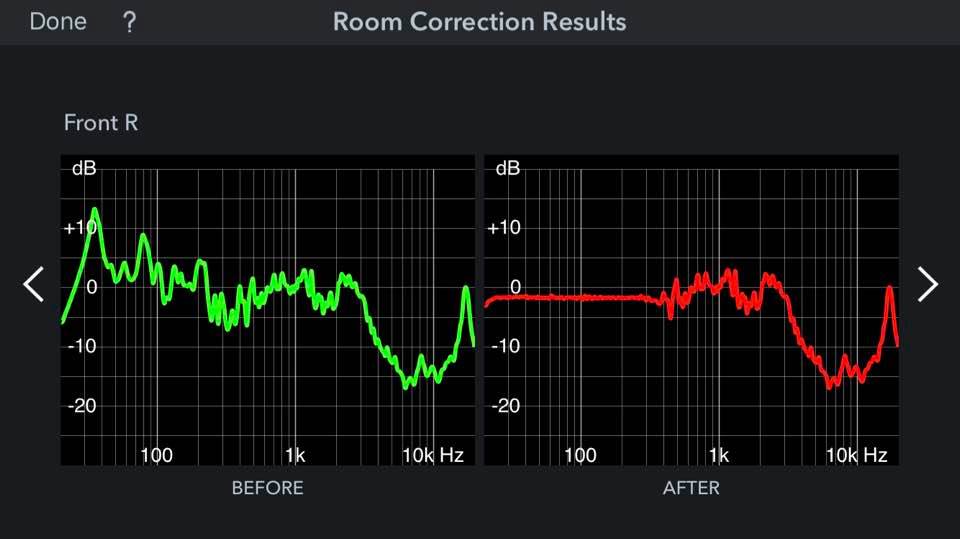

Thank you for the good info and advice. Please excuse some of my terminology as Im still learning. Ive been reading up today about the missing bit in my graph. The huge null from 2000 - 20000hz. The upper mid range to brilliance. This is what my ears seen to notice. Shall I also check the mid-driver again? Or would the tweeter problem be the sole problem of the missing 2000hz - 20000hz. My goal is to replace what needs be, unless its an easy fix im happy to try myself.

It looks like a tweeter problem to me. I'd expect the big 6" metal midrange unit to be crossing over at about 3 kHz here. You should measure on axis.

Thank you very much for your replies Steve. Much appreciated. Im going to take the tweeter back out tomorrow and check the fluid and also what you suggested. Thats more great information. Im enjoying learning about it all and find it quite fascinating the science and logic behind it all. Ive been fascinated by Music/speakers since a very early age but never got into the technical side until I got into surround sound and room treatment at home. I dragged the filter to around 500hz on that graph, thats why its only been corrected to around 500hz as recommended by Audioholics videos.

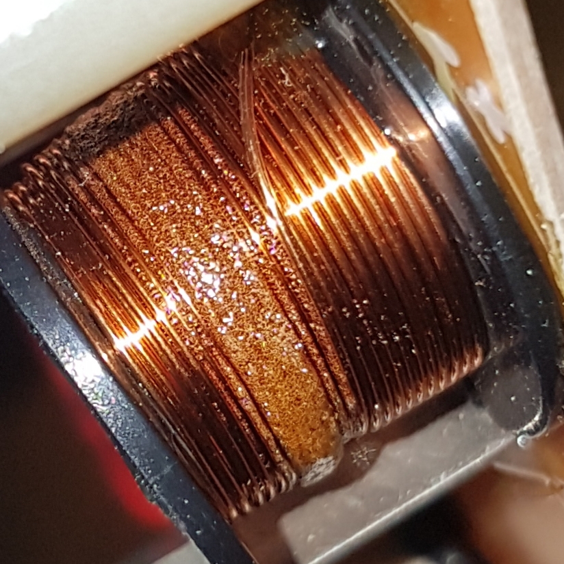

Hi all,
Due to the incredibly long lead times of hifi collective I got them fixed up last week and the tweeters appear to be working. The only thing I've noticed is they do seem to be fairly noisy and sometimes distort. With no signal through them there is a fair amount of noise from the tweeter, not audible unless close to them but I'm sure I didn't notice that before.
I'm wondering if this is my poor soldering or something more serious? Thinking about it now I didn't clean anything with contact cleaner or something before I soldered them I just took the old ones out and stuck the new ones in.
The only thing I did differently was that I noticed that in the old crossover both inductors were flush to the PCB and I read that they should be 90° relative to each other so I spun it round so it was sat on its circumference.
Any thoughts?
