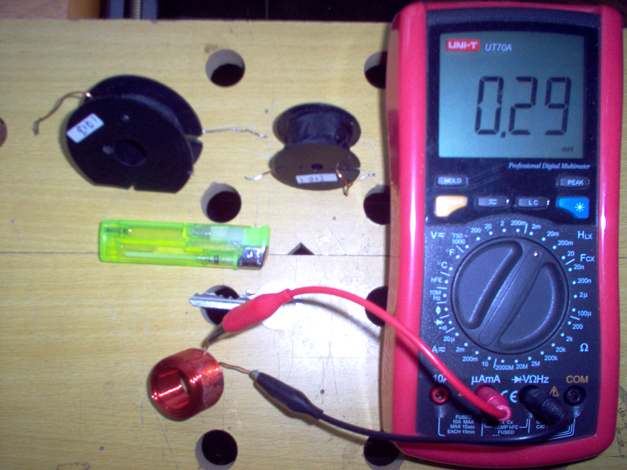

Always hard to find simple tests with simple equipment. The 1.5V battery trick is a goodie. Also swapping components around. But a multimeter is very useful:
This £70 Maplin one measures coil inductance and capacitance and resistance. But even a resistance measurement done right will tell you something if you compare the two speakers.
As it goes that's a Wilmslow Audio 0.2mH aircoil at the top right, which is what you might be needing to buy here. But it could be a dry joint or a bad tweeter too. The resistor and a 250V 6uF look unlikely candidates to blow IMO. Or it could be a plain loose or corroded wiring connection.
