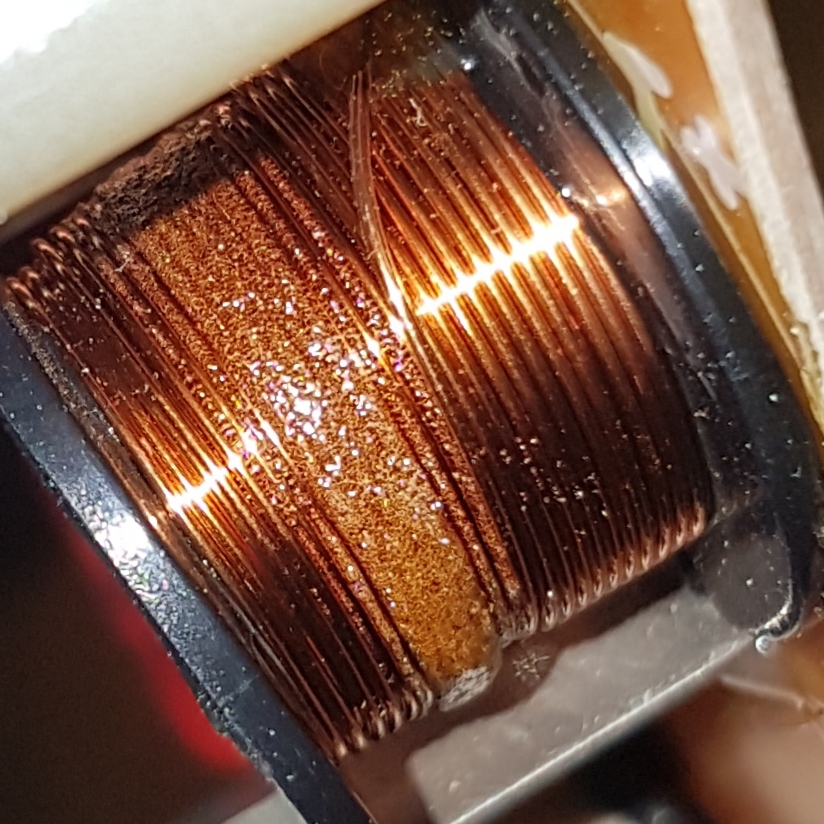

The core is going to assist the inductor, making it smaller. Less wire means less resistance if that is an issue in your crossover because the resistance is sometimes unwanted. However, at higher levels the core runs out and fails temporarily, upsetting operation.
Solution, use air core or size you iron properly.
I was asking because 24awg does seem relatively small gauge and given the fact they've overheated I could see a benefit to buying higher gauge wire for the inductor. But does lowering the resistance if the inductor effect the frequency response of the speaker? For instance van the tweeter then draw more power and would be louder?
24 gauge is fairly small, but importantly it's too small to be used the way it was. I'd definitely go larger, no need to get carried away though.

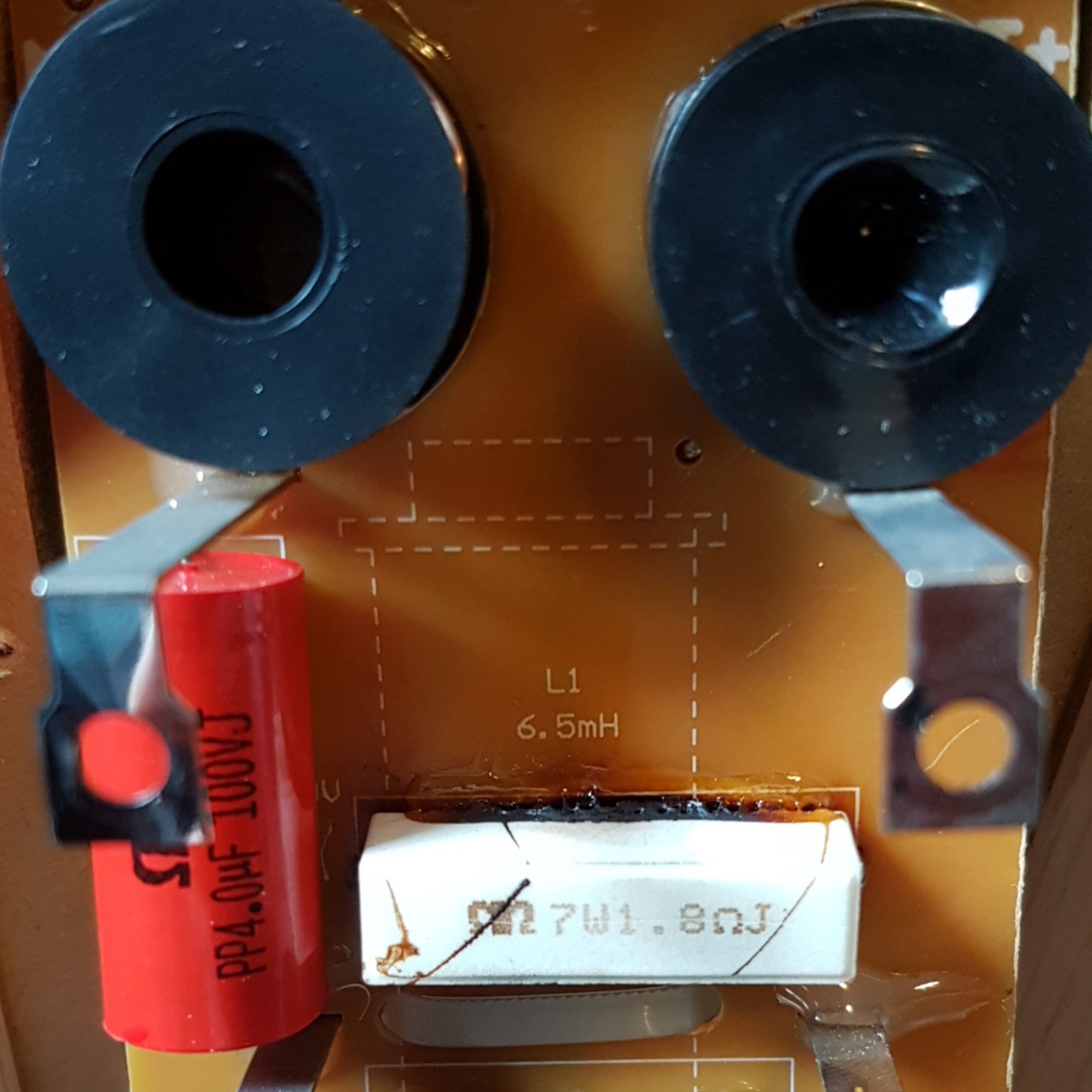

Still, maybe we need a review here. A quiet tweeter and a possibly overheated tweeter filter.
The coil and resistor do look as though they could have let out the magic smoke at a party.
It all goes horribly wrong when a tweeter blows, and then the crossover goes undamped and resonant at high volume.

Circuit a bit like this at 1.8R, 6uF and 0.2mH.
714062d1541548033-restoring-monitor-audio-r300-bookshelf-speakers-monitor-audio-r300-md-original-schematic-png
All quite replaceable. Components and accessories

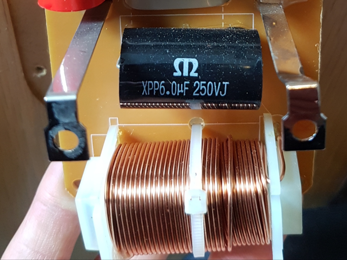

Might as well do the capacitor at the same time. 5.6uF 250V will do.
