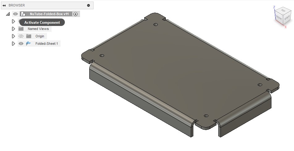

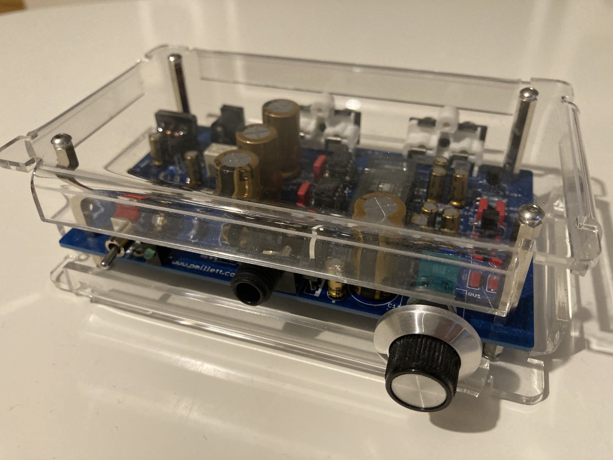

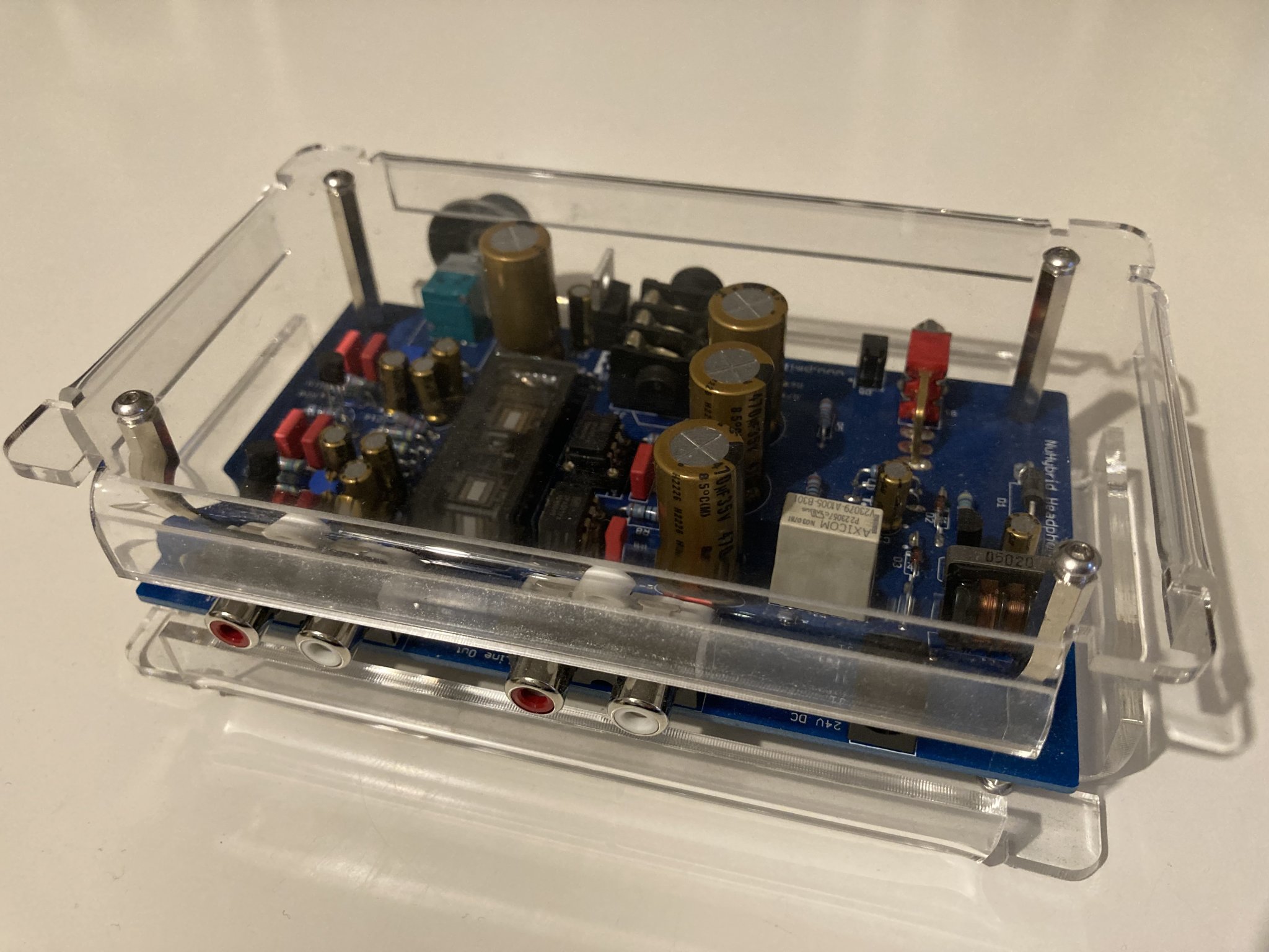

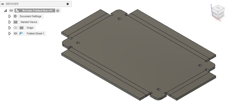

// not exactly Modushop punch library but... maybe useful to some //
I don't know if things could be put in place to have a sort of database for chassis template / example.
In any case, maybe to have this thread as a repository, here are files for a very simple "laser cut & bended plexiglass cover" for Pete Millett NuTube Hybrid headphone amp
1. Electronic project here http://www.pmillett.com/nuhybrid.html
2. Fusion original files "NuTube-Folded-Box v11_PMillett"
3. Derivatives (dxf, step, Fusion pictures) "NuTube_DXF_4PMillett" "NuTube-Folded-Box v11_PMillett" "NuTube-Box-..."
4. Pictures of the finished device "NuTube-Headphone-Plexi-ISO-Front" "NuTube-Headphone-Plexi-ISO-Back"

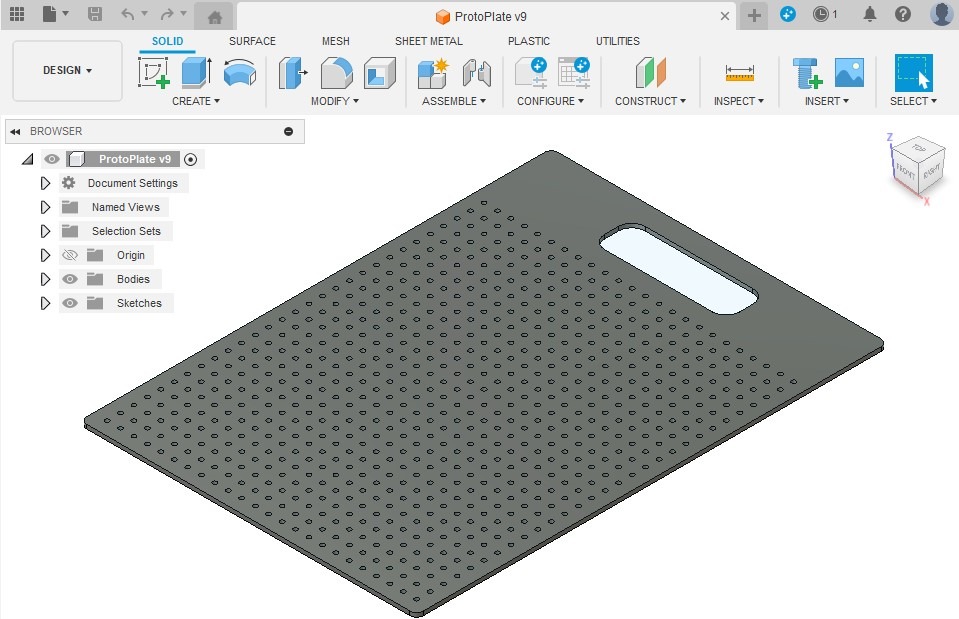

A set of files for a "prototype plate": a laser cut plate mimicking the perforated plate in a "Mini Dissipante", so i could place components easily before ordering the actual plate from Modushop. I put a hole serving as a "handle" for ease of transportation between different places i do stuff.
Fusion file, Dxf, Step and a picture of the file in Fusion
Picture of the real use here https://www.diyaudio.com/community/...amplifier-modules.383745/page-19#post-7495374

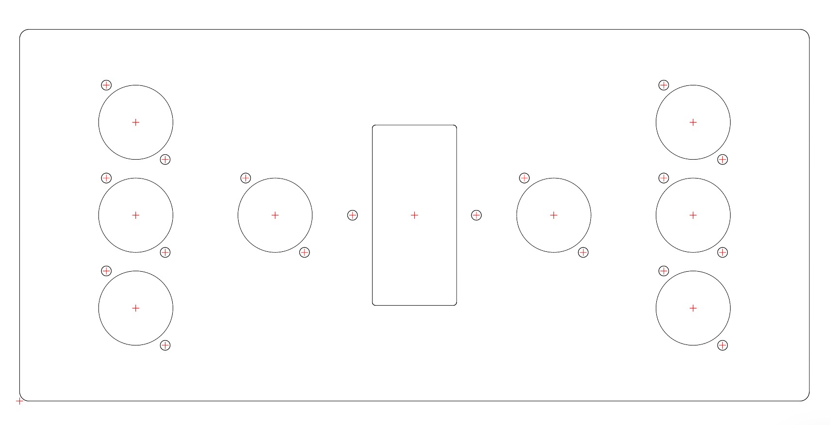

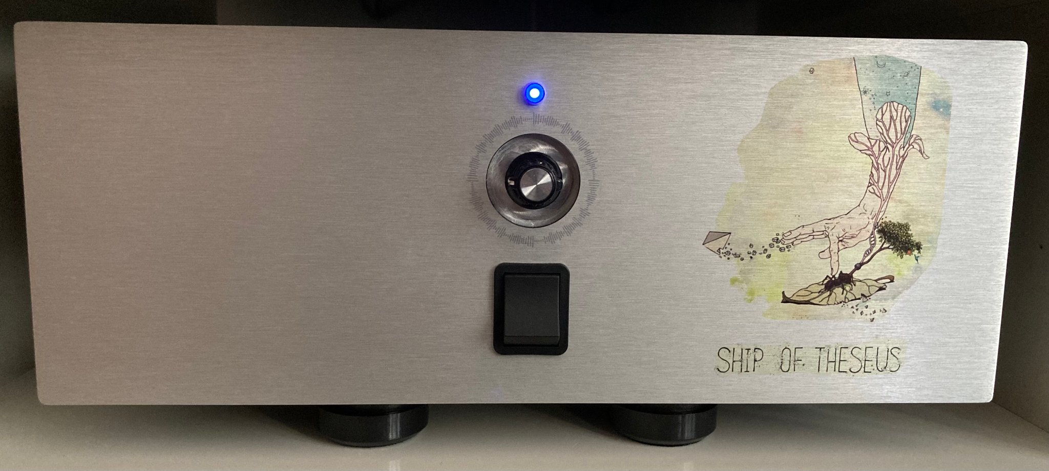

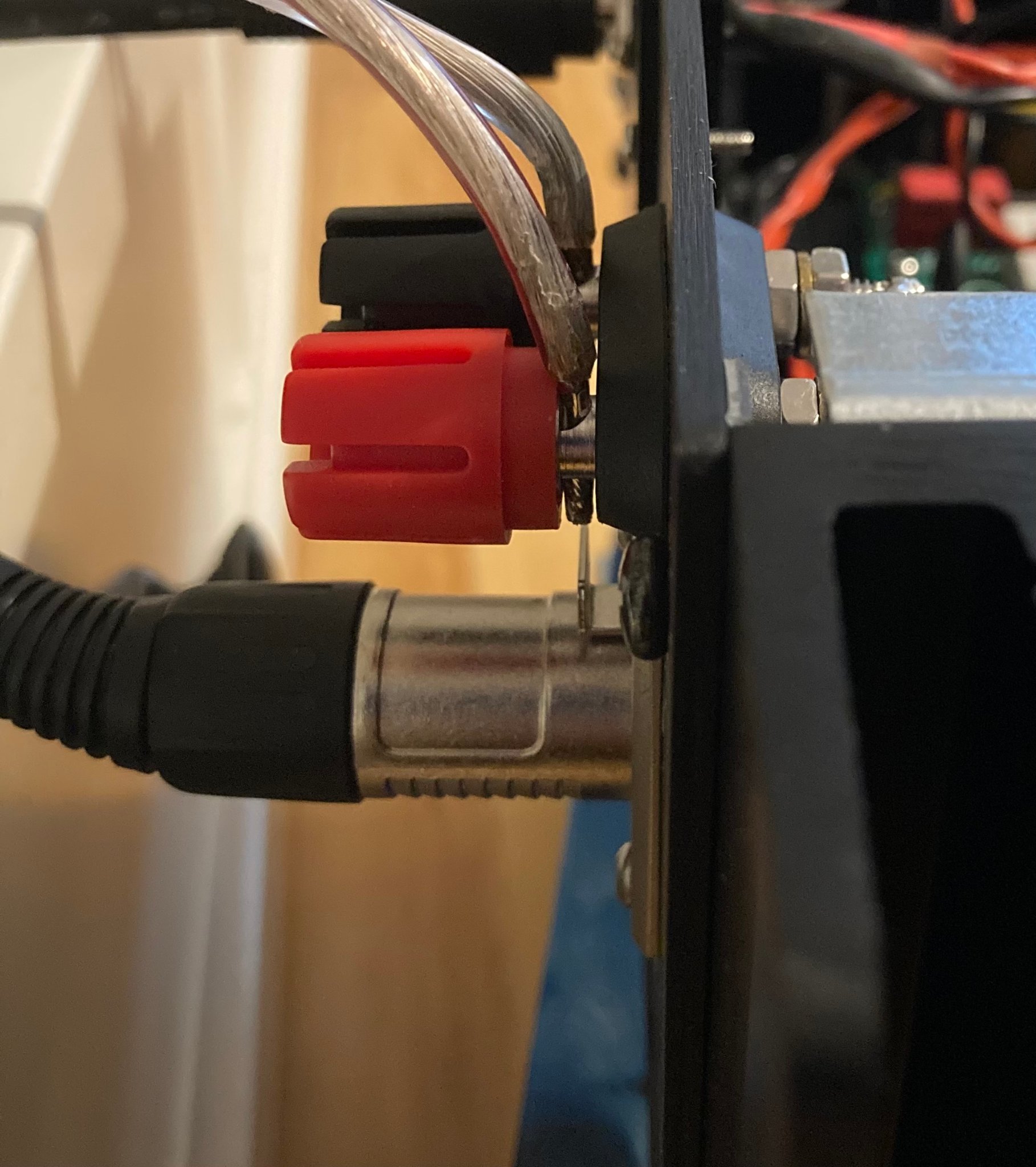

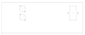

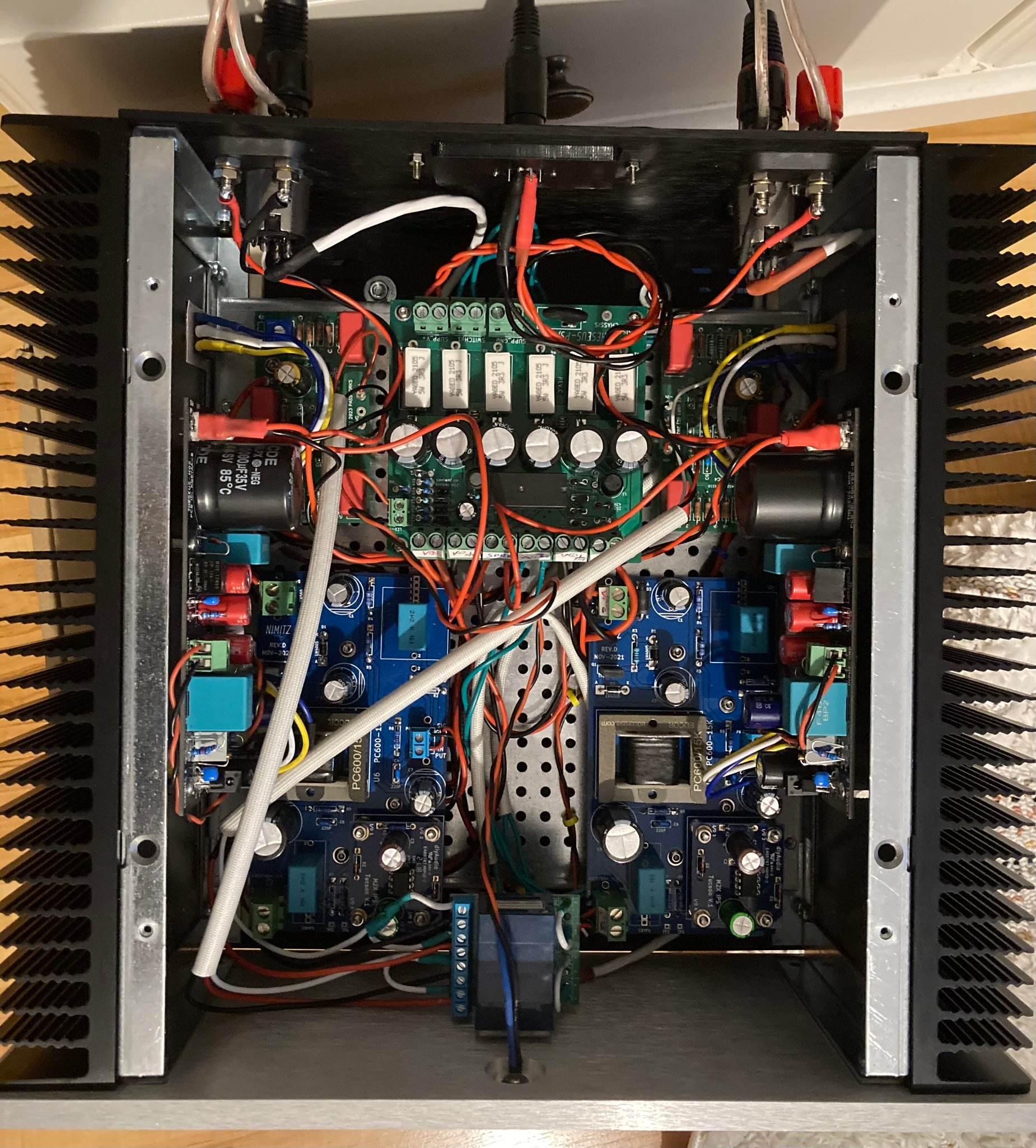

Mini-Dissipante 300mm for an integrated amp (but only 1 input, no switch): Front End 2022 + Ship of Theseus: Front Panel Design files.
*Front panel has a squarish hole for a big switch, hole for volume potentiometer & LED.
*Rear Panel has XLR inputs, loudspeaker outputs, some holes for RCA.

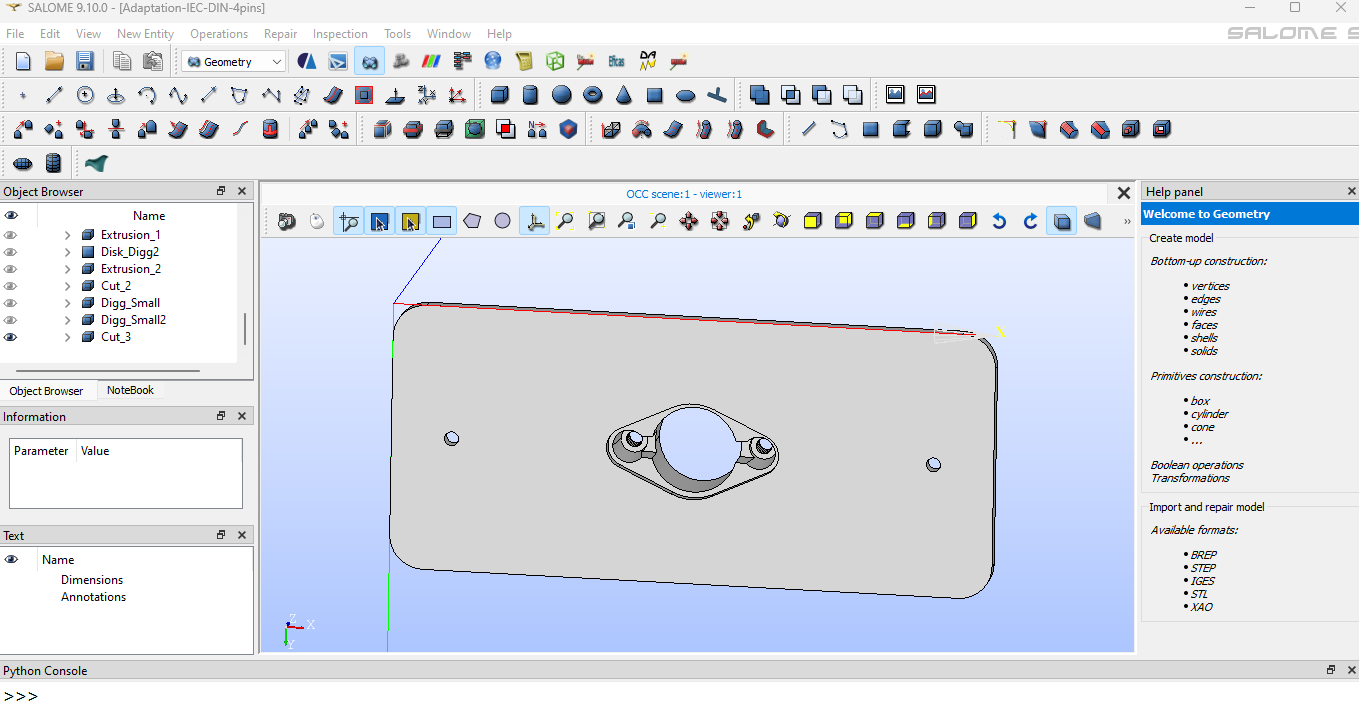

*Hole for power is bigger than necessary for this build = Some modularity for a later First Watt with linear PSU and IEC (instead of the Thesus PSU connection): archive Adaptation-IEC-Theseus-PSU with HDF, STP and STL file (hdf is editable in "Salome platform" Salome 3D Link)
*Issue on the rear panel: louspeaker & XLR connectors should be farther away (see pics)
*Pic for quick assessment, more here DIY audio Link
This is for anybody to use & modify.
