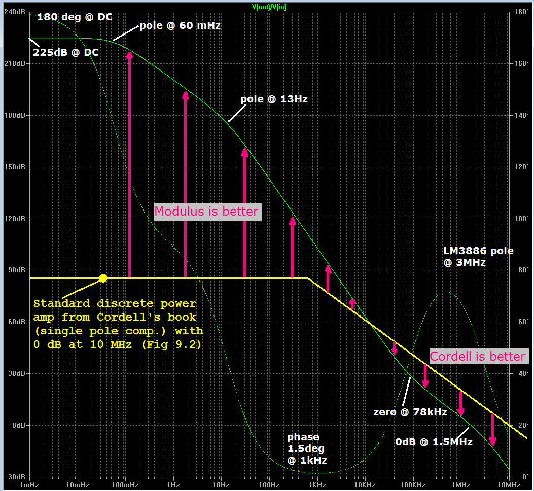

I've overlaid the open loop frequency response of a standard discrete-transistor power amplifier, from Bob Cordell's book p.174. It's in yellow; the modulus-86 is in green. Yellow is NOT a chip-amp, it's a dozen discrete transistors and some passive components, on a printed circuit board; Cordell's book goes into great detail.

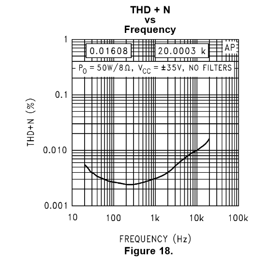

Also attached is a distortion-vs-frequency plot of the LM3886 chip all by itself (i.e. not in a compound amplifier). Its weak zone is from 500Hz to 20kHz; in this region the Modulus-86 provides an extra ~30dB to ~0dB of gain for additional distortion reduction.

Here's the THD+N vs Frequency for the MOD86.
The MOD86 is a good 10x (20 dB) better than the naked LM3886 when it comes to THD+N. More importantly, the MOD86 offers much better PSRR, hence, performs as well on an unregulated supply as it does on a well-regulated lab supply. The performance of the naked LM3886 degrades significantly when it's fed by an unregulated supply. I showed the plot of MOD86 vs LM3886 earlier in the thread.

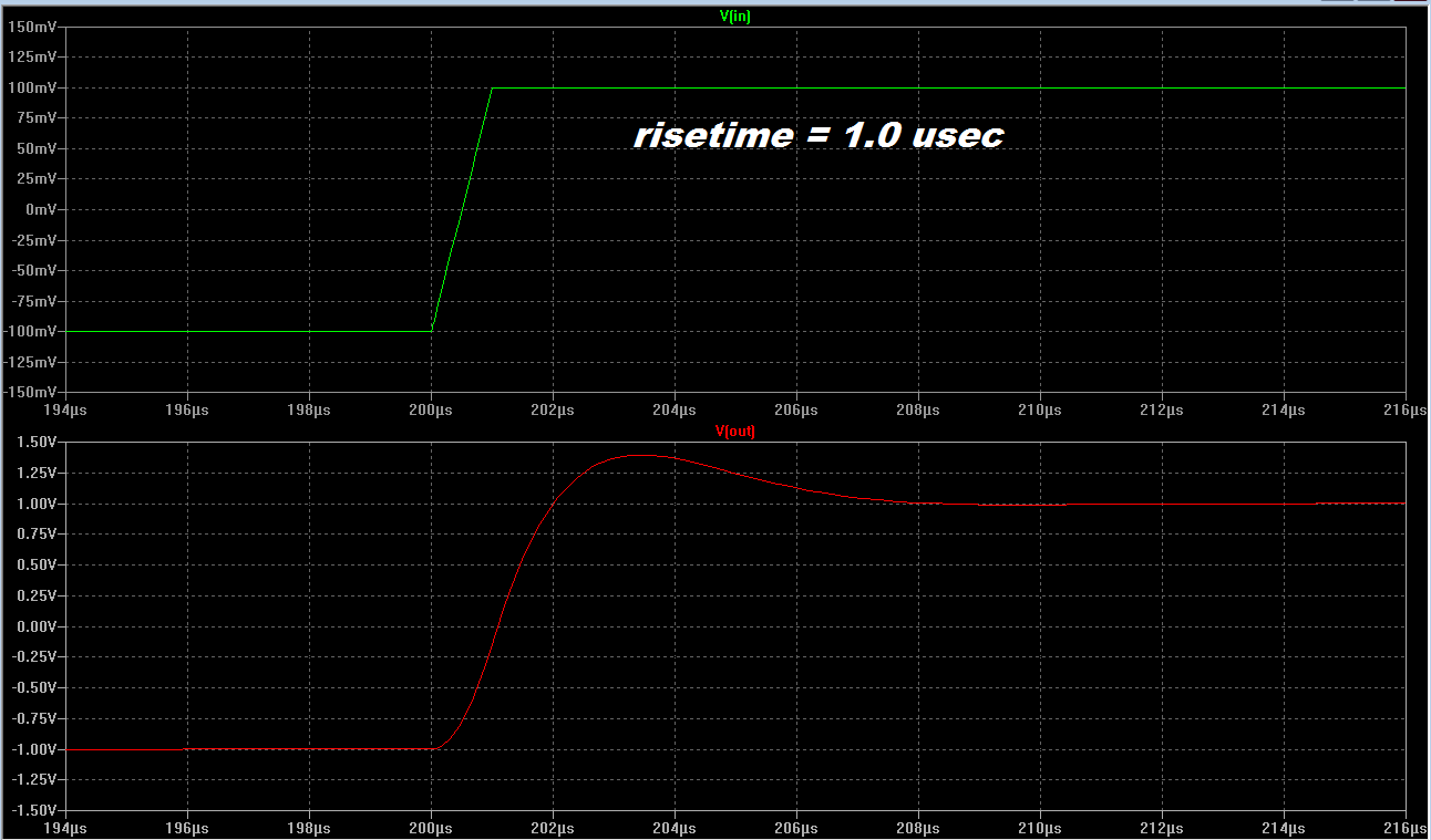

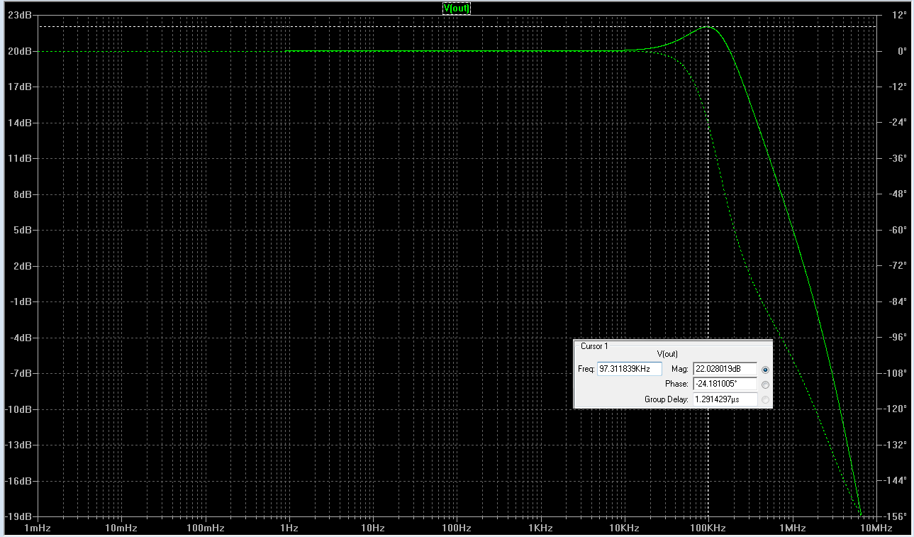

I connected the open loop transfer function plotted in #1392 above, to a feedback network that gave a closed loop gain of 10X (+20dB), just like the Modulus-86. The resulting closed loop amplifier had about 2dB of gain peaking -- see first plot.

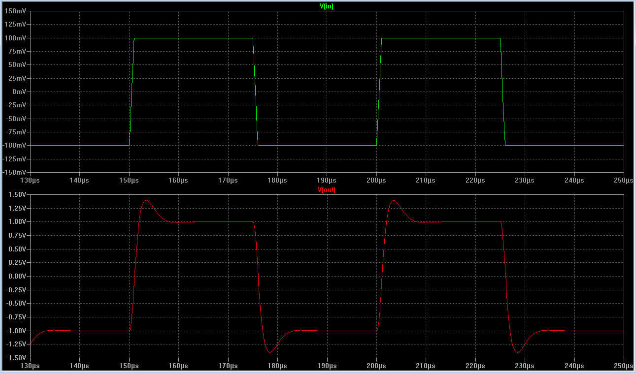

When there's a peak like this in the frequency domain, we expect overshoot in the time domain. (How much overshoot? Cordell's Figure 4.10 on page 91 shows a very nice nomogram). Sure enough, the square wave response does include overshoot -- see second and third plots*. Notice the rather leisurely 1 usec input risetime, much much slower than the upper limit of the rather zippy THAT preamp chip (22 MHz bandwidth!).
I used the diyAudio search engine and I also tried Google, to search for measured oscillograms of the Modulus-86's square wave performace. But I couldn't find a single one. If readers have an actual scope photo of a Modulus-86 square wave response, please post a link. It'd be fun to see how closely this simplistic little poles-and-zeroes linear systems model, predicts the real hardware's behavior.
* and sure enough, they agree with Cordell's figure.

Note that those transient response plots are of the MOD86 R1.0. The transient response of MOD86 R2.0 cleaned that up considerably. R2.0 will drive over 1 uF || 8 ohm with minimal ringing. At more reasonable values of load capacitance, there's no ringing at all on the response. I'll see if I can dig out the scope shots.
Tom
