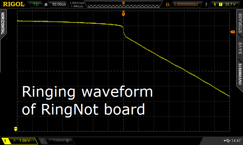

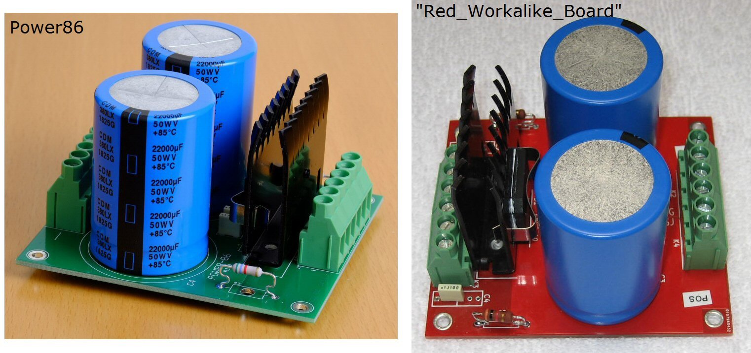

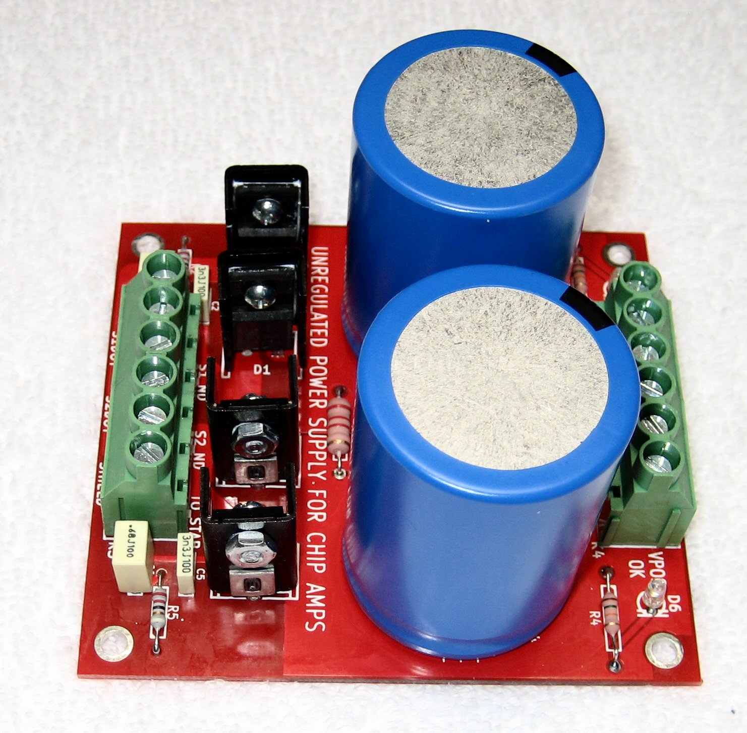

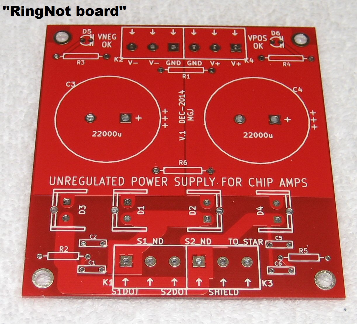

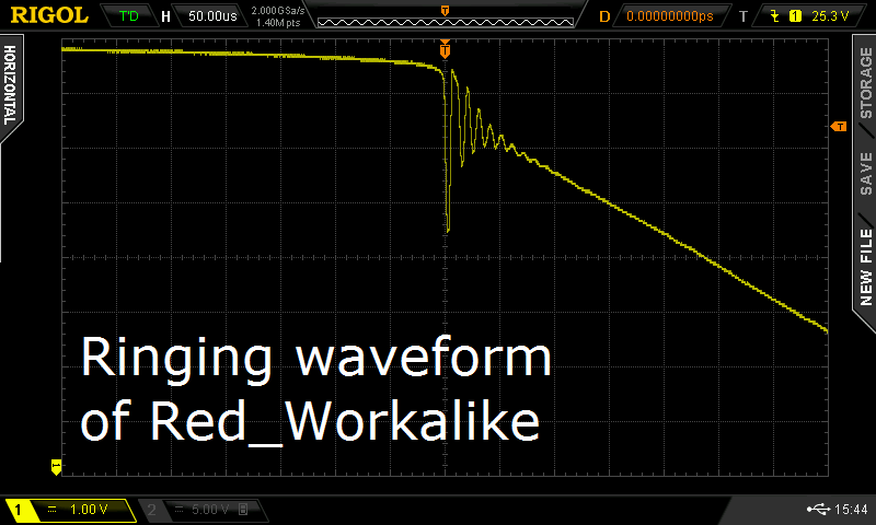

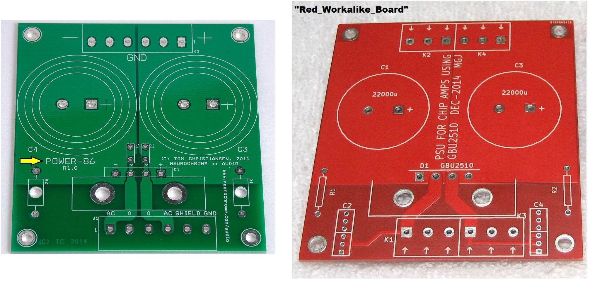

I suggested installing full CRC snubbers into the Power86 back in December 2014 (post#408) but tomchr decided against it. The design and PCB layout of Power86, pictured on the sales website, is simple and straightforward, so I was dismayed (post #539) by its rather high sales price: USD 50.00. I pointed out that hobbyists could lay out their own Power86-like PSU boards and get TEN boards of their design fabbed, for less money.
So ... that's what I did. In Phase 1, I designed and layed out and sent to fab, a Power86 PCB work-alike board. Same simple cicuitry, same components, same full-ground-plane layout, same big honking topside copper "pours" for VPOS and VNEG. It's shown in Figure 1 below.
At left is the photo from the Power86 website; on the right is my work-alike board (red laminate). When the components are stuffed and soldered, the result is Figure 2. You can see that the Workalike board uses the same connectors, same bridge rectifier with same Aavid heatsink, and the same Cornell Dubilier capacitors.
Then, in Phase 2, I upgraded the circuit design. I added 30 Ampere Soft Recovery Diodes, and full CRC snubbers for each secondary. These completely eliminate any and all oscillatory ringing in the transformer secondary. The Phase 2 board design, called RingNot, is shown in Figures 3 and 4 below.
As expected, the RingNot board has completely eliminated all oscillatory ringing in the transformer secondary (Figure 6). The Power86/Workalike board (Figure 5) does not perform nearly as well. Why live with this kind of unwanted ultrasonic ringing junk when you don't have to?
I'm giving away the Phase 2 design and the layout and the Builder's Guide and the PCB Manufacturing "Gerber Files", for free. Just search diyAudio for RingNot, you'll find them. Send the Gerbers off to a PCB fab and away you go! I provide three full BOMs for the three most popular distributors.
I built quite a number of these boards myself, sourcing parts from DigiKey. I've got some leftover bare boards that I'm getting rid of, at my cost ($15 to $6 depending on payment method). I've also got some fully populated, soldered, assembled + tested, finished power supplies that I'm also selling at my cost ($50 to $33 depending on payment method). Search diyAudio for RingNot to see the whole shebang.
Tomchr still sells the bare Power86 PCB for $50.00. But now you've got additional options. Bare RingNot PCB for $15.00. OR complete RingNot supply, assembled and tested, for $50.00. OR send the Gerbers off to fab and get ten RingNot bare boards for about $40; use one and give away or sell the others. It's pleasant to have options.
