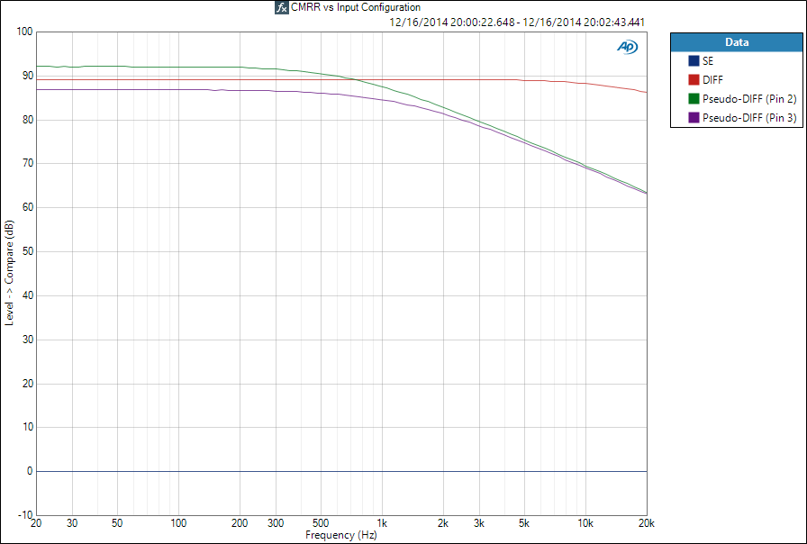

So... I figured I'd quantify exactly how much common-mode rejection ratio (CMRR) is lost by using pseudo-differential connections and by using a pure single-ended connection. See attached.
The single ended (SE) configuration corresponds to bypassing the THAT1200 entirely. That's the blue line at 0 dB (no CMRR). This is exactly the same as any other single-ended amp.
Pseudo-differential (Pseudo-DIFF) shows a dramatic improvement in CMRR. The CMRR plot assumes a 10 Ω imbalance between the (+) and (-) pins. The CMRR below 1 kHz is comparable to that of the true differential (DIFF) connection. Above 1 kHz, the CMRR rolls off quickly when using a pseudo-differential connection
It appears as if the CMRR is actually better when the (+) input, Pin 2, has higher drive impedance than the (-) input. That I believe is an artifact of the measurement. I'll need to analyze this in greater detail, but I bet the gain changes slightly when the 10 Ω imbalance is introduced. This results in a slightly lower common-mode component on the output of the THAT, which in turn is measured as a lower voltage on the MOD86 output, hence, is interpreted as a higher CMRR. The opposite is true when the imbalance is on the (-) input, Pin 3.
The true differential (DIFF) connection shows the best performance with nearly 90 dB of CMRR across frequency, rolling off to 87 dB at 20 kHz. This is truly stellar CMRR performance an is the main reason I included the THAT1200 in the design.

The plot shows the common-mode rejection. It shows how much the common-mode noise will be attenuated by the Modulus-86 amplifier. If the input wires are tightly coupled (twisted pair microphone cable, for example) the noise injected on the cable will be (mostly) common-mode, hence, rejected by nearly 90 dB by the Modulus-86 when using the differential input. Even when using a pseudo-differential connection, there is significant noise rejection.
For any amplifier with a single-ended input there is no rejection at all. That's represented by the blue line at 0 dB in the plot.

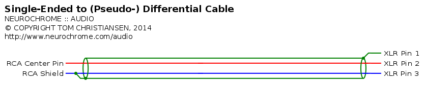

Attached figure shows the connections for a pseudo-differential cable that can be used to connect the Modulus-86 to a single-ended source. You can find a link to a commercially available cable a few posts back.

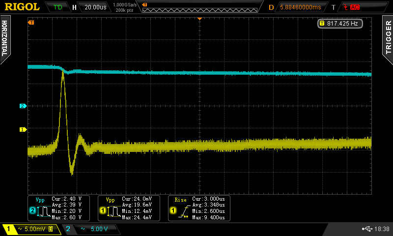

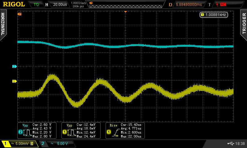

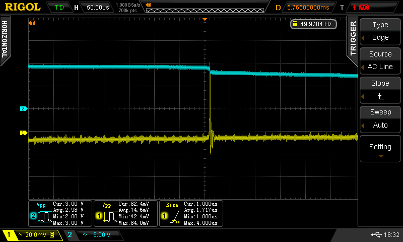

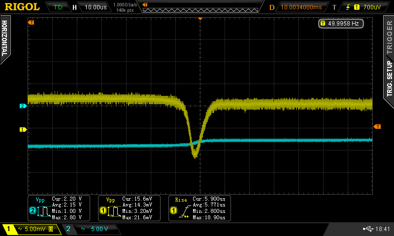

What I do is put across the secondary, a small cap like 4.7nF, and a 100nF in series with a 1k pot. I connect the scope to the secondary through a highpass (like 100pF/10k) which removes the mains frequency, turn the pot until the ringing is damped, and replace it with a fixed resistor. Works very well and simple to do...
Scope shots (in that order) are : no snubber, pot too low, pot too high, just right.
