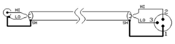

Thanks Andrew! Here's the link to Jensen's AN-003: http://www.jensen-transformers.com/wp-content/uploads/2014/08/an003.pdf
I would say that if your source has single-ended out, build the adapter cable shown in Figure 2.1. With a 0 ohm output impedance, the difference in impedance between the shield and the center conductor will degrade the CMRR performance slightly. This is still orders of magnitude better than omitting the THAT1200, which will give you 0 dB CMRR...
A better solution would be to add a differential output to the source. Figure 2.4 in the Jensen app note would be a simple way to accomplish this. A better way would be to use a THAT1606 or THAT1646.
I've been staring at figure 2.1 for a while now and it just isn't making much sense to me at all. Typical shielded coax only has two conductors. At the unbalanced output end, the diagram shows both the signal and ground of the jack connected to the center conductor (short?!) of the cable, but also the ground of the jack is connected to the shield of the cable. How is this even possible? I've shorted the ground and signal conductors of coax before and the result is pretty unpleasant.
Then at the balanced input end, it shows both a hi and lo signal popping out the center conductor. Magic?
P.S. Please forgive my ignorance of electronics. Some stuff is very intuitive for me, but this scenario certainly isn't.
Two words: Microphone cable...
It contains two conductors and a shield.
An easy way to build the cable shown in Jensen's app note is to buy an XLR patch cord, lob off the female connector, and solder an RCA connector on the cable following Fig. 2.1 in AN-003.
