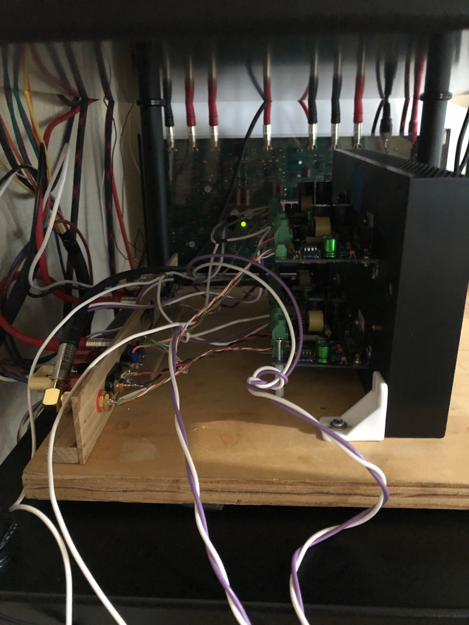

I have a pair of Linkwitz Orions that need 8 channels. I’ll use the Modulus 86’s for mod’s /tweets and Class d for the bass bins.

Finally have 4 channels powered up running mids & tweets. Class d monoblocks on the bass bins.
Simply sublime. The Modulus 86’s driving the tweets was icing on the cake. Jim Morrisons voice is now sweet and smooth just as Jethro Tulls. I’m tongue tied. I’ve had a lot of amps over the years.
Up until yesterday I was just using 2 channels driving mids.

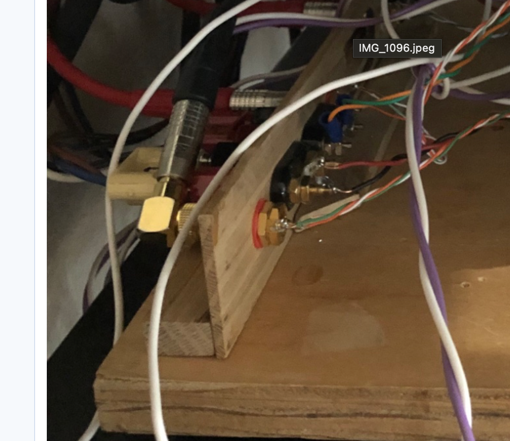

Breadboards a mess but it works. Silent as a graveyard when it’s supposed to be.
Thanks Tom
Reactions: rockies914
Once I get a PS figured out that’s small in stature I’ll find an suitable enclosure and put together interconnects that are long enough so right angle rca’s are not needed.

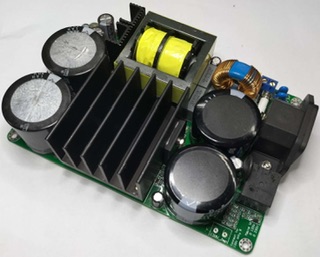

I’m using 2 Meanwell SE 600-36 powersupplys configured for -/+. I can only dial them down to 33.4vdc. I need to get closer to 28vdc. My speakers are 6.40hm.
I also want/need/think I should have speaker protection. I get a pop on power up. Voice coils can be hard to come by.
