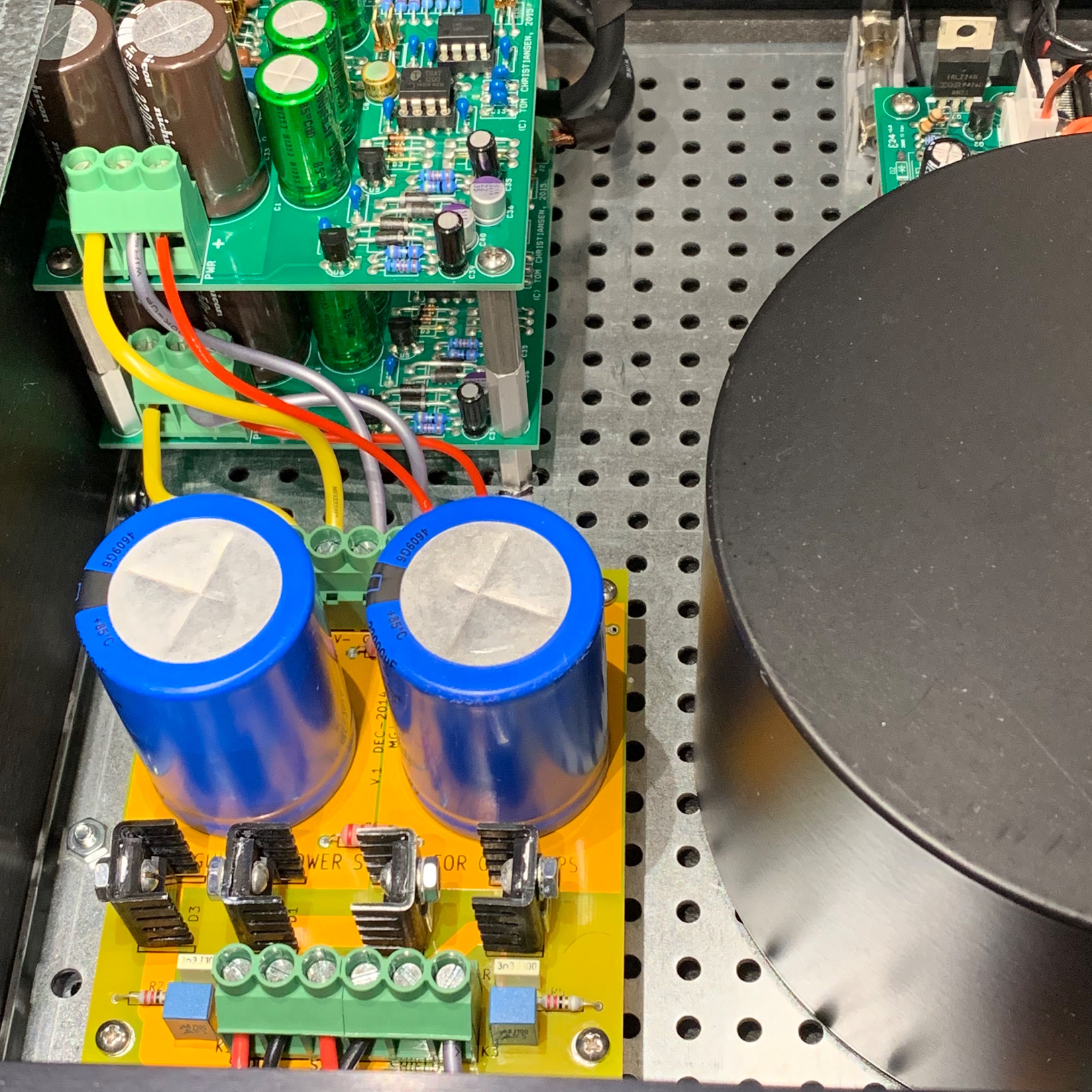

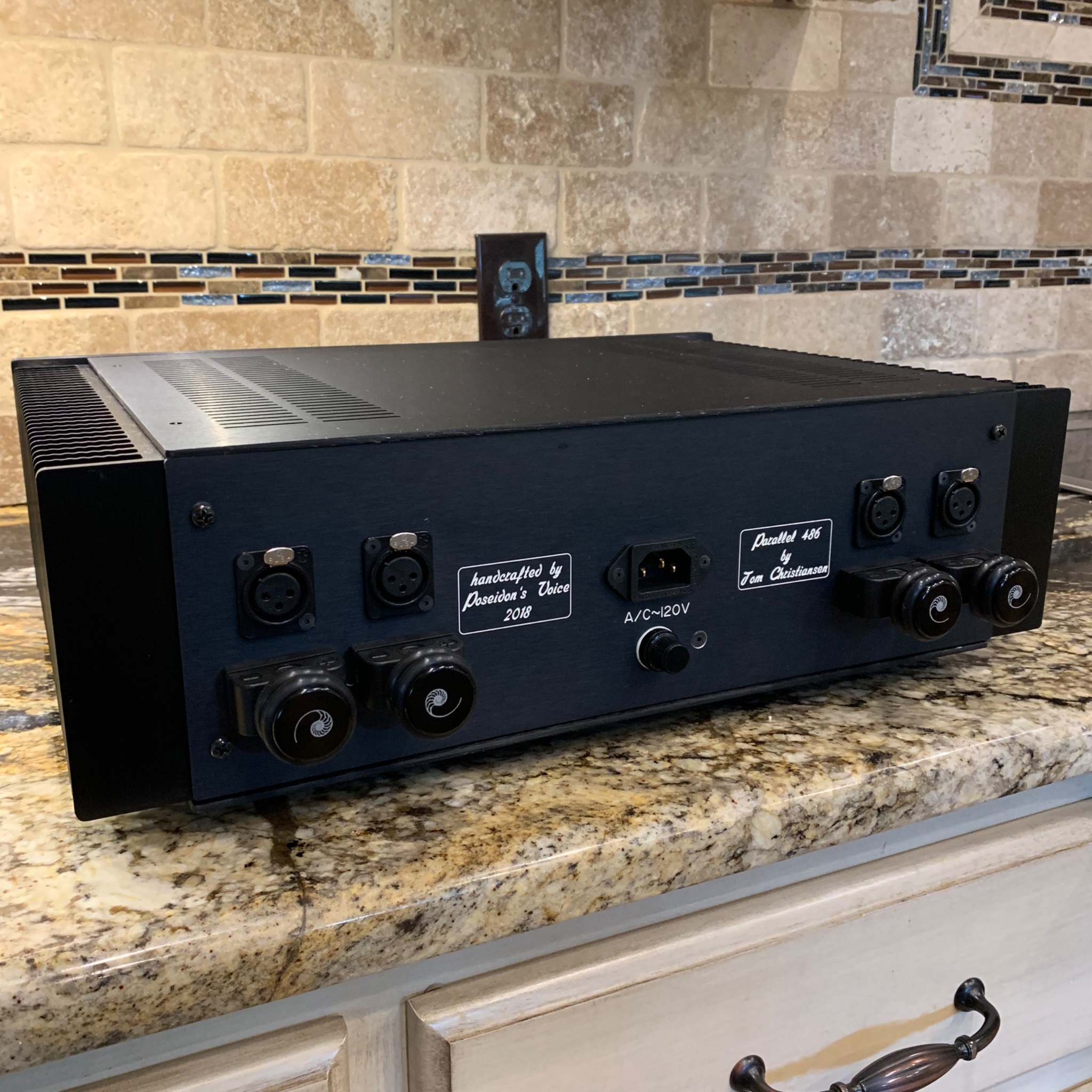

An idea I implemented years ago for an older design called the Parallel 86. See attached. It’s fine in regular music use due to the crest factor but I wouldn’t challenge it with long bouts of sine wave testing.

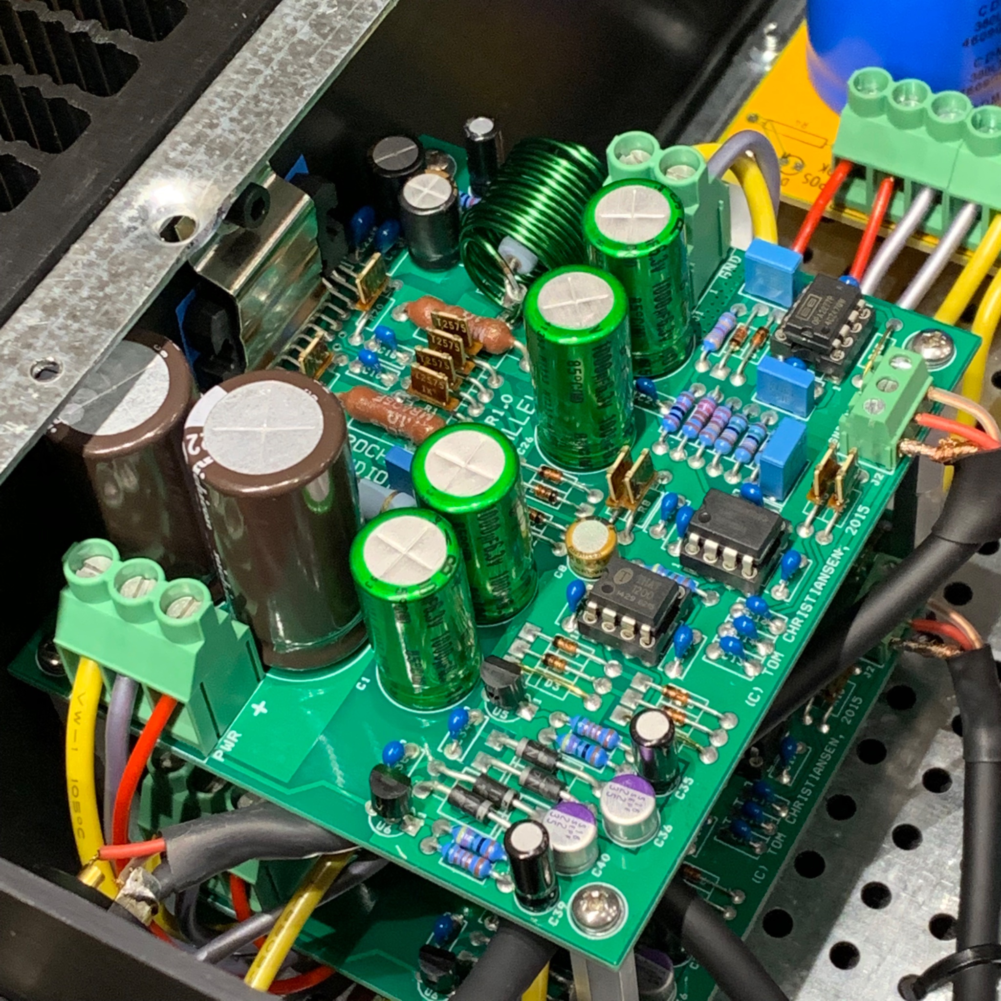

LM3886 typically doesn't need a whole lot of heat sinking (compared to the class A amps in the diyAudio forum), so the use case affects what's 'better.'
My Modulus86 has modest heatsinks with Keratherm, and the sinks barely warm up.
There's a lot of thermal mass in those heat sinks. Using two channels of Parallel-86 on the same heat sink would probably take the better part of an hour to heat up the heat sink enough that you'd need to be concerned about reaching the thermal limits of the LM4780.
Is ceramic a better choice?
Maybe. Check the data sheet. They might offer lower thermal resistance, so that'll make the LM3886 run cooler, which I'm always in favour of. But as noted by others the heat sinks in a 2U x 300 mm chassis barely get above room temperature even after a long, 'spirited' listening session, so obsessing over thermal pads seems to be a case of gilding the lily.

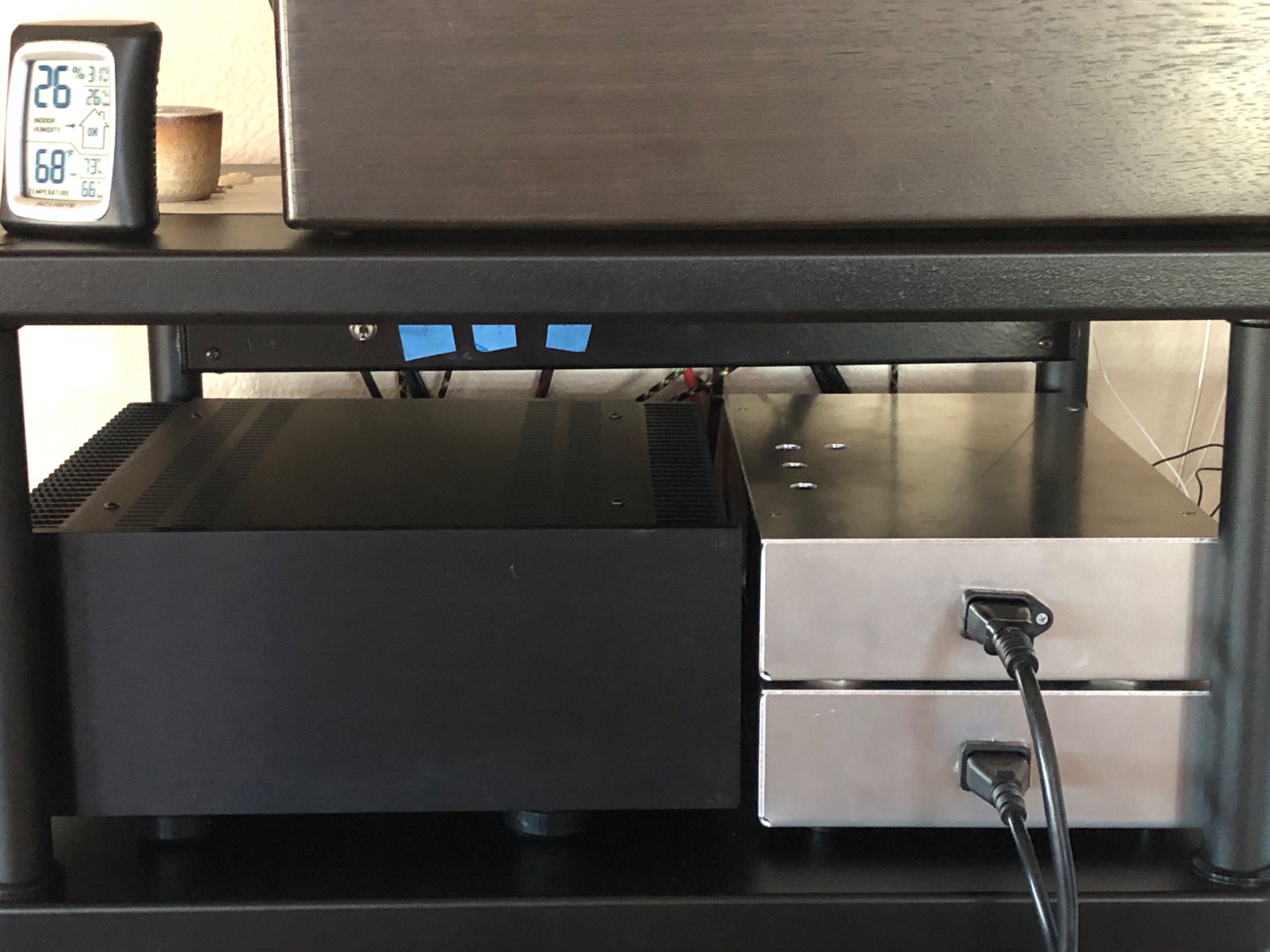

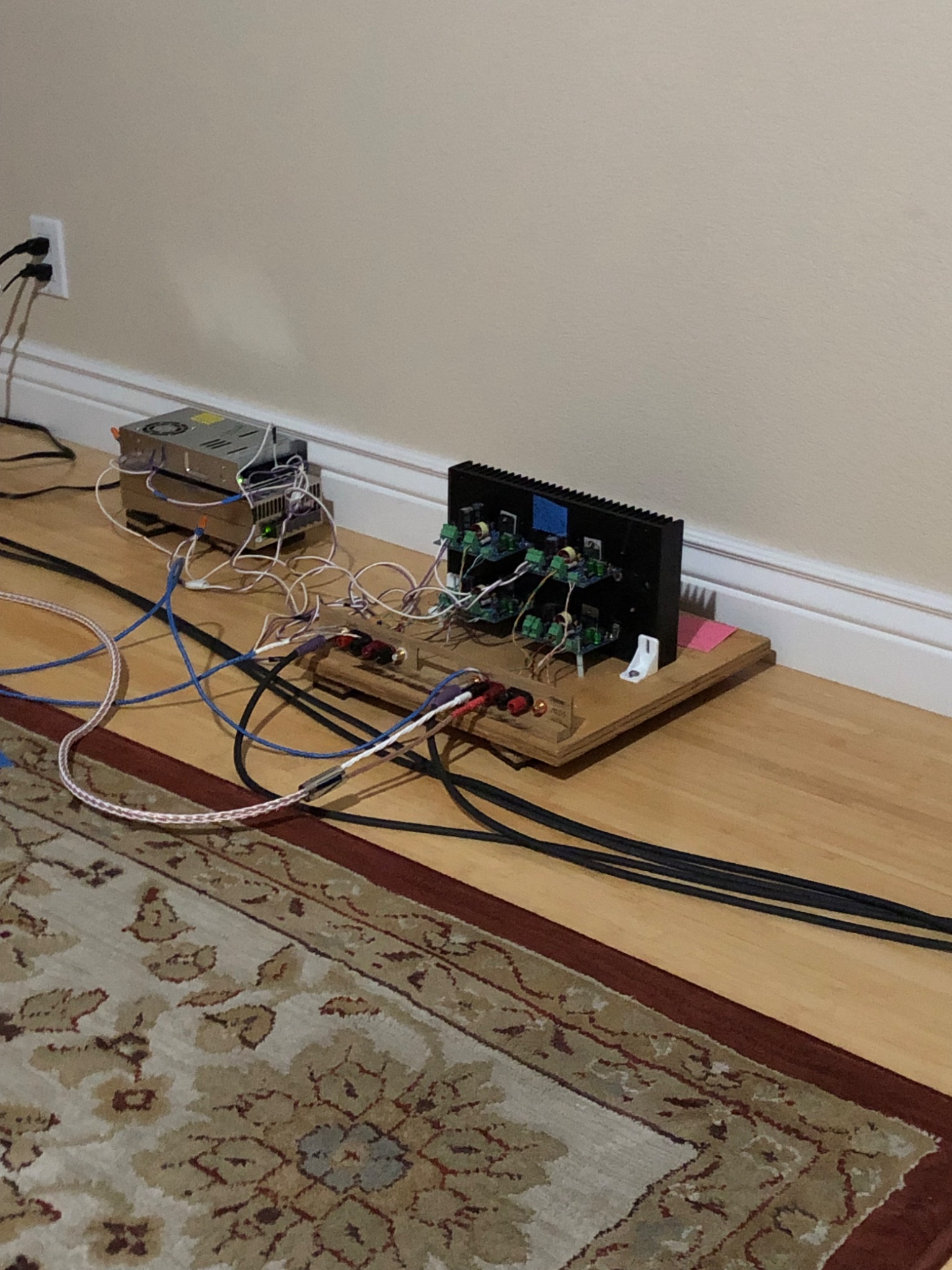

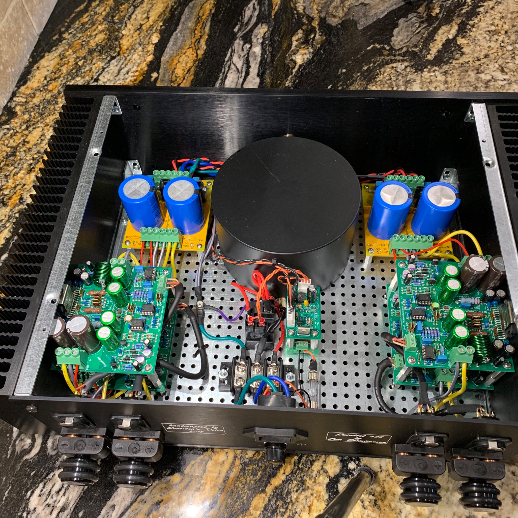

Isn't one of those supplies an SE-series? Unless it's modified, that means it has a rather loud fan in it, which further tells me that it's a temporary solution. The plywood plinth is a pretty good indicator too, but I'm not here to judge. Perhaps we can forgive the use of different SMPSes in a prototype setup. 😉

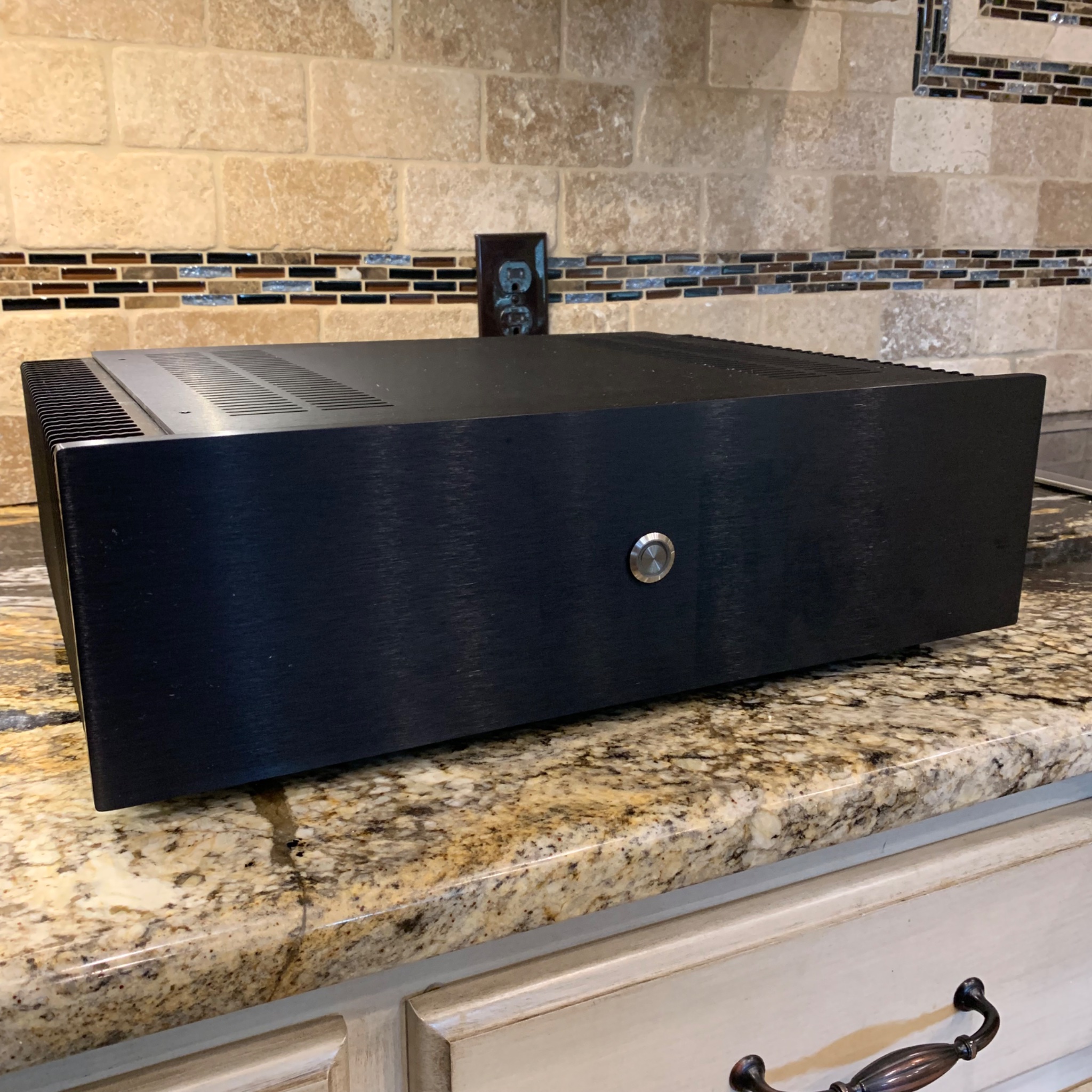

3U arrived. Waiting for stand offs. Local hardware store had none. Drill press is out, bits at the ready. I need a smaller tap handle.
PS will be a Connex 800Re -/+32vdc. This unit has a built in soft start along with a few other bells & whistles. Hoping it alleviates my turn on/off pop.
Wish me luck.
