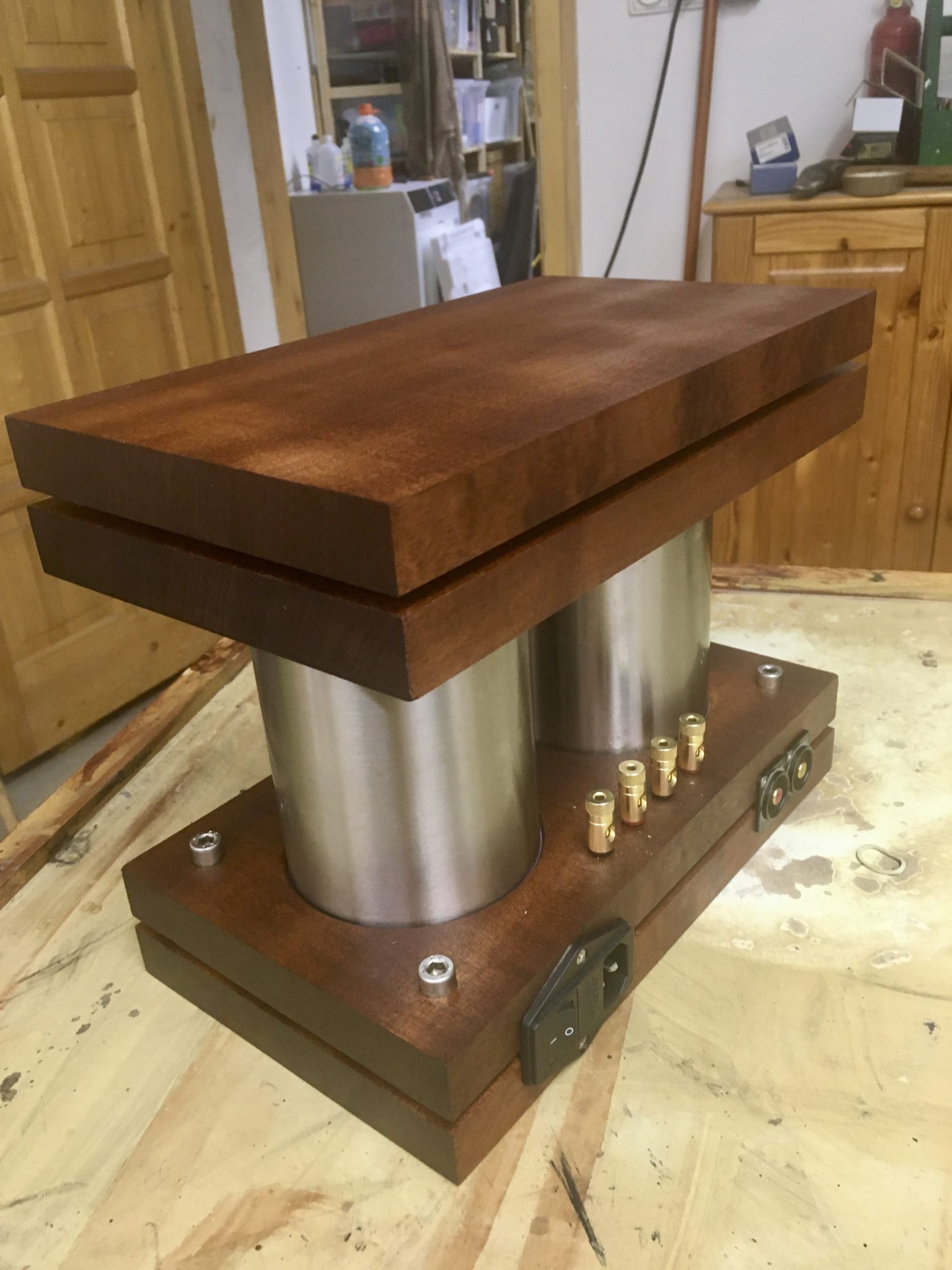

I will have a separate PS for each channel, so each PS sees a mono amp. So 4700uF seems enough, right?
How about the ±34V for the rails? I have the transformers with the chassis, so I can not really change that. Is it gonna work?
The chassis is from a gainclone project I made years ago. It's for two monoblocks in 100mm stainless steel tubes. It's a surprising design, and a bitch to work with.
That's a really neat design, though. What are you doing for the heat sink?
±34 V is a bit high as it would be for any other LM3886-based amp. But with the smaller capacitors in the power supply you'll get more droop at higher output power, so it could work okay. The tradeoff there is that once you push past ±32 V with a 4 Ω load the LM3886 will start to engage some of its internal protection circuits on the signal peaks. So the maximum undistorted output power with ±32 V is about 70 W if I recall correctly. But with ±32.5 V it's around 30 W. I recommend ±30 V to have some margin for mains voltage variations and such.

Thanks. For heatsink there is an old CPU heatsink inside, and I would add a fan. There is an air gap between the wooden planks and around the transformers. I wouldn't want to ditch the 2x24 transformers but it also seems like a bad idea to build an amp for world class distortion levels and then overdrive it with rail voltage, doesn't it?
I certainly see it that way. 🙂
A CPU cooler makes sense. They can move a remarkable amount of heat.

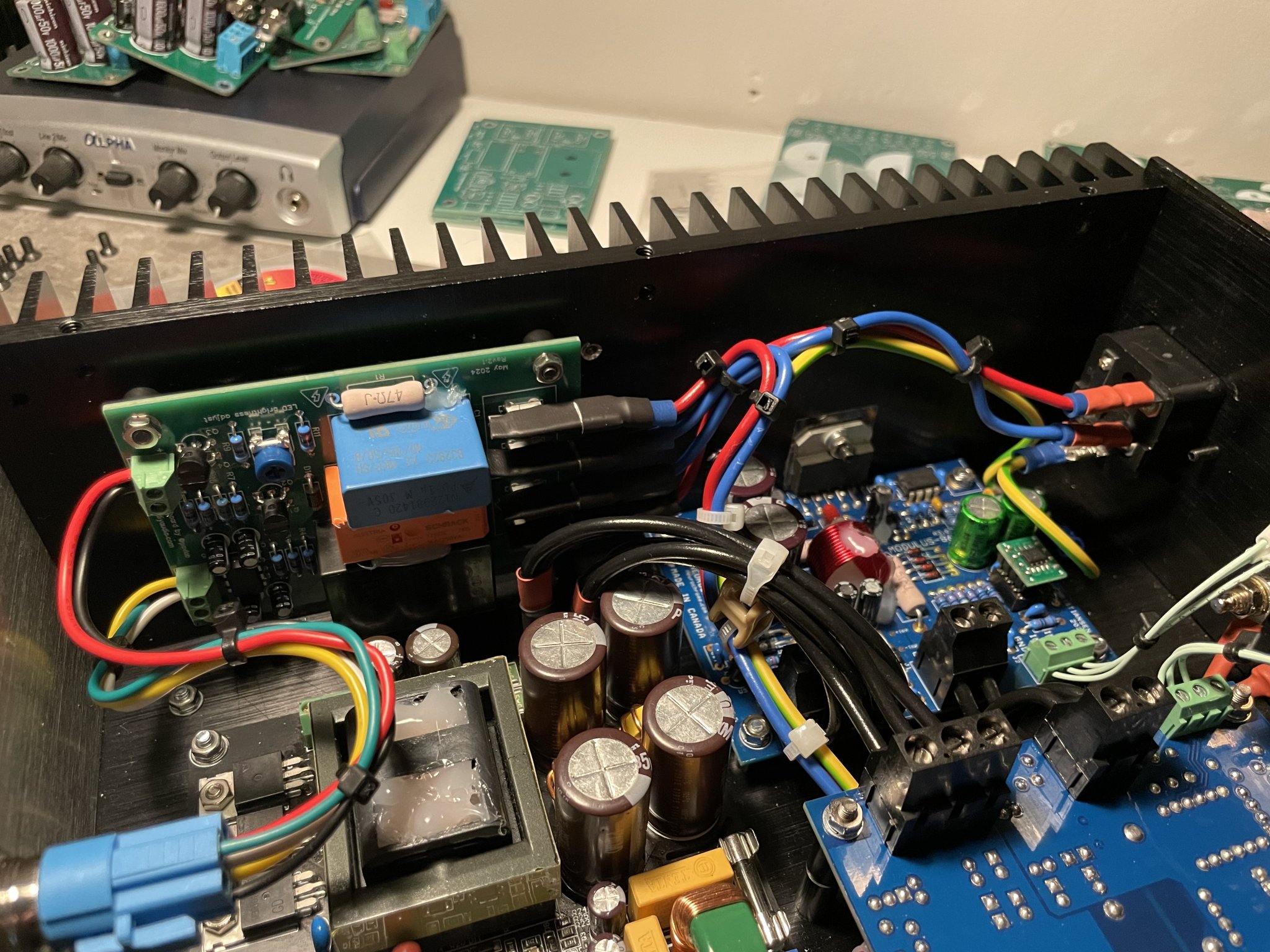

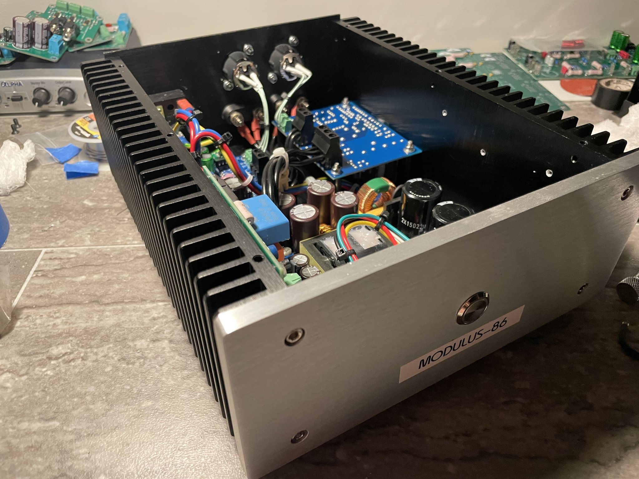

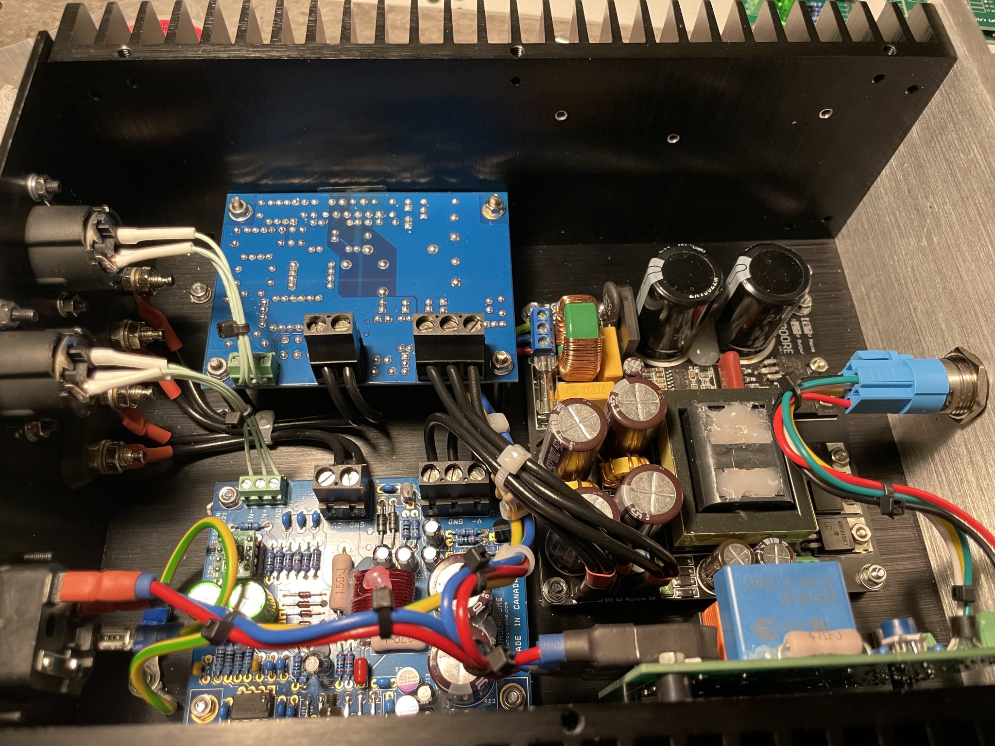

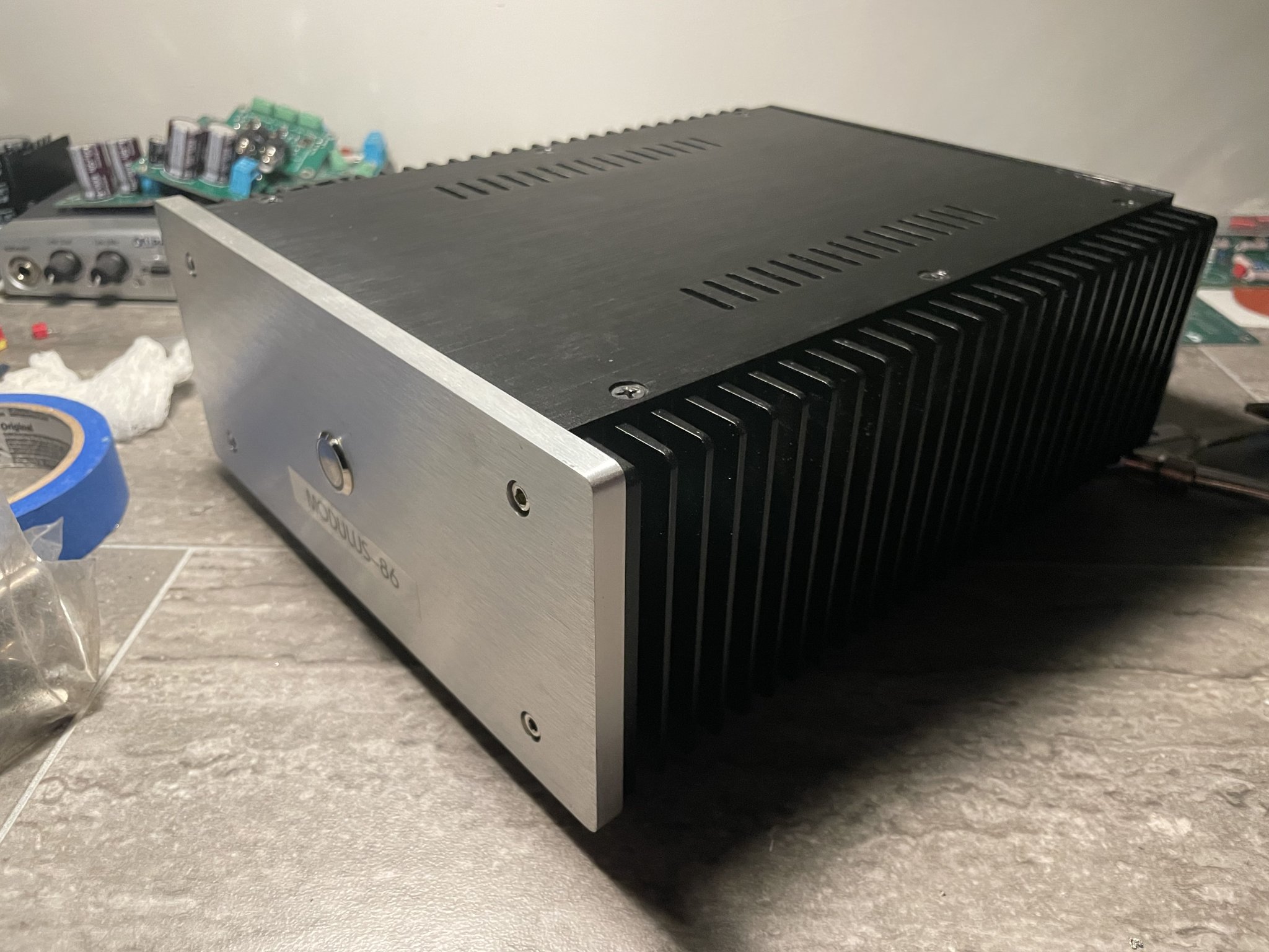

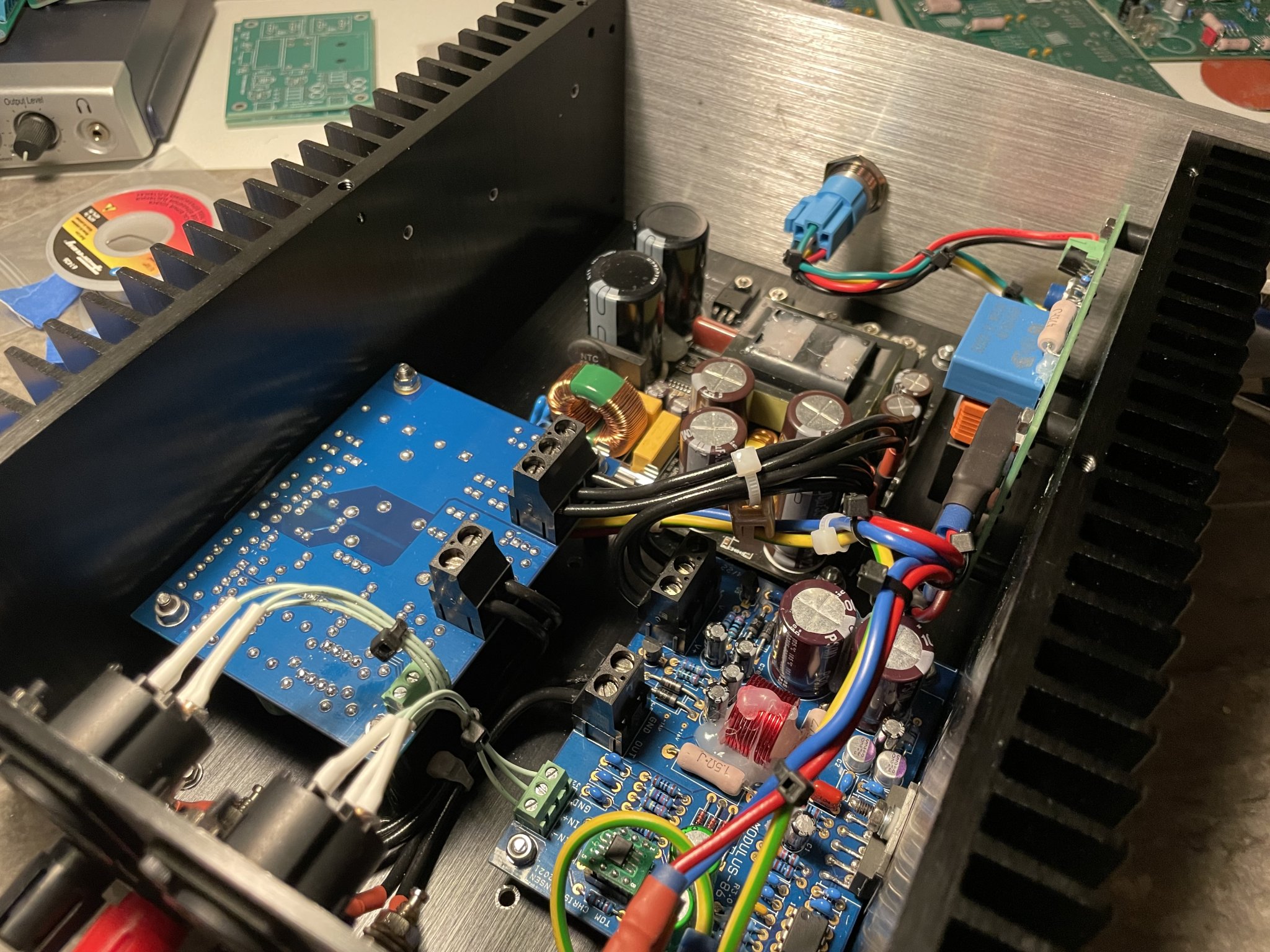

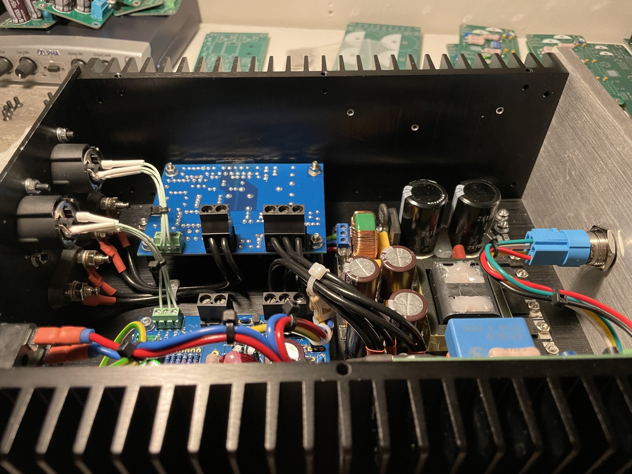

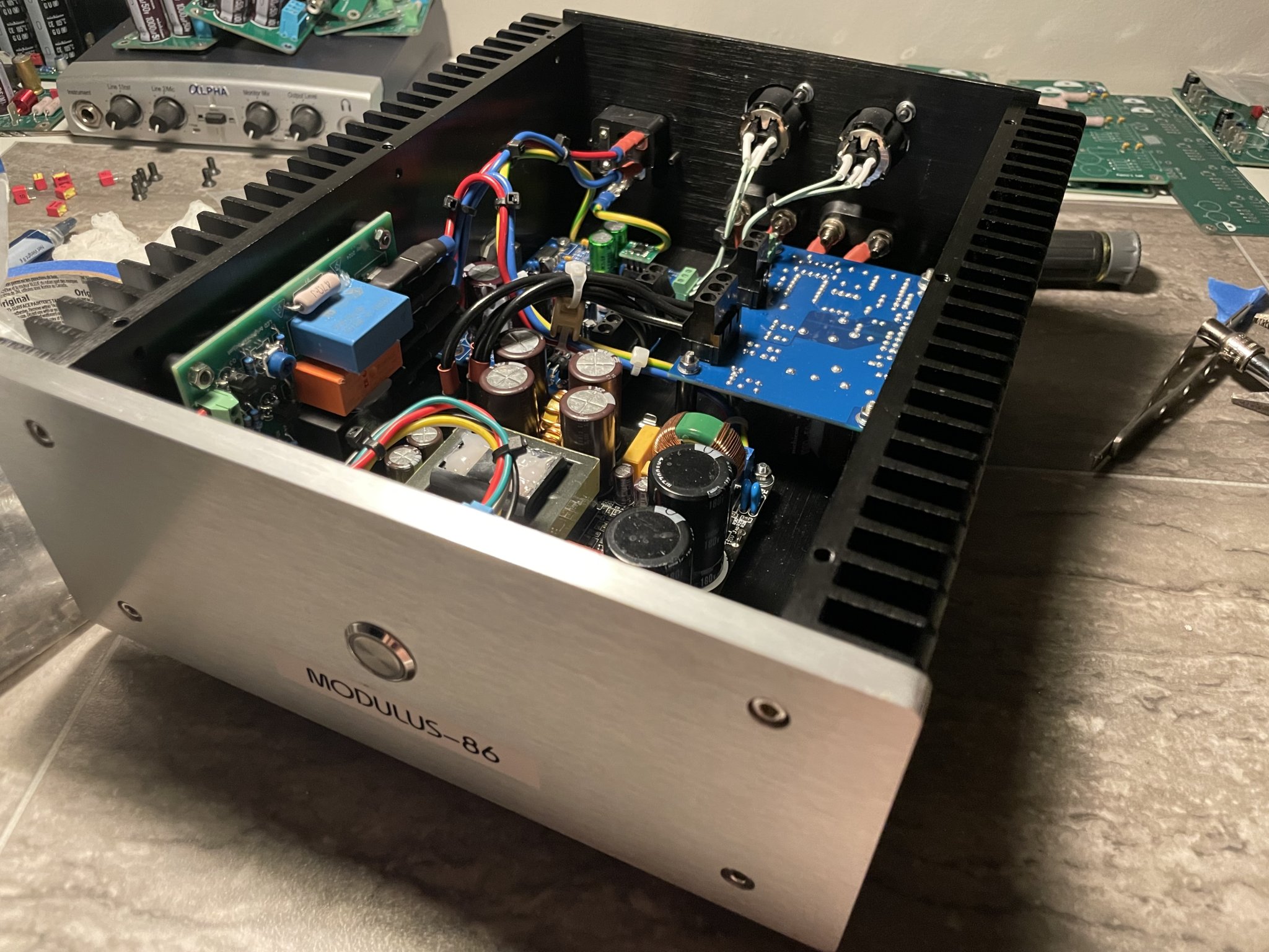

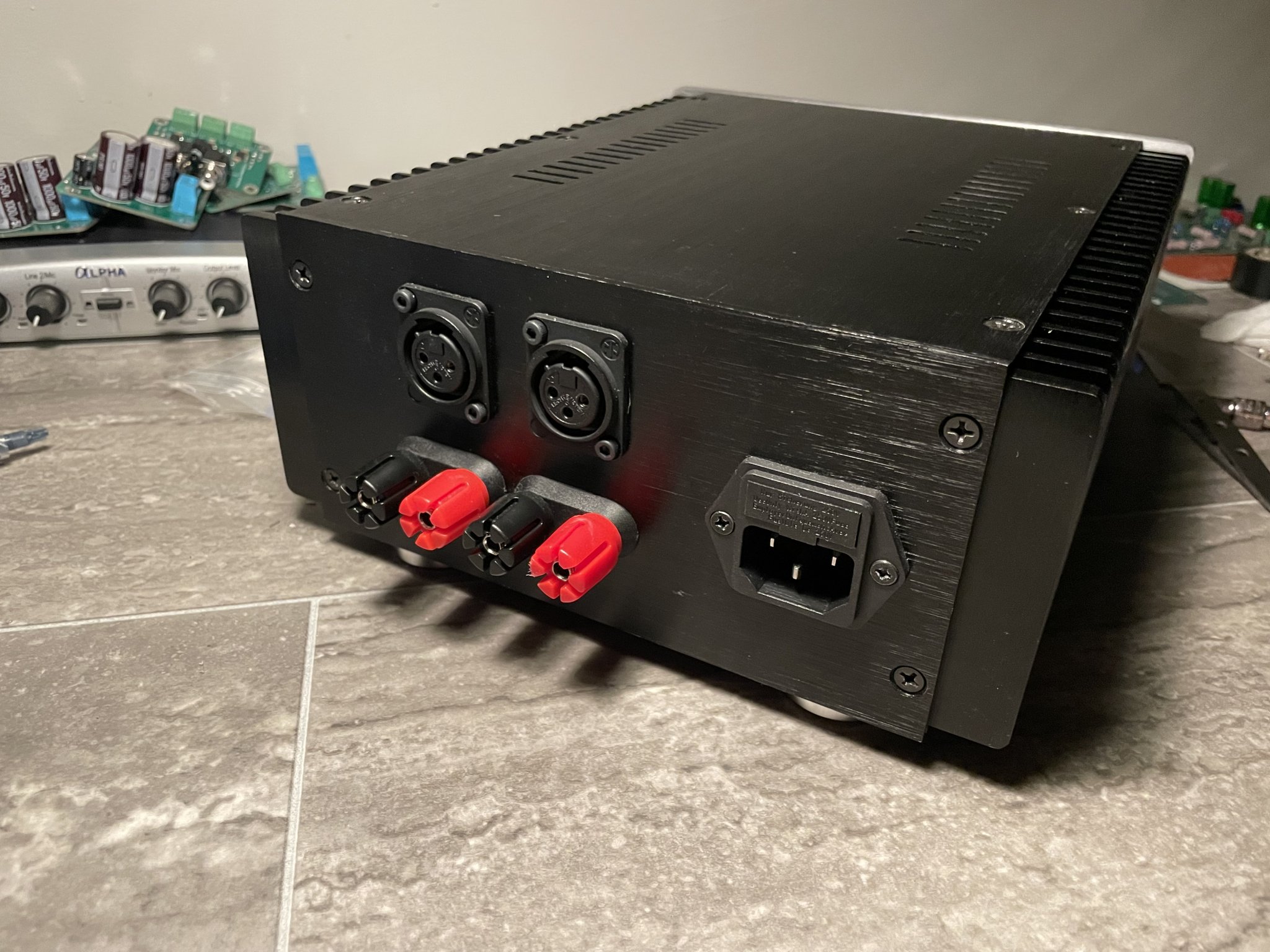

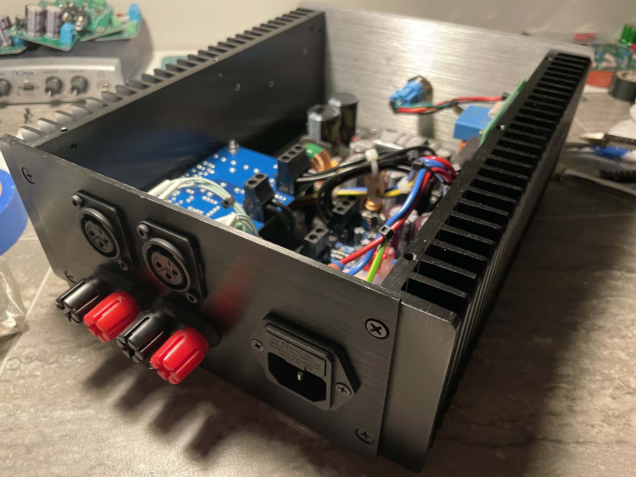

Finally fully finished my Modulus 86 build! I was able to fit it all in a nice compact case (BRZHIFI BZ2109) 210x90x250. Boards are mounted symmetrically - meaning one is flipped upside down. Allows for nice short wire runs.
Added board that switches power on and off using NE555 and relay. Anti vandal switch with ring LED looks solid.
Input buffers are OPA1656 - I like how they sound. Can be switched back to LM4562 easily since I have DIP sockets installed.
Overall very detailed amp and most important for me - it sounds “musical”!!! while THD is 0.0002 or so!

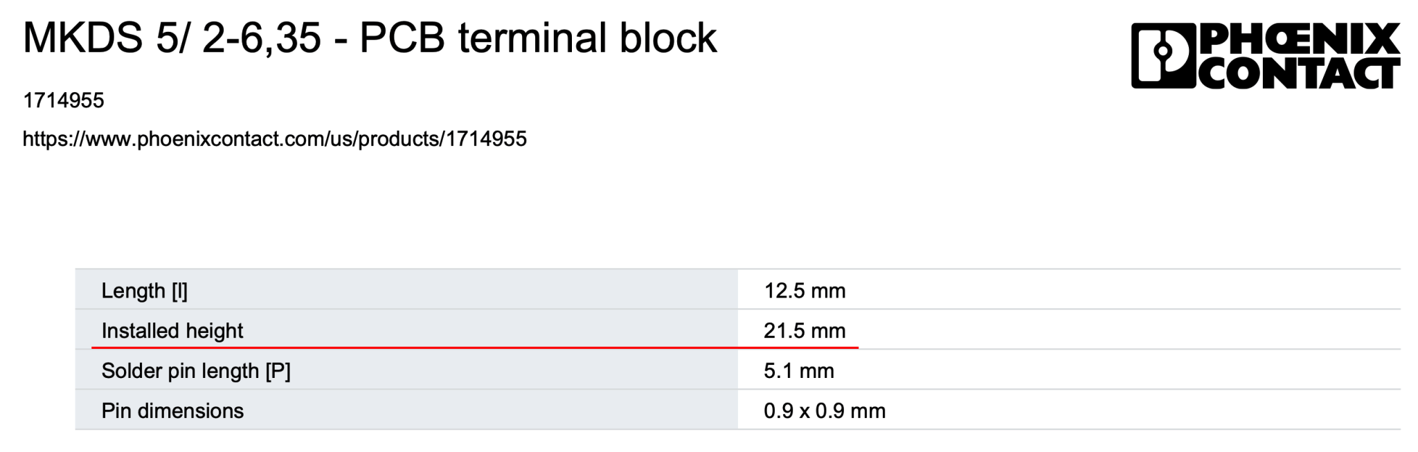

The connectors for the power supply and output are 21.5 mm in height.

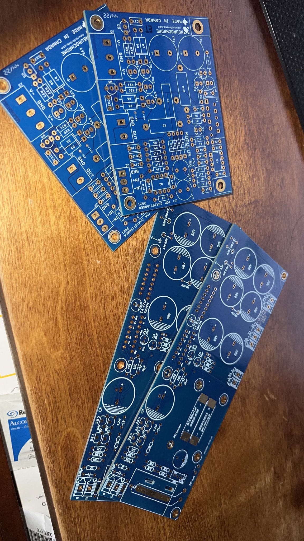

I ordered the boards and checked the BOM. The power connectors you picked are actually 26.6mm tall. I need to replace them with Molex.

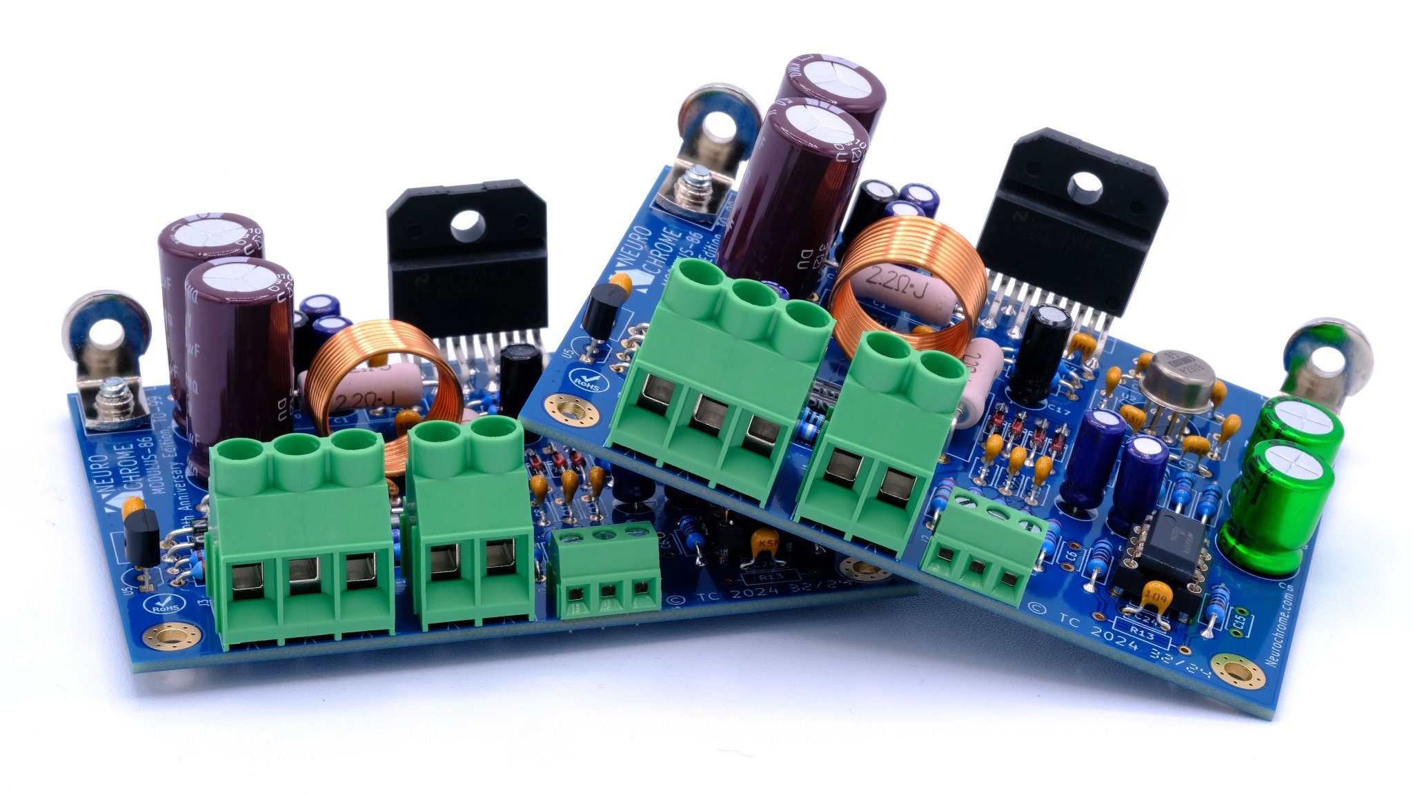

To celebrate ten years of Modulus-86 I designed something truly unique and special. The PCB was redesigned from the ground up. And unlike all my other circuits, the 10th Anniversary Edition of the Modulus-86 uses one unobtanium part, the OPA627 in two DIY-friendly package options: The TO-99 metal can and DIP-08. The OPA627 is very well regarded in audio circles, but current production parts are only available in surface mount, which turns off many DIYers. So when I came across a stash of NOS OPA627 in TO-99 and DIP-08 I knew exactly what I'd use them for. They were not cheap, but I believe they were worth it in the end.
The 10th Anniversary Edition is a drop-in replacement for Rev. 3.0 of the Modulus-86, making upgrading a breeze. Compared to Rev. 3.0, the 10th Anniversary Edition features a cleaner transient response and a smidge higher output power, especially with a 4 Ω load.
Because it uses rare parts, the 10th Anniversary Edition will only be available as a limited edition stereo kit. I have 25 kits available with the TO-99 and 65 kits with the DIP-08. Once they've sold there will be no more.
