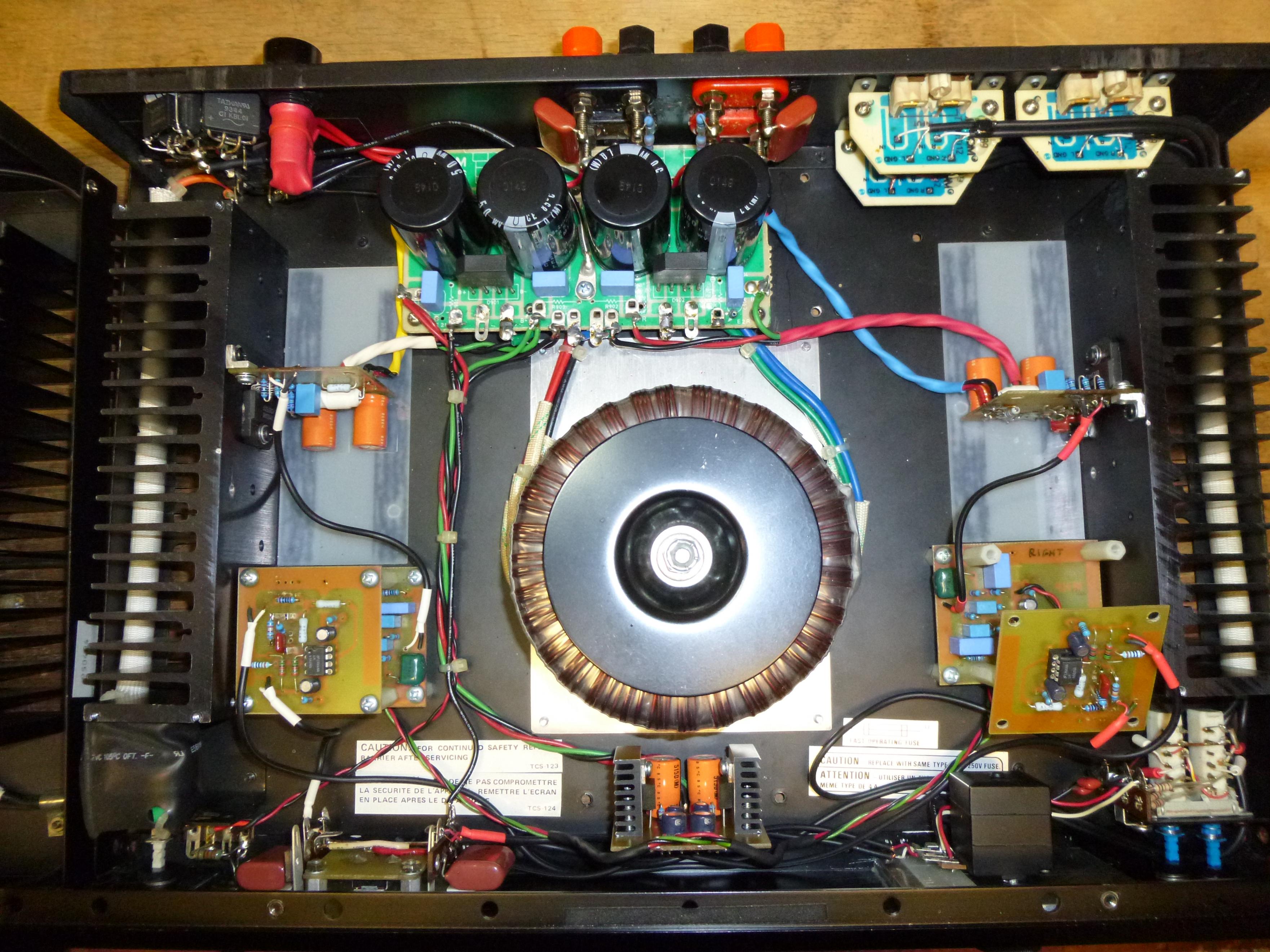

I'm laying out the chassis for a 4 channel Mod 86 in a HiFi2000 / Modushop 2U chassis (from the diyAudio shop) and have hit a small snag. The first photo shows the basic layout, very similar to what Tom did in his builds. The problem is shown in the second photo - with the 3886 sitting in the board but as yet unsoldered and pushed up tight to the heat sink, the standoffs next to the HS fall on the break in the base plate. There's no room for a screw head under the plate.
I can see a couple of solutions. I could lose the base plate and mount directly to the chassis bottom, but that would give up some strength. I could carve out the edge of the plate to make room for the screw while trying to leave enough surface for the screw to bite. Or, could a heat-conductive spacer be used between the 3886 and the HS , say a piece of 1/16" or 1/8" aluminum or copper with conductive grease on both sides? That would make life easy if it wouldn't screw up heat dissipation.
Bill
Bill, I ran into the same issue w/ a steel bracket in the Mini Dissipante. I shared my solution in #1394. Basically, I replaced the LM-side standoffs w/ right angle brackets and drill / tapped extra holes in the heatsink.
