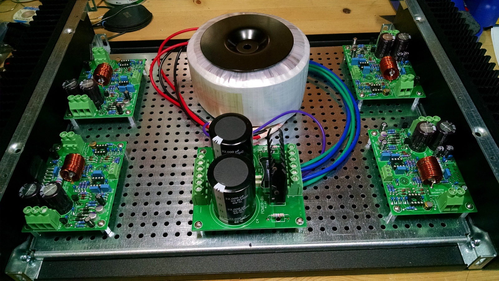

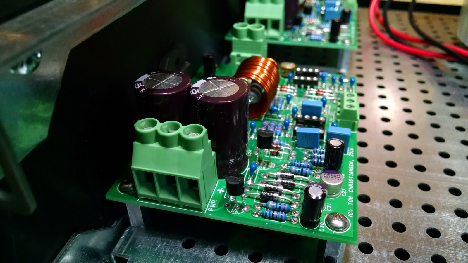

I'm laying out the chassis for a 4 channel Mod 86 in a HiFi2000 / Modushop 2U chassis (from the diyAudio shop) and have hit a small snag. The first photo shows the basic layout, very similar to what Tom did in his builds. The problem is shown in the second photo - with the 3886 sitting in the board but as yet unsoldered and pushed up tight to the heat sink, the standoffs next to the HS fall on the break in the base plate. There's no room for a screw head under the plate.
I can see a couple of solutions. I could lose the base plate and mount directly to the chassis bottom, but that would give up some strength. I could carve out the edge of the plate to make room for the screw while trying to leave enough surface for the screw to bite. Or, could a heat-conductive spacer be used between the 3886 and the HS , say a piece of 1/16" or 1/8" aluminum or copper with conductive grease on both sides? That would make life easy if it wouldn't screw up heat dissipation.
Bill

If you opt for the spacer solution, using copper for the shim with aluminum HS might create a galvanic corrosion issue long term - possibly a bad idea even though copper is a better conductor than Al.
For a first approximation, aluminum shim stock will pretty much conduct heat at the same rate as the aluminum heat sink material. There will be some small degradation from a second layer of grease. (assuming most heat compounds are less conductive than Al)
You could attach the standoffs to a piece of 1" x 1/8" aluminum bar using countersunk flat head screws from below then attach the bar to the chassis at the first row of holes.
Thanks, that might be workable. I'll have to see what I can come up with for aluminum stock.
Although not approved by all Members, in my opinion the PCB support standoffs along the heatsink side can be omitted.
The support at the middle sides stops the PCB tilting in any direction and the 11 leadouts of the chip hold the PCB at a fixed height.
That had occurred to me, but I'd rather mount the board solidly to avoid potential damage in transport. If all comes together I hope it will make it to the next Burning Amp.
Bill
Small snag aside, it looks pretty good so far.
One curious question: What's the base plate made from? Steel?
An aluminum head spreader with a light coat of thermal grease on both sides would be the way to go. I'd get a 1" wide piece of 1/8" thick flat bar. Just make sure it's smooth on both sides so you get a good thermal connection.[/QUOTE]
That'll work too.
I'm not a fan of this approach. It sets up the board as a cantilever. Any vibration will causing stress on the LM3886 pins which can lead to failure of the solder joints.
Tom
FWIW, here's my preferred mounting method.
I cut 1/2" lengths of 1/2" angle aluminum, drilled and tapped for an appropriately sized screw, and mount the board directly to the heat sink. A side benefit to doing it this way is, you can mount the chip and the board to the heat sink before soldering the chip leads to the board, thereby avoiding putting any stress on the chip leads.
Mike
