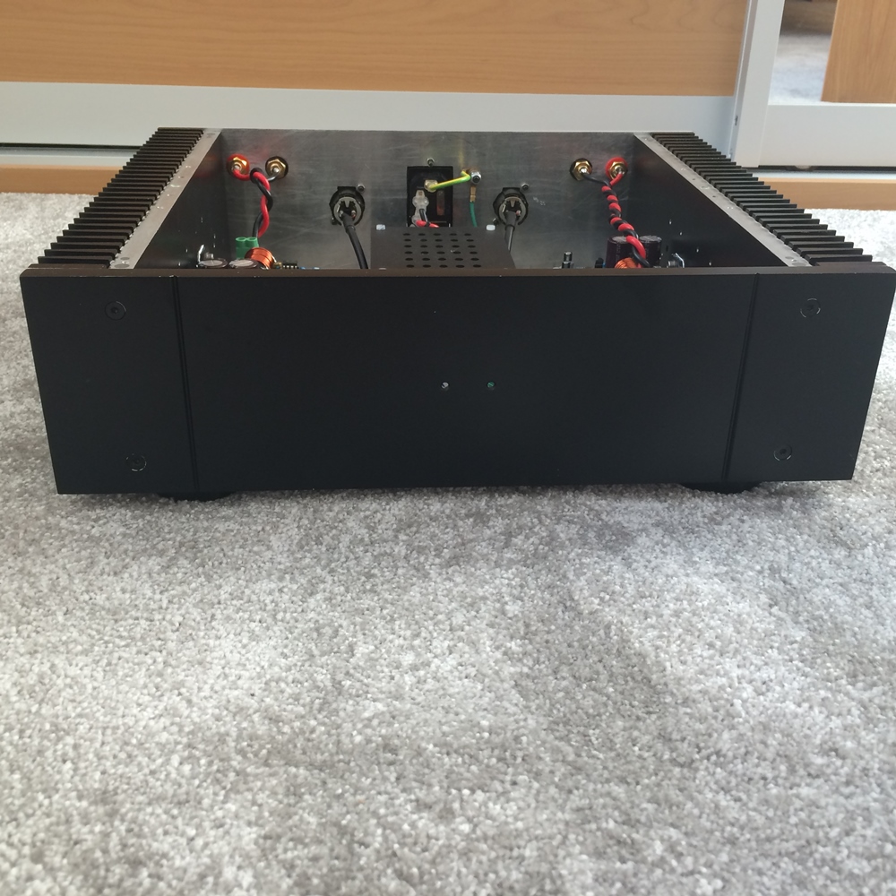

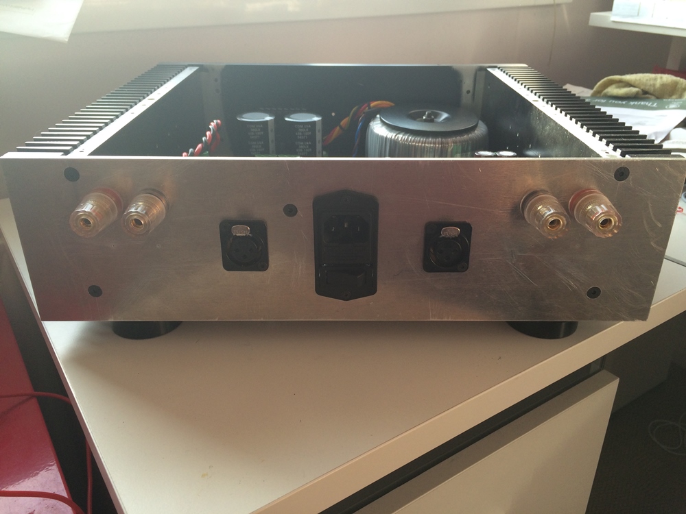

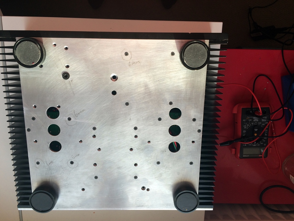

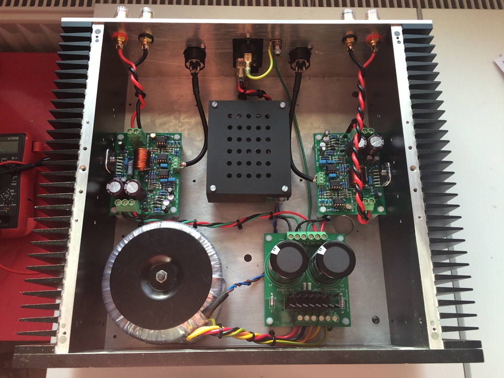

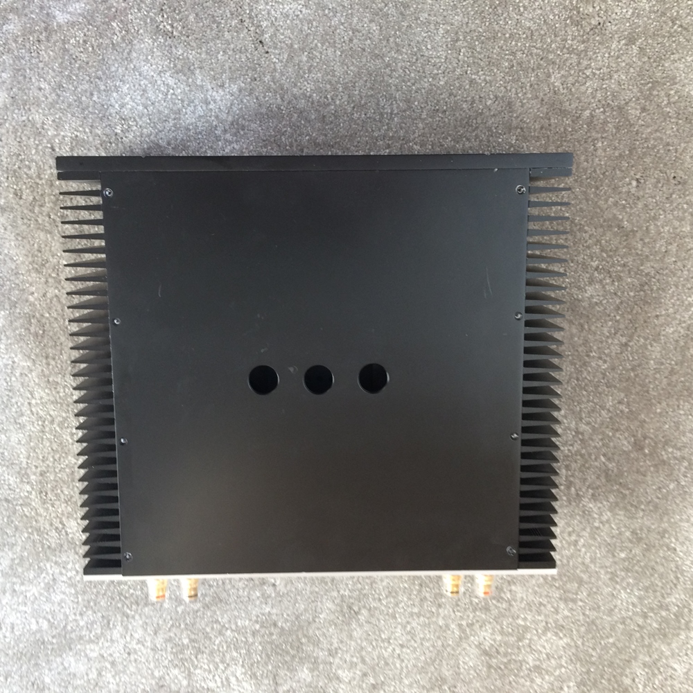

Anyway, I thought I'd post some pictures of the build, or what I'm calling the swiss cheese amp - this is the 3rd amp to be put into this homebuilt chassis, so the base has loads of holes from various layout configurations. The Modulus will be the last amp to use this.
Heatsinks are 300mm length, 40mm wide, and 100mm tall, and from Fischer Elektronik, rated at 0.4 C/W. Massive overkill for the amps for 99.9% of their lifespan, but for the 0.1% where they get really cranked up high, the sinks will at least keep the chips running.
I like these heatsinks because they have 10mm of solid aluminium at the base of the fins. This allowed them to be milled so that I could have the top and bottom panel flush with the heatsink.

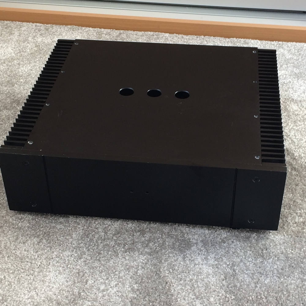

Front plate is 10mm thick aluminium, milled to have a bit of character to it. The milling cost a lot, hence why this chassis keeps getting reused. The two holes in the front were for previous LED lights, but they need filling with epoxy metal, and a single hole for an LED light drilled.

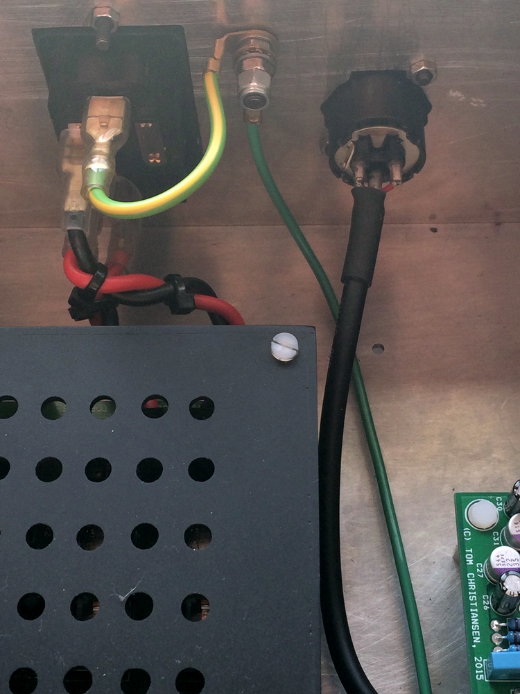

Everything is bolted together with countersunk allen bolts, all of which I drilled. All connecting faces on the metal are bare to ensure everything is electrically connected back to safety earth. Speaking of the safety earth, you can see a closer shot of how I've connected it using star washers to ensure it bites into the metal, then bolted down, followed by the ground from the power supply, which is bolted down, followed by a locking nut to secure everything. I don't think that's coming undone, and pretty sure that's what the instructions meant when describing how to connect the ground from the power supply to the chassis.
It's halfway through having the paint stripped off so I can paint it again, but that'll have to wait until the weather gets warmer.
The black rectangle in the middle of the chassis is a soft start from Per Anders, and works well. However, as everything is at mains potential, I knocked up a cover for it out of 2mm plastic card, drilled a few holes for cooling (the power resistor gets warm), and then painted black. I've always had problems with close connected fuses blowing, hence the soft start.
The feet are from a Hong Kong seller on ebay - took me a long time to find these, but they're well made (solid aluminium), and not stupid money. The bases are recessed and that allowed me to glue circles of 2mm sorbothane to them for vibration isolation/protect my oak rack from scratches.
The big holes in the bottom and top plates are for cooling - the top holes still need some fine metal mesh glued to them (on the inside), to stop dust, etc, from getting in.
It's fair to say that everything on it is over engineered, but what the heck 😀

Yes, a very smart build - I particularly like your case - it looks a bit like mine🙂
Lol - yes, it does, but cost a lot more. Bespoke engineering jobs cost (if you can actually find someone in this country who will do it - a lot of engineering companies advertising "we will do one off small jobs" never got back to my emails. I could have phoned them, but if they couldn't be bothered to reply after I chased them on email, why phone?).
I've had this case for about 3 years now, although it's a bit like Trigger's Broom, it's had a few replacement back panels in its time (but it's still the same chassis).
For those who are wondering who Trigger is, and what his broom has to do with anything, it's a character from a brilliant situation comedy called Only Fools and Horses. Trigger isn't the sharpest tool in the box, it's fair to say, and he wins an award for having the same broom after 17 years (he sweeps the streets) - except it isn't the same broom... https://www.youtube.com/watch?v=HisD_pqlRHQ
The heat sinks I use for testing are 0.4 K/W as well. Running the MOD86 at peak power dissipation into a 4 Ω load (AFAIR) got the heat sink up to 40 ºC after an hour. This in a somewhat toasty room (24-25 ºC). You'll only hit this operating condition if you excite the amp with a sine wave at half the rated output power (or I suppose music with 6 dB crest factor cranked to the onset of clipping). You'll be fine.
Also note that the 0.4 K/W you mention don't take the rest of the chassis into account. I was rather surprised by how much a few sheets of 3 mm aluminum for top/bottom/rear panels and a 10 mm aluminum front panel helped on the heat sink efficiency of the BZ4309 chassis I used.
I like it.
Yep. That's exactly what I intended for you to do.
Nice work. I like it. Thanks for sharing.
Tom
