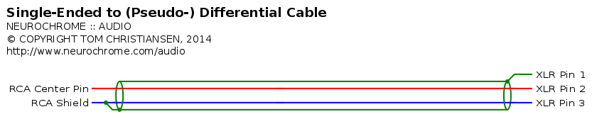

But I have not schematic of M86, can you explain : "grd" "in+" "in-" R3 and R8 ?

The input connectors connect directly to the input terminals on the MOD86 board. Pin one of the XLR goes to pin one of J2. Pin 2 to pin 2. Etc. Follow attached schematic for single-ended connections. This is described in more detail in the design documentation for the MOD86.

In this case, signal passes through the shield, for me it's not a good way..
I prefer connect shield at only one point (amp board), or use only two twisted wires (xlr pin 2 and xlr pin3). I observe a better sounding without schield, more clear and details..
Thank's.
Phil.
Pin1 goes to Chassis at the socket.
We don't want the "pin1 problem" in our amplifiers/equipment.
