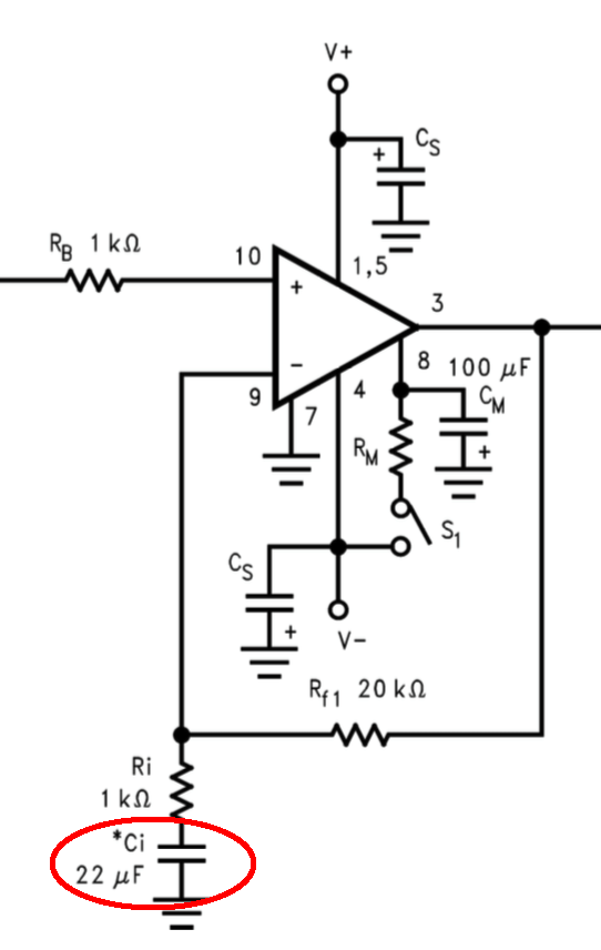

So the LM3886 has a minimum gain of 10 V/V (20 dB) for stability. Sadly, this means its input offset will be amplified by 10x. This is what leads to the 100 mV of output voltage offset and 1 A of standing current that I calculated earlier.
Increasing the feedback factor to 1 at DC by adding a capacitor to ground, such as the one circled below, will cause the LM3886 to have a gain of 1 V/V at DC, hence, lower the max. output offset to 10 mV and reduce the standing current by 10x.

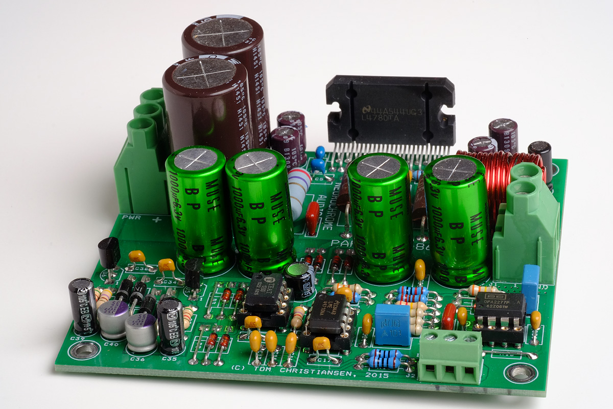

This is the exact reason why you see four bright green towering electrolytic caps on the Parallel-86 board.
Reducing the gain at DC does improve the DC offset on the output of the amp.
AC coupling the input does NOT improve the DC offset on the output of the amp. In case of two LM3886es in parallel, an input offset coming from the source would apply equally to both LM3886es. This would result in a DC voltage on the output of the amp, but would not cause a mismatch in offset voltage between the two LM3886es, hence, not cause an increase in the standing current.
