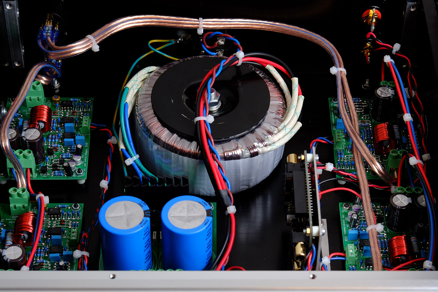

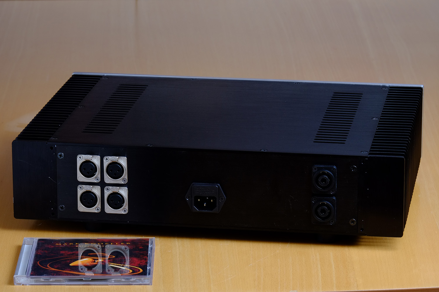

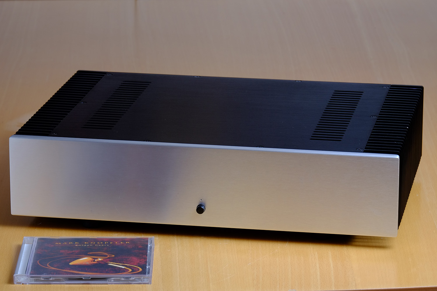

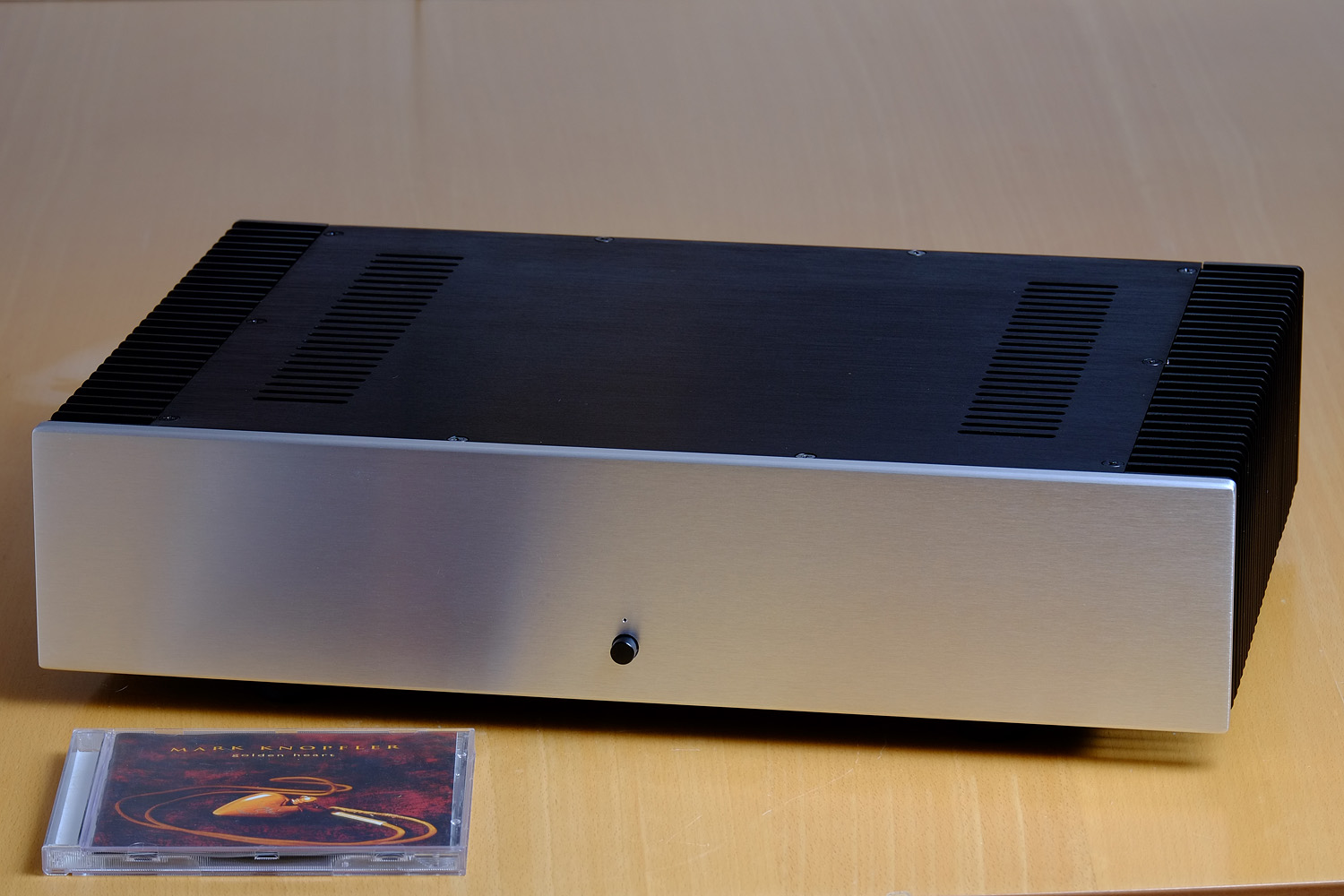

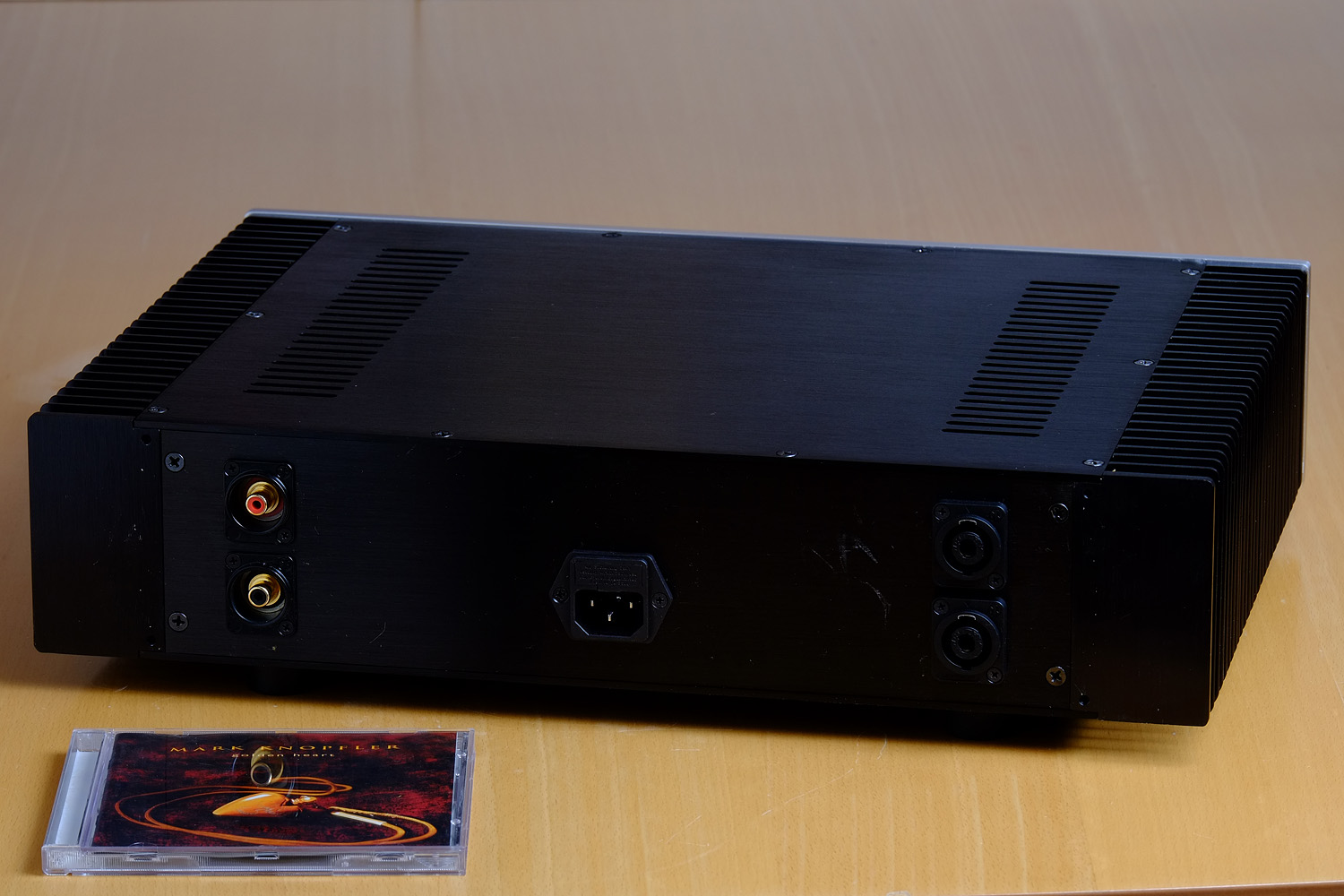

Builds complete.
Amp #1 is for a friend of mine. He'll use it with a Sonos music player, hence, the built-in MiniDSP and RCA inputs. I used an Antek AN-2222 (200 VA) for this build.
Amp #2 is for me. I'll use it with my Focusrite Saffire PRO24 sound card and a laptop running Reaper for the crossover. The Saffire has differential out (TRS), hence my amp has XLR inputs. For this amp, I used an Antek AS-3222 (300 VA) as Antek was out of stock on the 200 VA model.
To test the thermals, I ran the two amps on one side of the chassis at 20 W output power (peak power dissipation in the LM3886) for a good hour. My math says 50 W was dissipated into the heat sink. The heat sink got 15 ºC hotter than the surrounding air and ended up at 40 ºC. For normal music reproduction, the heatsink remains cool to the touch.
15/50 = 0.3 K/W. That seems really optimistic, but that's what the math says. Note that the rest of the chassis, in particular the front panel, participates in conducting the heat away, so that may explain the stellar thermal performance.
Details on where to get the chassis are found in Post #805.

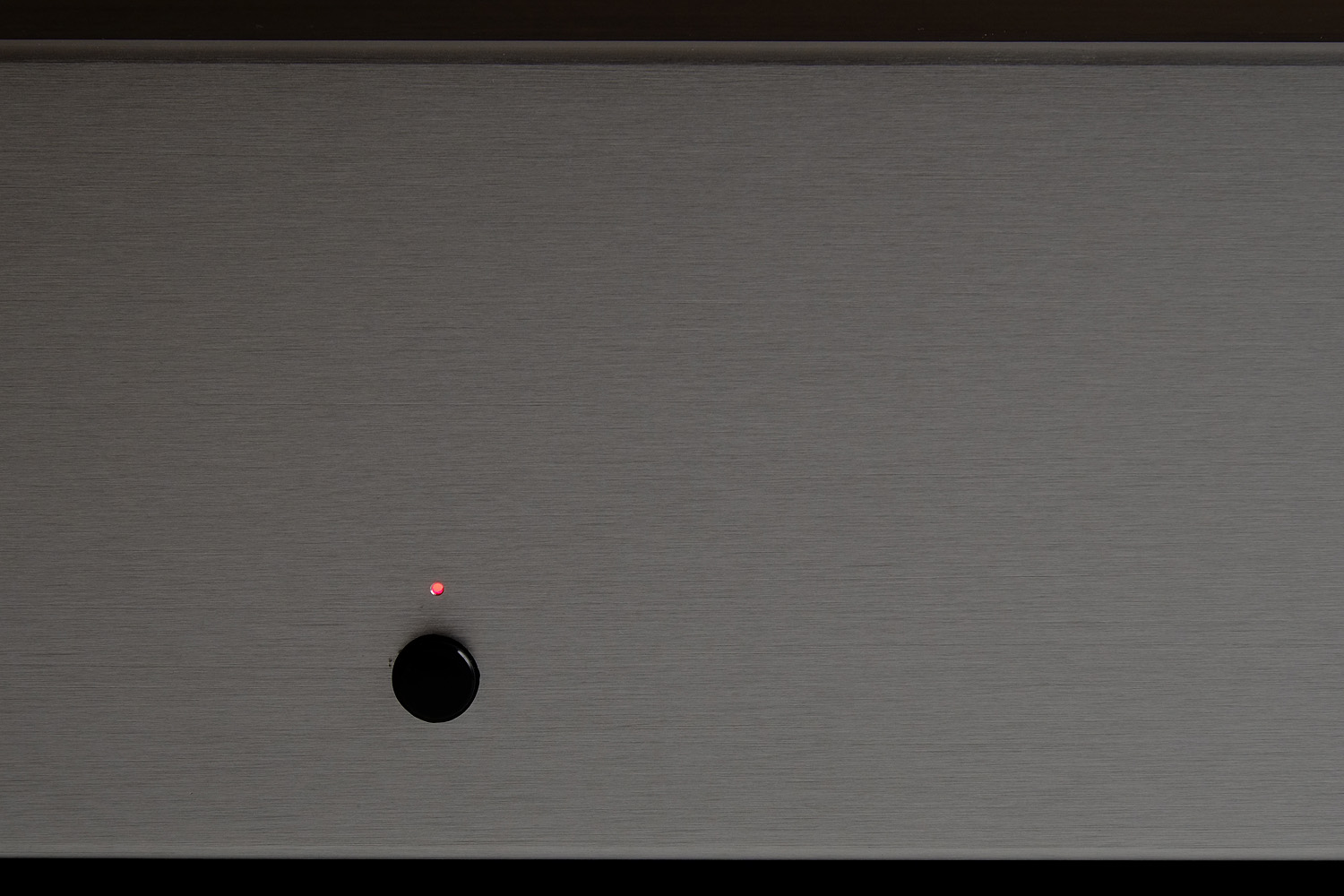

The ON indicator is an unobtrusive 1.0 mm diameter red dot. I made this using a trick I picked up from one of the guys in the Tubes forum. First a 1.0 mm hole is drilled through the front panel. Then a 5.0 mm counter bore is drilled from the inside of the front panel. The counter bore stops about 2 mm from the front face of the panel. Then an LED is glued in place using 5-minute epoxy. I use a pretty red LED (HLMP-D101). This way I end up with a nice indicator that shows the amp is on without illuminating the entire room.
