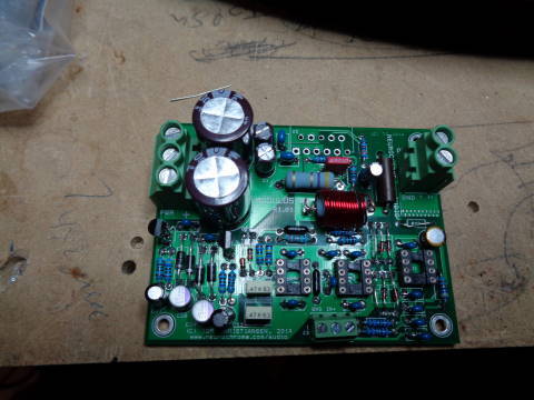

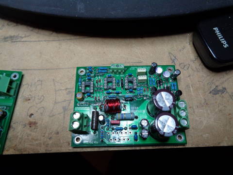

The transformer I have has 16 awg wiring, which does not fit in the PCB. Here is what I have so far. C9 has been changed to a Wima MKS2 63V part, which I see has also been obsoleted.....
So far, I am this far, missing a few connector parts for the power86. My concern whether or not the inductor on the first board ought to be cleaned up...
Thanks!

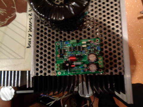

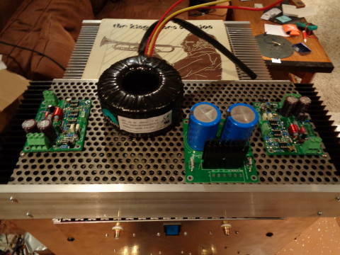

Here is the enclosure size. A bit worried about the heatsinks. They are 180 wide, 70 tall with 45mm fins.... The toroid is rated 19.5 VAC, 185 VA. Awaiting parts from Mouser -- the connectors for the power86.
The toroid uses 16awg which does not fit, else I would wire direct.
Are you sure you are trying to connect the power to the correct terminals on the PCB? The power connectors on the PCB can accept up to AWG 10..
Not on my boards they can't. The power gets connected to the holes that say AC, beside the rectifier. The other side is DC.

I see, so your order did not come with the connector as shown here?
Nope. I got stung with the Mouser "combine projects bug".
The bug has since been resolved -- mouser promises to waive shipping on the missing parts for me. No one else should have any trouble.
