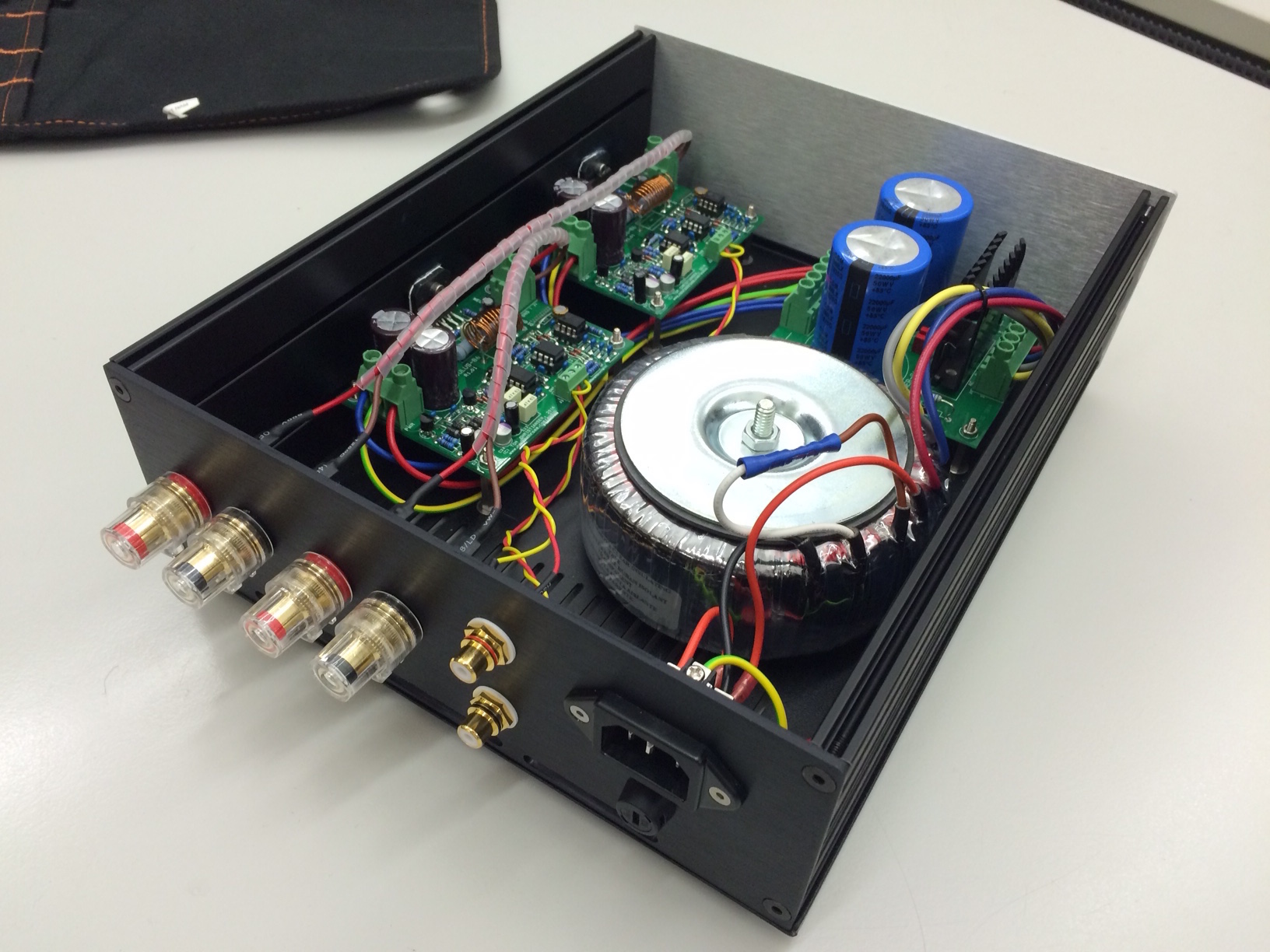

Hi guys,
I've been running my Modulus-86 amp for a couple of weeks now, and so far I'm very happy with it. When I first posted pictures of my build, a few people suspected that I didn't have enough heat sink. What I can say is that I'm not experiencing any problems. After a few hours of use at reasonably high power, the heat sink on the chassis seems to stabilise at what I'm guessing is some 40 degrees Celsius i.e. kind of lurk-warm to the touch but nothing more. I even have both chips mounted on the same side of the chassis.
The only problem I'm facing is that the fuse blows if I turn on my pre-amplifier BEFORE turning on the Mod-86. If I turn on the Mod-86 first before any signal is seen on the inputs, the fuse is fine. I'm using a 1.6A slow fuse (240V). Can anyone suggest a solution?
Soren
Hi guys,
Soren
Hi Soren,
Two options, already discussed here: uprate the fuse or build a soft start circuit.
1.6A fuse is marginal for me on 240v UK mains but they work most of the time; This suggests that a slightly larger fuse should cope better, say 2A or 2.5A. The 1A fuses all immediately died and I had to wait for an order of 1.6 fuses then ordered some 2A for good measure.
I had three 1.6A fuses blow on the initial test but strangely since the initial test day the amplifier has been turned on several times a day and I am told by my Dad (I built it for him) that it hasn't blown another one yet. Also when he turns his system on everything comes on (all system components) and it is immediately playing the Radio as it warms up.
I have supplied him with the pack of 2A fuses.
So you could uprate the fuse anyway and decide if you want to build a soft start.
