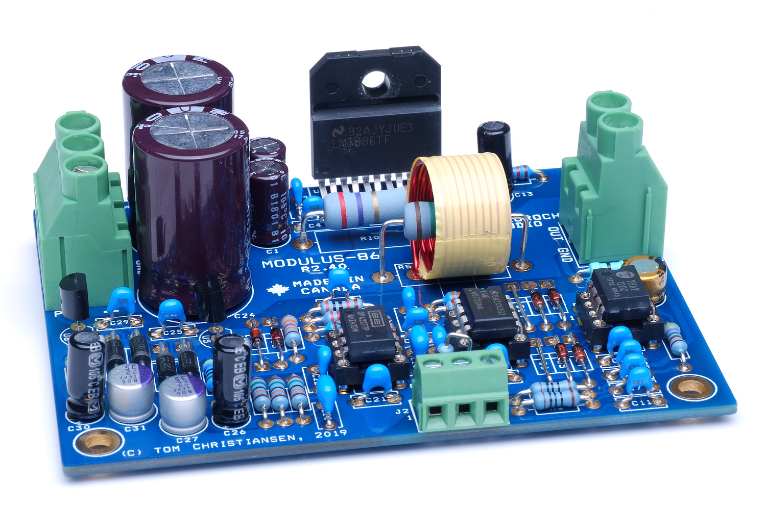

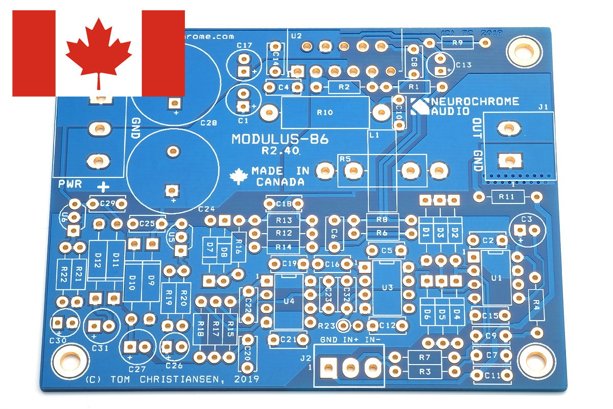

I'm happy to announce that the Modulus-86 is the latest of my circuit boards to be repatriated. Revision 2.4 is made in Canada. The Canadian made boards are also gold plated and fully electrically tested by the manufacturer. High-end manufacturing for a high-end product!
Revision 2.4 includes a couple of layout improvements in the input section. Nothing earth-shaking, but worth taking now that more boards needed to be ordered.
I have parts coming tomorrow to build a stereo pair for testing and expect to have the plots updated on my website later this week. This also means I'll have a stereo pair available for sale soon. Probably in two weeks as I like to sit on the boards for a bit to make sure I got all the measurements.

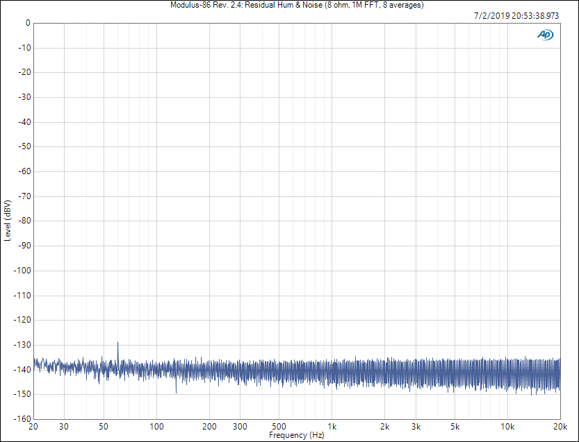

Picture Day!
The Modulus-86 Rev. 2.4 performs as well as Rev. 2.3. The THD measures a little higher as I've changed my measurement methodology (fewer points in the FFT to accommodate the slight frequency drift of the oscillator during the measurement). Still at -119 dB vs -125 dB, the difference is academic. Both are orders of magnitude below audible.
One of these days I'll get a Baxendal circuit running so I can measure THD using the AP's oscillator rather than the "Victor's Oscillator" I'm currently using.
The only major difference (improvement!) is in the residual mains hum, which was improved by ~20 dB. Again, mostly of academic interest, but still worth having.
You can find the updated specs here: Modulus-86 R2.4: Composite amp. 70W (4Ω) @ 0.0001% THD

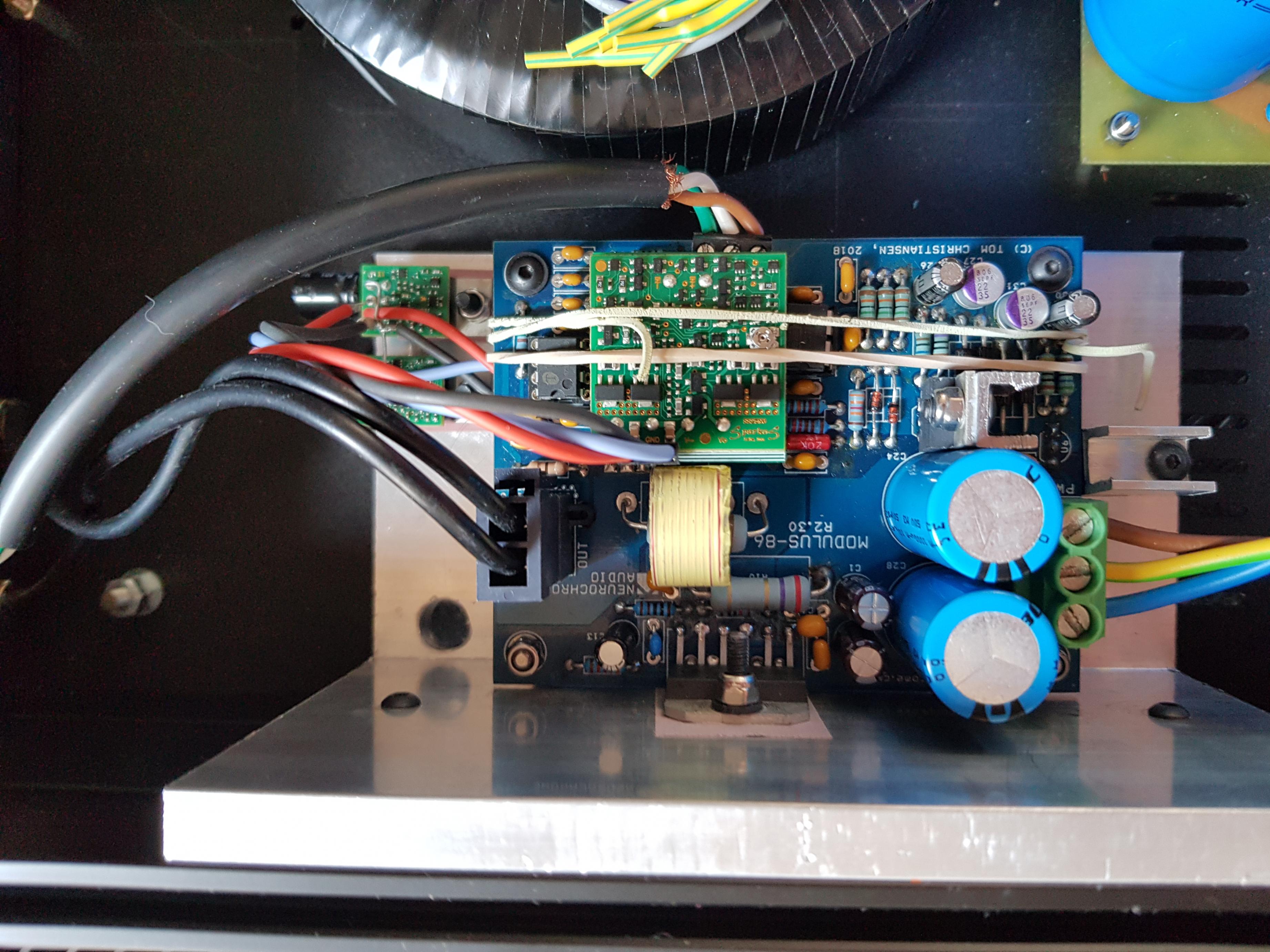

I tried the following in place of LME49720
MUSES01
MUSES02
Sparkos SS3601
Sparkos SS2590
First two are pin compatible. Last two are a single opamps, so they require pin adjustments. They also require external regulators since they are Class A and onboard regs are to weak to power them (they get to hot).
I like MUSES01 over the LME49720.
However eventually I ended up with SS2590 powerd by external +/-24V regs. To my ears I found this setup to be sonically the best. It has been running like that for months already.
