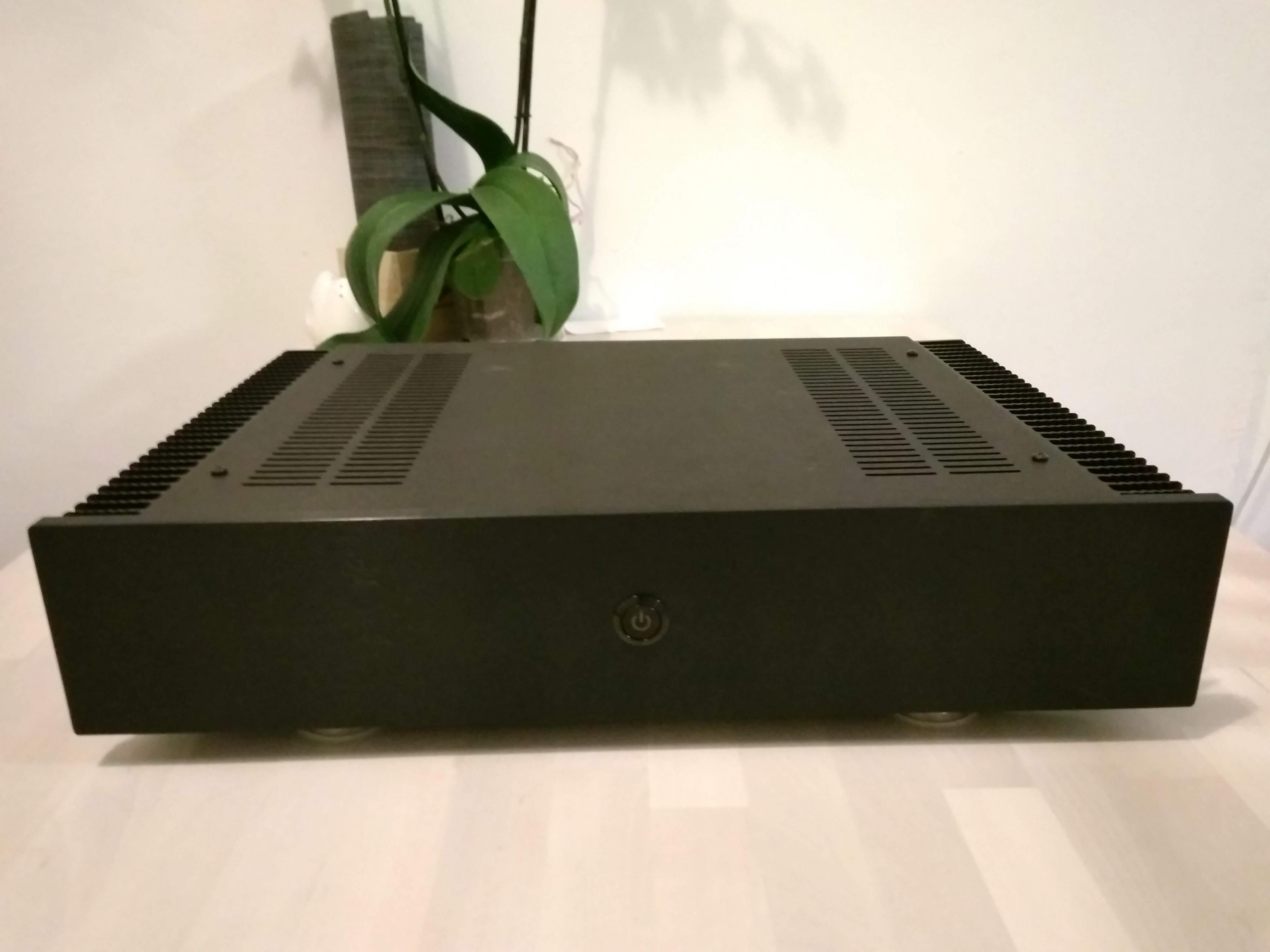

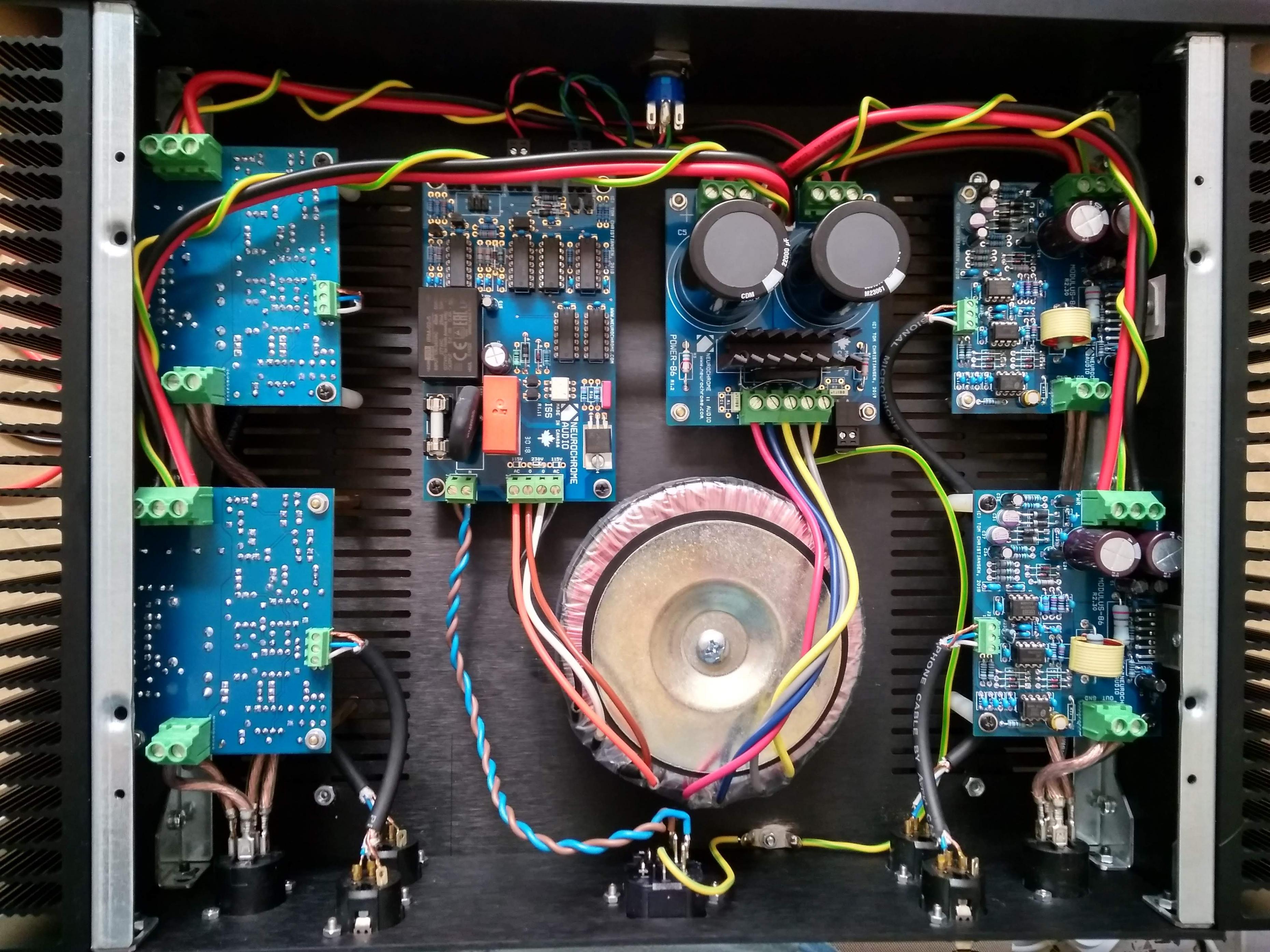

This is the first amp out of two 4-channels Mod-86 amps build. They will feed a 4-way system I'm designing. Currently it feeds a sort of 2-way speakers hand built by a sound engineer in Israel (Ariel Ran Liberman).
Initial impression is simply WOW! A couple of drivers on my current speakers were torn and I thought it impaired the whole system. With Tom's Mod-86 the speakers came back to life again. Every note and instrument stands for itself and there is no muffling at all. I never thought those speakers could sound so well.
The build was fairly easy. Tom's instructions are very well written and easy to follow. For any question Tom responds quickly via email. Couldn't ask for better support! Thanks Tom! This is my first project build (excluding O1 amp and blinking LED) and most of the struggle was with the case. I also made a some mistakes with the Mouser order that will be fixed in another time (ordered a toggle switch instead of momentary and a few others glitches).
Since it will be used for a stereo 4-way build, in the future I'll add a connection between the ISS boards to make them turn on (and maybe off too) together.
The case is Dissipante 2U from Modushop. Attached are some photos for you peepers who prefer to look at amps than listen to them

Nice build! Thanks for sharing.
That depends entirely on the impedance and efficiency of the woofer.
On the other hand, in a multi-way system, each amp handles a slice of the total frequency range, thus, only a slice of the total output power. That eases the demands on the power supply a bit. That said, I'm just as happy to sell a Power-686 instead of the Power-86.
Tom
If you are planning to use this with a 4 way speaker then you should consider a different amp for the woofer.
Your power supply is feeding 4 amps, Tom has a different ps with 4 caps , I would use one of those .
Tom
